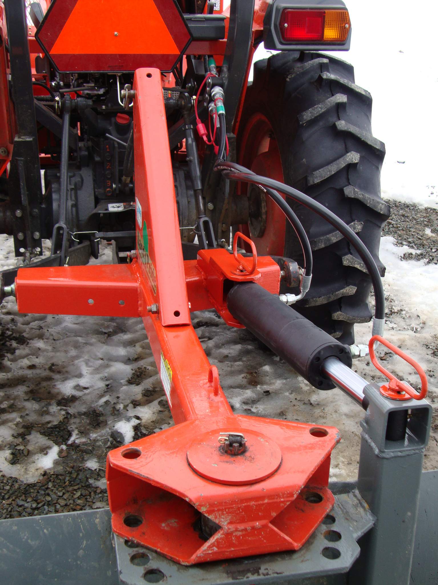

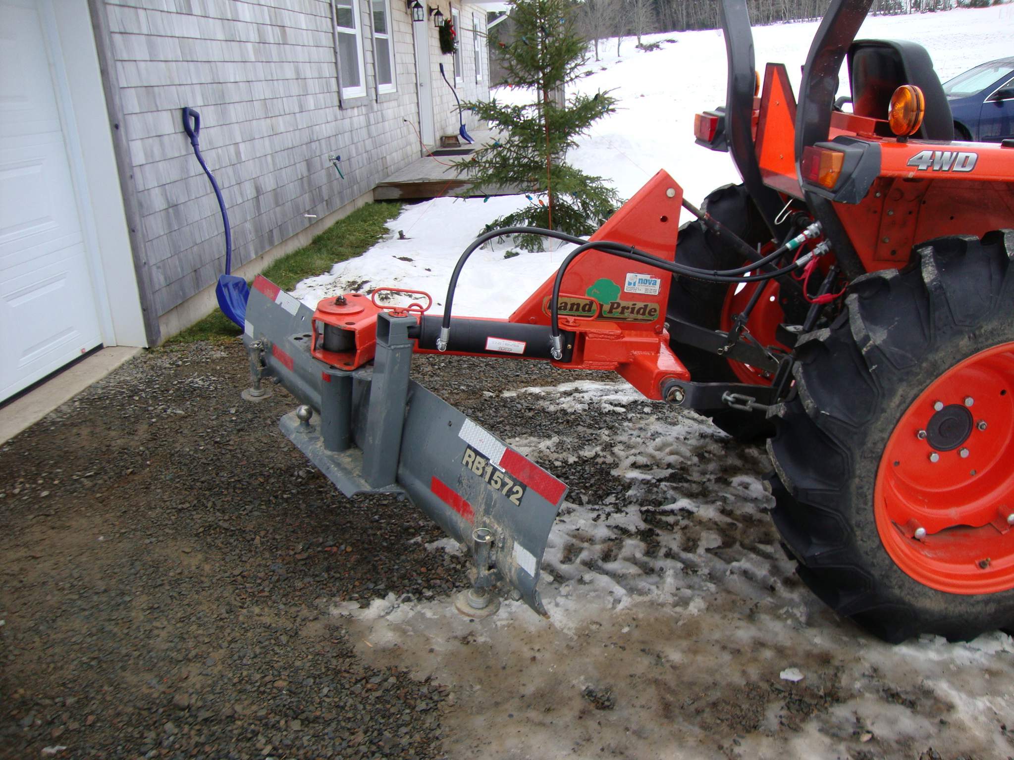

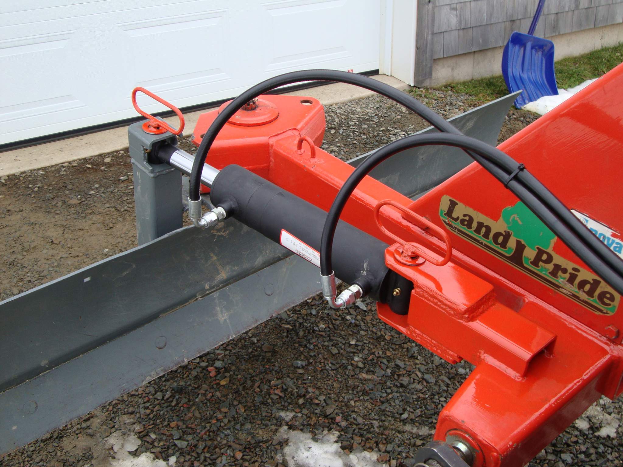

Some blades are off-setable to each side, as well as being adjustable for tilt. The quick offset feature would be nice for plowing snow, mine is a simple straight T hookup. The power angle is really nice, saves having to jump on and off the tractor to change the blade angle.

In that case, the 15 series blade may be a bit light duty for what you have in mind, although mine's doing 90% of what I need it to do with about the same size tractor. Grading a compacted driveway will be a problem unless you can rip it up first with the box blade rippers. I try to do mine first thing in the spring before the ground gets too hard.
Snow removal is what the 15 series does best, although it's up to moving loose material too. Up to about 12 inches of snow is workable, beyond that and it has a tough time handling the volume. I usually punch a hole through deep snow with the FEL, then finish with the blade. Makes a nice finished job. You may want to consider the skid shoes for the blade as well for snow removal, otherwise your gravel will migrate to the ditch until the ground freezes hard. Again, I built mine from scratch, great excuse to get out the metal-working gear and welder.
The hydraulic angle isn't a factory option until you get up to the RBT40 series of blades, the smallest one that has even a factory hydraulic offset option is the RB35.
I added a hydraulic cylinder to mine because I got fed up with getting on and off the tractor every two minutes while snow clearing. A few hours with a welder and some steel and it was done. There's a whole other thread here about that saga, in particular my discovery that my first attempt wasn't going to work so well. It makes good reading, and may save you some of the problems I encountered.
