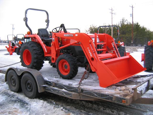

Brought her home tonight. (and lost my cell-hone for about 2 hours /forums/images/graemlins/mad.gif) 3pt is a bit "notchy" but better operating than the BX was.

   / L3400 3pt lift jerkiness or am I overloading. #23
Thats exactly how mine looked a year ago when they dropped it off, but I got the R1's. ENJOY!!

Exactly how mine looked last week - not any more - I did some moving around of the manure pile last weekend!
Is your 3pt as notchy as mine was - 1" granularity - or better than that?
   / L3400 3pt lift jerkiness or am I overloading. #25
Note the mud on the front of the trailer. It is no longer clean... /forums/images/graemlins/blush.gif
edit: I haven't put any weight on it yet, but it does seem to have 1/2 or 1/4" incriments at the lift eyes of the lower arms empty. I pick up the BB on Saturday (I think I'm gonna do the 72") and I'll tell more then.
