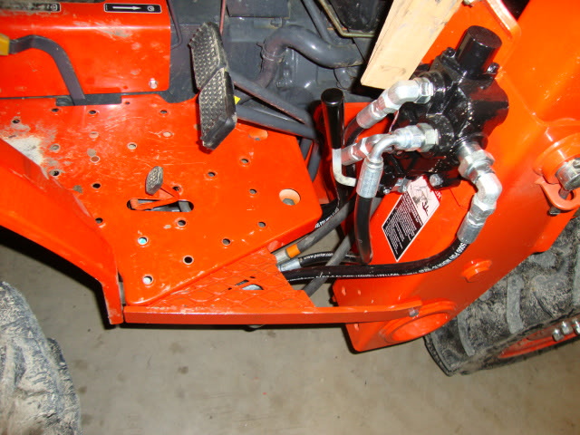

Mike I know you are more concerned with getting her home now, but some time in the future, this is a mod you may consider. I did this about a year and a half ago, and really like the extra traction, especially in the winter getting on and off with snow covered boots. Also solves the paint wearing off eventually problem. It is just do it yourself bed liner material..It has stood up well. Also wonder if you ever work any HF?

Wow. I really like that too.
I dont really have a traction issue, but get tired of repainting. Especially over the hump where my foot drags.
I may have to give that a try.

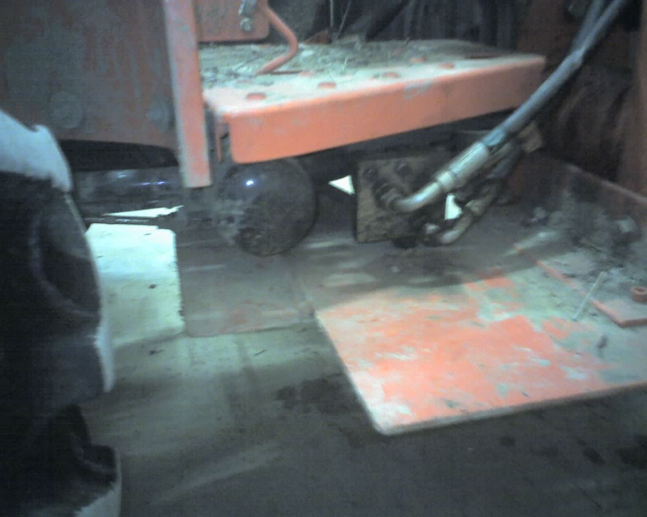

Another that you may want to consider...
Mine isnt the prettiest. I just used scraps I had laying around.
But a skid-plate to protect the hoses and filter for the hydraulics. Located under the right floor-board. They are pretty exposed and it doesnt take much to snag a hose if you work in the woods much.
Mine is also extended about 8" out from the floorboard to ad a step on that side for getting on and off. Plus I cut about 4" out of the loader joystick so I didnt snag it when getting on/off that side too. That was done shortly after this step/skid plate.

Hot Dog!!! Two good ideas I have to do now :thumbsup: Too bad the bed liner material didn't come in kubota Gray or Orange!!! ...and I've been trying to figure out how to do a step on the RIGHT ;) side and that skid plate might be the ticket! Thanks guys...

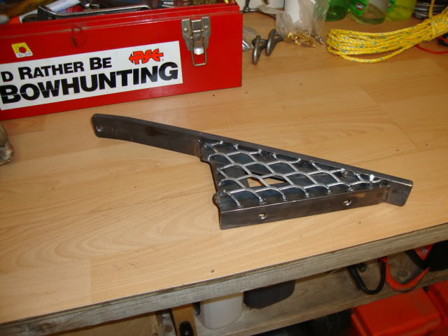

Is it just me or did you mean the RIGHT side?:)
I added a floorboard extension on the right side of mine to protect the extra hoses from the remote valve I installed, but haven't got around to doing the guard plate for the filter yet. Makes me think this sunny weekend coming up is going to be the one.
