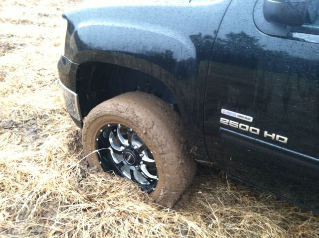

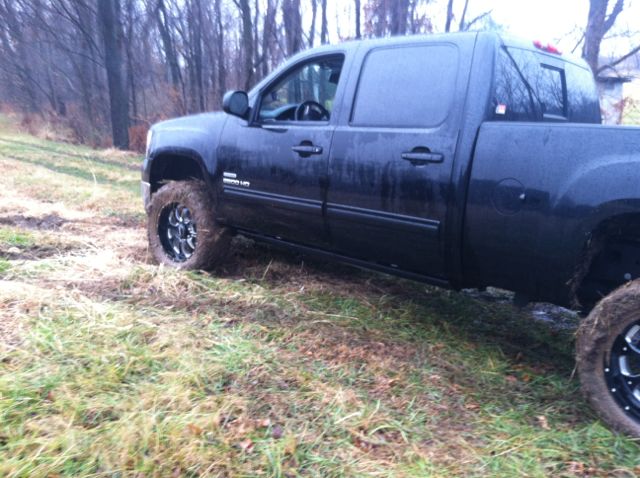

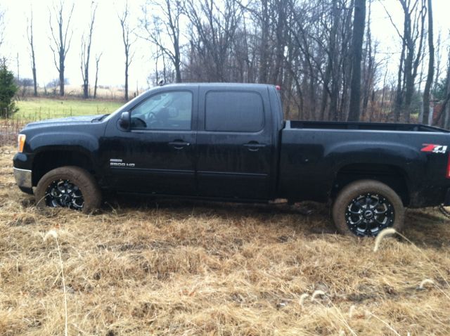

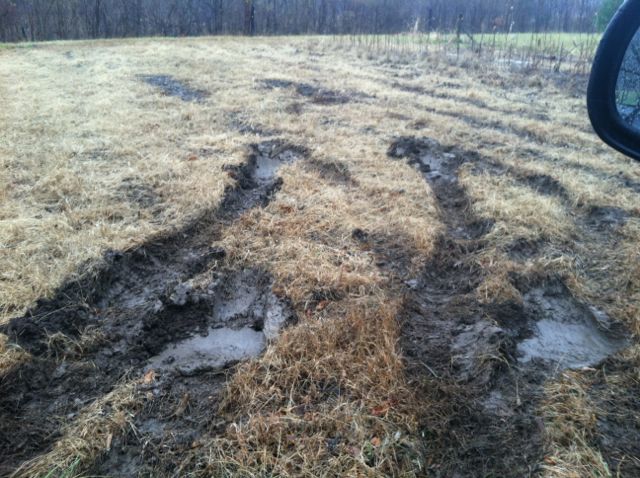

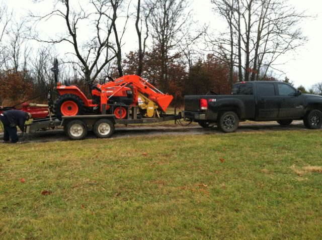

Today was quite the adventure. Took all day to get this bad boy home.
Stopped at the Bank at 9:00 to get the cashiers check and by time it was all said and done and I had all the mud off the truck it was 6pm.
I have alot to learn about this this tractor, and more importantly my new 10 acres. Today I found a soft spot and sunk the truck a foot down into the mud w/o even trying. Had to use another truck to get it unstuck. Tractor wasnt off yet so I couldnt use it.
Once it dries out a little I will go back and play with it some more. I am going to read the manual while I watch TUF on DVR. Thanks again for the great advice everyone.
Mike
