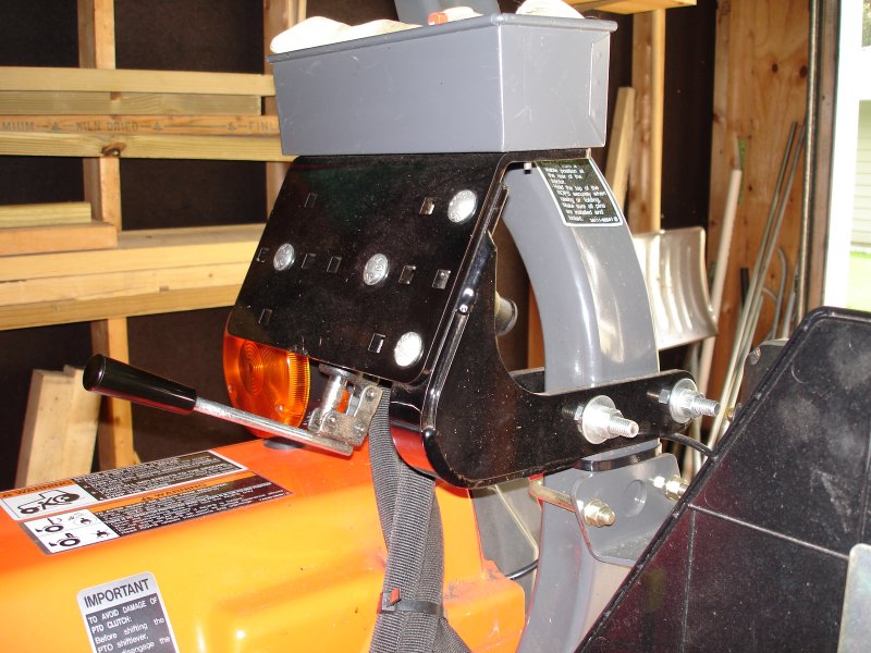

Hi Todd: Do you know if the valve kit has instructions for mounting? Is a mounting bracket included. If it does then I might well look into going with it instead of aftermarket.
Thanks for posting on this topic.
   / L3400 technical details, how do I get them? #22
Here is a few pictures of the Kubota unit. It bolts to the ROPS. I had it installed before I took delivery. The baking tin mounted on top was my addition. It holds my gloves and branch shears.
If you do your own aftermarket valve you could also bolt it to the ROPS without drilling it. You would have to fabricate some sort of plate for it.

   / L3400 technical details, how do I get them? #23
ccsial:
I always figured that your mount was custom made by your dealer.
That mount looks pretty clean. If I could purchase it separately that would save me getting someone to fabricate something and I might still be able to go with an aftermarket valve stack.

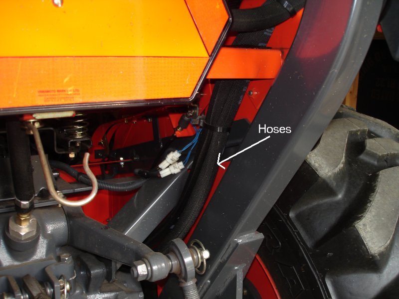

   / L3400 technical details, how do I get them? #27
ccsial:
I'm interested to know how your hoses are routed from the hyd block to the remote. It appears they go under the fender. Is this correct? As opposed to going over the fender beside the seat and the 3PT and PTO lever.
They must be secured somehow to the fender to ensure that they don't come in contact with the tire?
Sorry for the detailed questions... just figured I might as well find out what your dealer did as your setup looks nice and clean.
It is tempting to go with the factory setup as I wasn't looking forward to the extra trips to the hydraulic shop to get the right fittings / hoses / hose-lengths etc.
   / L3400 technical details, how do I get them? #28
canoetrpr:
The hoses are on the outside of the fender, then go under the fender bracket and under the floorboard to the valve. See pic. Note the retunr to tank hose at lower left of pic where filler used to be.
If your dealer can't find it I can call mine and ask for the part number. I'm sure they didn't fabricate it because they had to order it. I assume it was from Kubota.
   / L3400 technical details, how do I get them? #29
Thanks ccsial..
Remember my dealer was the one that couldn't find the part number for the toplink holder braket :). I think you helped me out with that too :)
I wondered why your return to tank wasn't hooked up on the hydraulic block. Now I know why :)
