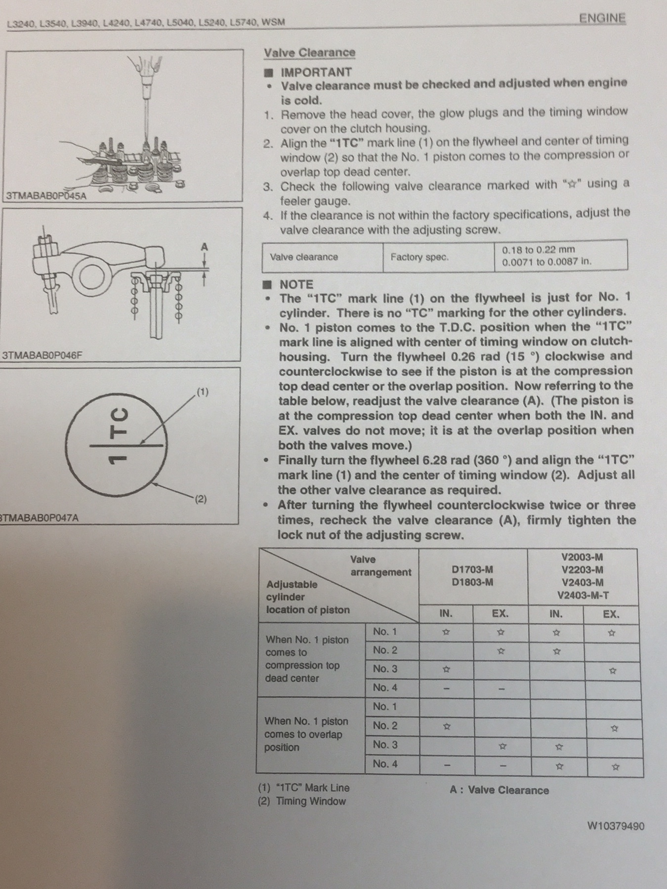

Looking for a general procedure for accessing the engine top for valve adjustment and rotating engine to timing mark on flywheel. My L35 shop manual skips all this and just shows the adjustment which is the easy part.

Per tractordata.com your L35 has the D1703 engine. Specific instructions for aligning the 1TC mark for valve adjustment on your D1703 engine are included on the attached page from my Kubota shop manual.

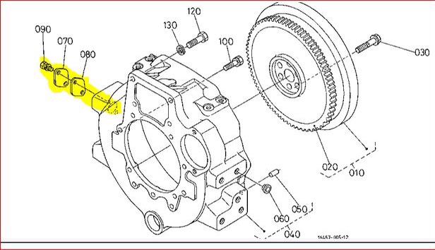

Thanks. Now if I can figure out where the flywheel inspection port is I'll be all set. I have a shop manual but it assumes way too much instead of putting in a simple graphic. It reads like the engine is sitting on a stand instead of in the tractor.

With Kubota, usually on the right side under the floor board on the front of the bellhousing. Will have a Welch plug in it.
Highlighted in yellow on right side of the bell housing. You may have to remove right side loader frame to get access.
