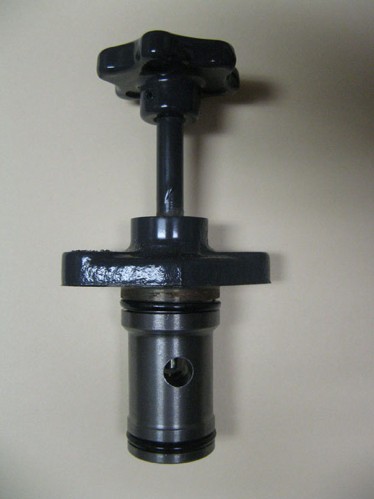

Ahh, this again... first of all mine is Grand L smooth, why? ...because (back when you could) I threw one heck of a whinny screaming ***** fit!!! Those days are gone...
Remember the guy, a little while ago, that complained about his L3400 - and he was tarred and feathered and got ran off TBN. His dealer *was* going to "fix" the jerky hitch. I suspect the same "fix" that I got would still work... and that is replacing the valve with one from a Grand L. THAT IS... if you can buy one. (now that the cat's out of the bag... "headquarters" will put a stop to that). :cool::rolleyes:

This is the first I've read of this problem and I've noticed it with my 2010 L3700 with a load on it. It wasn't a harsh action but not as smooth as my B1700. I have the draft control turned back for a slower rise and fall.
Does the draft contol affect this problem? I haven't experimented with it yet since I only recently noticed it.
Not a problem but maybe an annoyance.
When you say draft control, are you referring to the small knob under the front edge of the seat?
If so, that's a restrictor on the "lower" side of the 3ph cylinder plumbing, it has no effect on the "raise" portion of the circuit. It's meant to slow down the rate of drop on heavy implements.
