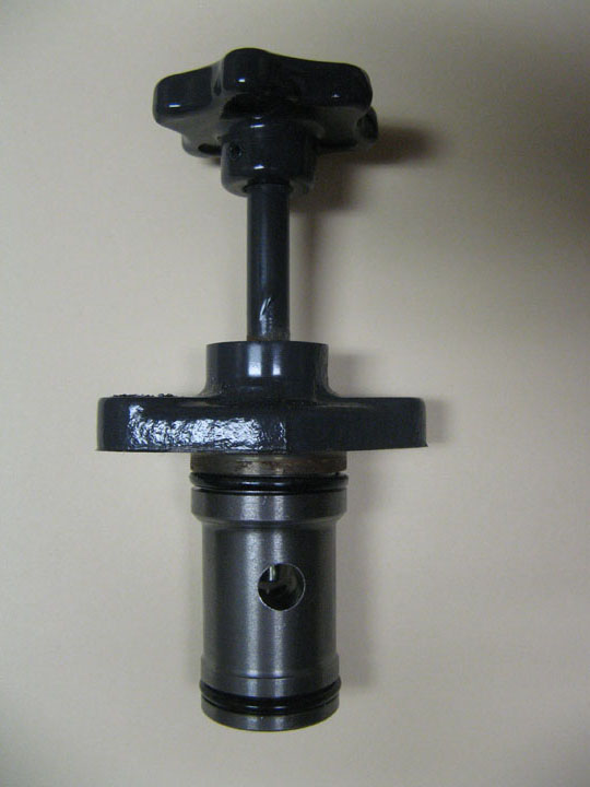

I haven't thought it through all the way but for a while now I've been considering a way to reduce the port size in the lowering speed valve (LSV) to reduce the flow and dampen the surge thought to be responsible for the jerkiness. I'm pretty sure restricting the flow would produce a slower lift and a smoother lift - possibly straining the relief valve some - but I'm not sure how to size the port/s in the LSV. The flow is restricted on lowing by the adjustable check effect so by restricting the flow in, the faster lowering speeds would be restricted as well.
In the photo, the port/s I'm referring to are the hole on the side and one matching it on the other side. They appear to be where the fluid enters and leaves the chamber to pass through the check function of the valve.
After test swapping out the LSV on my L3400 with the LSV from the L3010 with minimal to no improvement, the only still notable difference between the two (that have many of the same components but none of the complaints) is that the cylinder is larger and takes longer to fill. Slowing the flow, should have the same effect.
If I remember correctly, there really isn't an easier way to access the line after the position control valve (PSV.) It would probably be a trip to the machine shop with the LSV and some decent engineering specs. Just need have the holes reduced in size in some practical way. Bit of a gamble without more knowledge.
Canoetrpr had a nice theory on restricting flow with an adjustable valve prior to the PSV in an earlier thread that is still worth testing for the determined.

I'm not sure if you can restrict the flow in front of the PSV valve without causing the circuit to go over the relief valve all the time, which is why I was looking at tinkering with the lowering valve.
I think the hydraulic circuit on an open center system needs free flow through all the valves unless one of them is being actuated to perform work. By fiddling with the lowering valve, you're tapping into one of the work ports (the only one actually) on the PSV valve.
The power beyond function shouldn't be an issue because the 3 point valve doesn't have that capability since it's the last valve in the series circuit.
I think I'll re-read the thread you started, HM, and the experiment with the 3010 lowering valve. I'd like to have a spare one to modify and try, but the budget's a little tight to be modifying something that's still under warranty..:)
I'd be ok with the valve being slow to raise if it was smooth, but thinking about it now, I wonder if it would be too slow lowering if I had it restricted enough to be smooth on the way up?? The hydraulic pressure is a lot stronger than the weight of most implements.
Your solution with reducing the hole size might be the answer. It needs to be adjustable in the down direction depending on implement type and weight, going up isn't so bad as long as it's smooth.
More thought on this is definitely in order.
Sean
