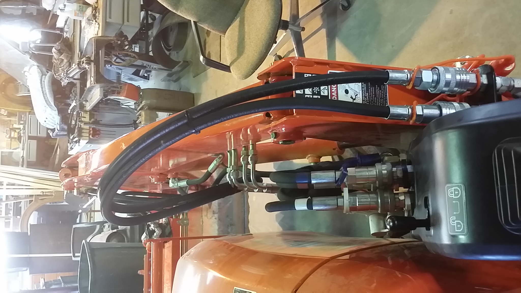

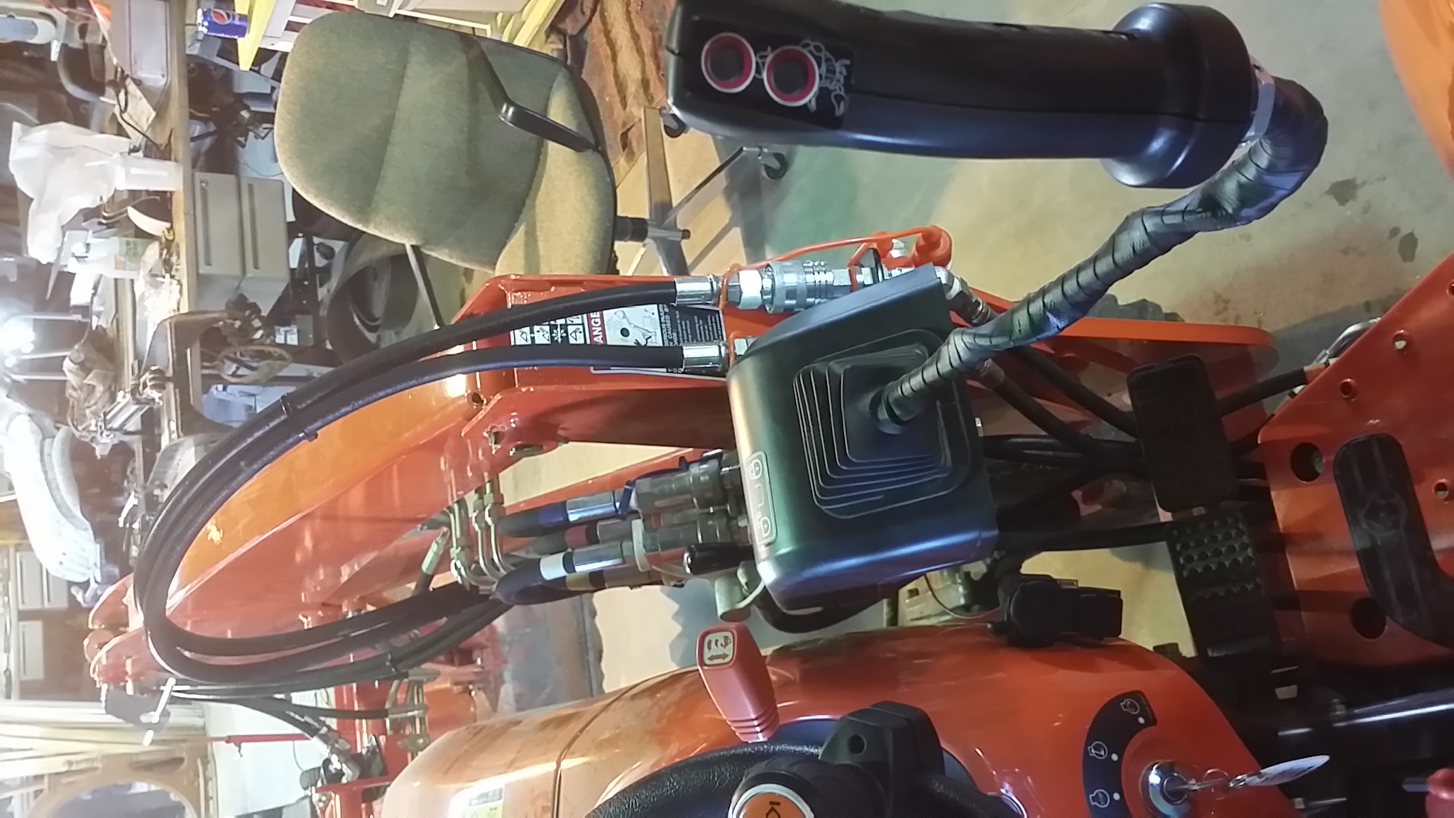

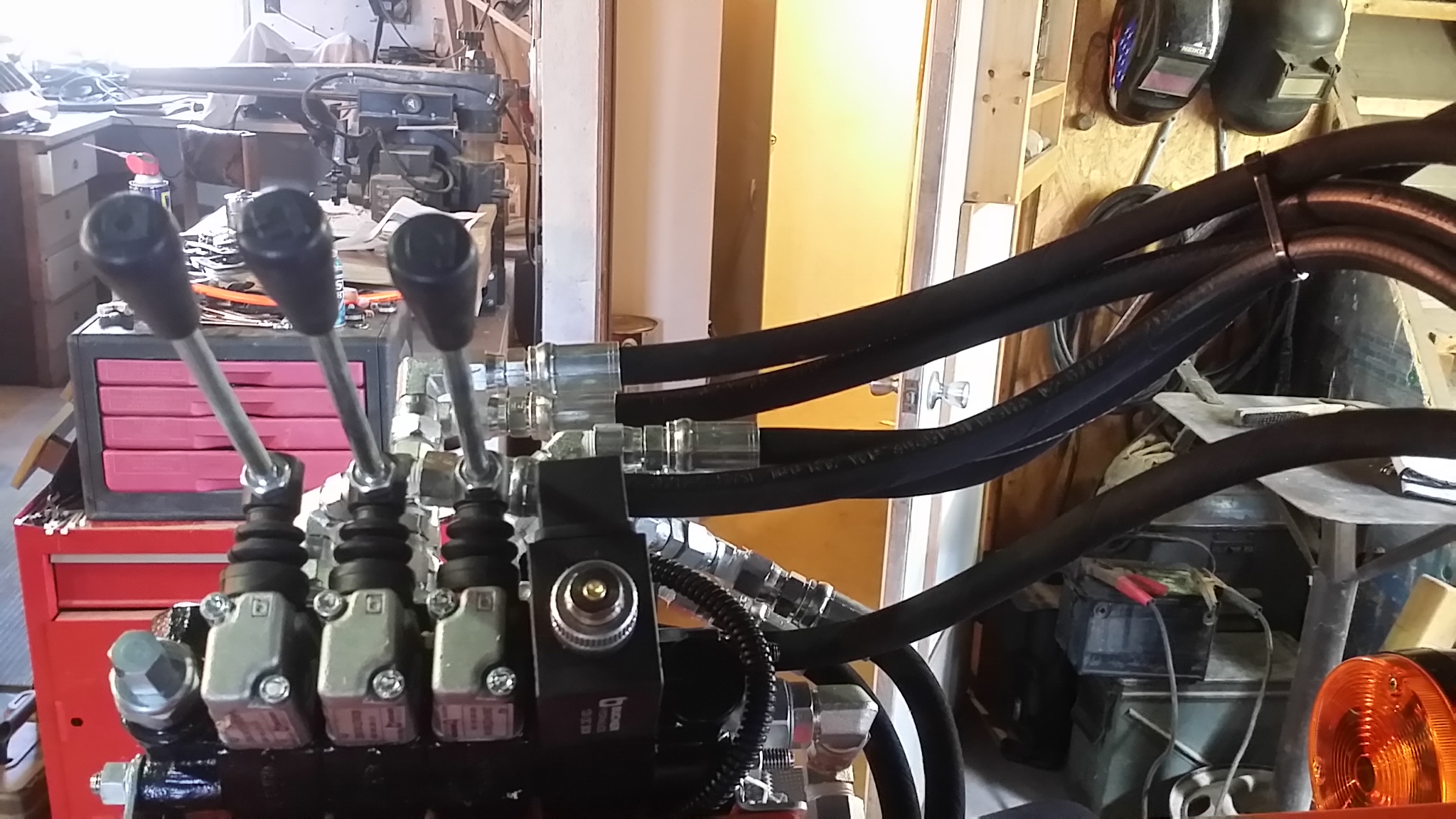

I hear you, my current setup isn't ideal, but is way better than it use to be. Imagine crowding that with a quick hitch now. :p
   / L3800 HST Rear Remote Hydraulics #22
Crowded with a quick hitch? Na, it's not that bad..... Just added the hyd toplink yesterday. Even with all this, I still have room for my 6' 2" and 245 lbs self in there running the backhoe

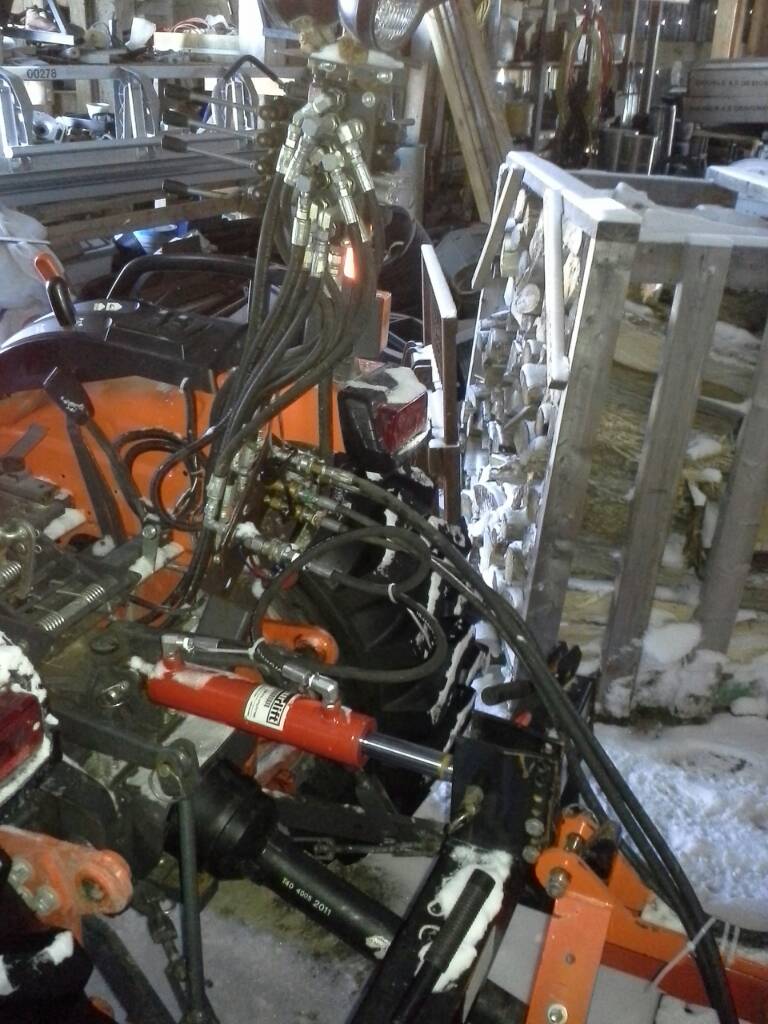

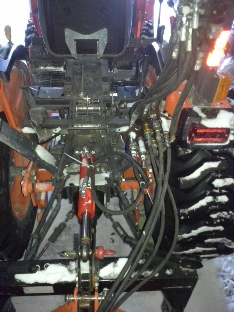

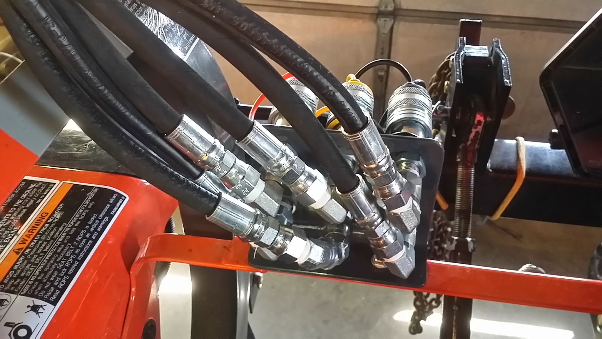

20150328_152950.jpg20150328_153007.jpg20150328_153021.jpg20150328_153038.jpg20150328_153052.jpg
Thanks to Brian at fitrighthydraulics
I could not live without it, it really made a tractor out of it.
