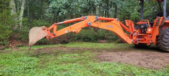

I recently acquired a new to me Kubota L39 with about 600 hours. Its been fantastic learning the machine and using it at the house for some work on the drive, leveling some spots etc. Earlier this week I garnered up enough ambition to go through the exercises of removing the loader bucket (4 in1) and backhoe so I can familiarize myself with the process. The loader was no issue (I've spent some hours with a skid before) and the backhoe came off easily enough. However when I tried to reattach the backhoe I could not lift the unit to pivot in the pins with the boom cylinder it would push an inch or so and give up. There was no apparent strain on the engine and no change in sound from the backhoe or pump. The dipperstick could tilt the hoe without issue but not enough to align the pins (the dipperstick would push the boom cylinder back in if it was extended). Needless to say it was painful to get the hoe back on an involved a pump jack, some cinderblocks, lots of fiddling with the bucket and dipperstick controls, and a fair amount of cursing.
I have the backhoe a decent workout after reattaching it and the boom controls seem to operate fine lowering and raising the boom; no signs of slowness or hesitation. I dug a small trench and used the boom to try and push on some dead trees (~3-4"), the boom is definitely weak. I read through any related posts I could find here and in other forums, but I cant seem to find anyone who has had a similar issue. Things I have checked -
  • Looked for any leaks or disconnected hoses
  • Extended boom, dipperstick, and bucket fully, suspended ~6" inches above the ground for 15 mins with no drop at all
  • Went through procedure to eliminate any air in the system
I am fairly handy and while hydraulics are somewhat new to me I do understand the basics. Any help from the members here would be greatly appreciated. I'm not afraid to involve my local dealer, but they are slow, expensive, and I want to learn how to troubleshoot and maintain this machine myself when possible.
Many Thanks,
-Bill B

Nothing appears to the eye to be bent, and the cylinder does operate, its just not very strong. I pushed on a 3" dead maple (very dead) with the boom and it would extend and offer maybe a couple hundreds pounds of force and then give up. The dipperstick had no issue pushing the same rotten tree over.

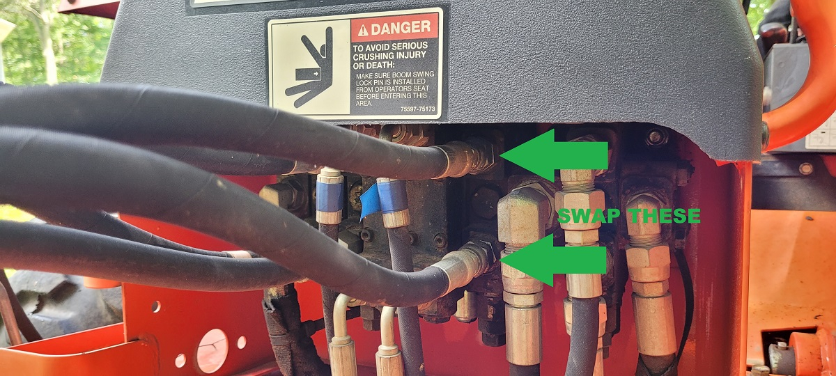

Sorry for the delayed reply. Too many active projects and life gets in the way. I am thinking I need to swap these hoses to reverse the boom operation on a BT1000... How much of a mess will this make? The BH doesn't have QC fittings, is there anything specific I should know before I move the hoses - How tight do these fittings get torqued?
This should not make much of a mess. Start by releasing the line pressure by moving your valves back and forth till all movement of your boom stops. Catch any drips with whatever you have handy. From the picture you provide the biggest issue I can see is access. Looks tight in there. You might consider switching the hoses on the cylinder instead. As for torque specs, take careful note how tight they are coming off. For testing, fully torqued may not matter much. Once you are done the test and returning everything to the way it was, the most important consideration is leaks. Good luck!
