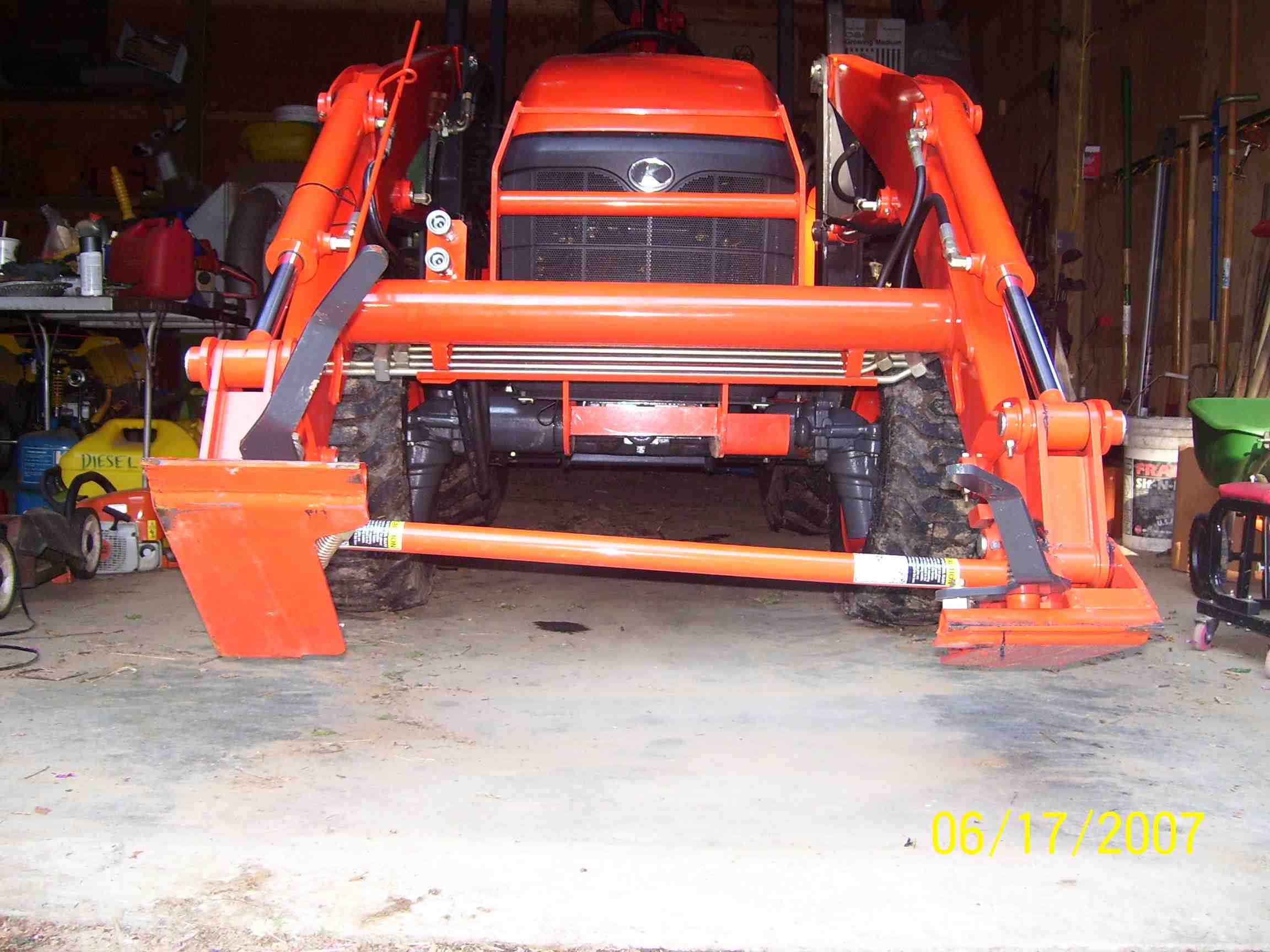

Well - I was hoping to post pics of the new L39 which arrived today. Unfortunately the pics are of a problem. Seems pretty bad to me but maybe someone here knows something I don't. I put the grapple on and things were working well (got some nice pics) then one side popped off. The problem isn't the grapple but the loader arms. See Pics. One is extended more than the other. Not sure if it's twisted or what. Looks like it to me. Look like if Icould extend one side it might line up again. Didn't want to do to much after but had to get the grapple off a both arms appear tobe working in sync but the one is extended more than the other. Any ideas??

when the grapple poped off you twisted the quick coupler plate it looks like there is just a round tube between the half's if you can get the grapple or bucket hooked back up and the plate straightened every thing should be alright the cylinders will line up when you have the plate straight

A good body shop with a frame machine should be able to fix it IF you did not bend anything

I would remove the Q attach assembly and confirm that the loader arms are still straight. If the loader arms are still straight I would call the dealer and obtain the cost of replacing the Q attach assembly. Attempting to straighten the Q attach would cost about as much as a new assembly. Assuming of course that you pushed the locking levers down before using the grapple, I would check the bottom plate on the grapple after re-installing to insure the Q attach locking lever is engaging at least one inch or more in the bottom plate when pushed down into the locked position. If not, add a 1/2 metal plate to the top on the bottom slot where the Q attach locking lever engages the locking hole.

I had already sent pictures to the dealer before Mike's reply. I had the grapple on and then had just switched back to the loader bucket when the side popped off. Not sure if the grapple had anything to do with it or not. Well see what he thinks. They are pretty good guys. He's sending up a mechanic with a new quick attach assembly. He should be here any minute. Will let you know how it goes.

Well - She's all fixed up and ready to go. Only took about 15 minutes for him to swap it out with a new one. Took longer to change the stabilizer pads - factory had put them on backwards - I just noticed it when the mechanic was here doing the swap. Luckily they had another L39 on the lot and took it off to put on mine. The dealer and mechanic are good guys. Said he just wanted to make it right. I guess I made the right choice as far as dealers go. He's a good 1 1/2 hrs away. Have 4 or 5 Kubota dealers closer but none had an L39 on there lot so I took a trip to check it out and got a real good feeling for the dealer. Don't have anything against the local ones but the one I went with just seemed like sincere hard working folks. Now I get to go see what other trouble I can get into. I'm relieved - for now anyway. Haven't had much seat time yet. Hope it doesn't happen again. Still not sure how it happened. I think it may of been installed inproperly at the factory. The new one seems to seat alot better into the loader bucket and the grapple. Haven't seen many dealers specifically mentioned here on TBN. Hope its OK to give them a big thumbs up for taking care of me the way they did. I purchase mine from Lashley Tractor Sales. Pretty good people.

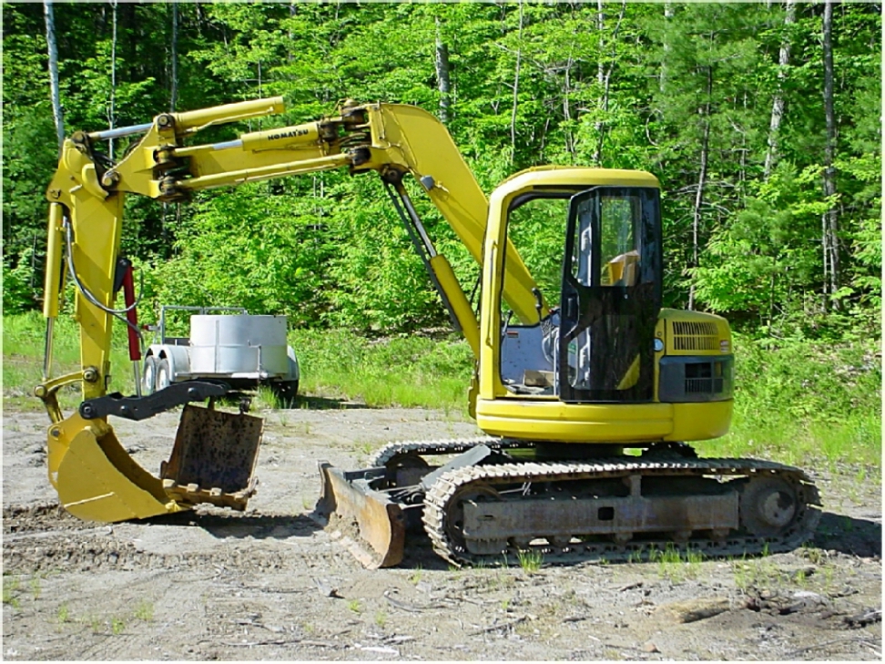

Tomorrow I see if what the on site repair mechanic for my excavator said is true and see how well she runs. The L39 will hopefully get quite a few large rocks loaded into its bucket to be moved to one of the out of the way rock piles.
I was told the PC75 now runs like a new one. (Sure!) But if it runs ok, I'll be a happy camper.
