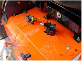

Here are some Photo Posts of what I did to bypass the Seat kill Switch. I can Defeat the switch or not. My default choice is to not defeat the switch.

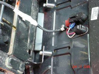

   / L39 Seat Kill Switch Opinions #30
This little toggle catch takes care of the BH defeat switch on the seat. I use first gear and move real sow, ( most of the time remembering ) that the stabilizers and bucket are down!
