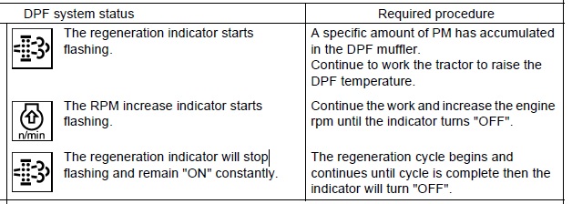

When the rpms light goes out the regen light will keep flashing until the regen is done. It may take 15 mins or so then it should go out. When it gets close to being done you will hear the engine change sound and then the light will go out. All RPM light does is let you know if you are at the correct RPM's
This is wrong, here is what the OM has:
attachment.php
I have had mine start flashing again if I was working it hard and then stop. Raise the RPMs and it will stop flashing and complete.
