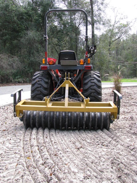

How do you like that 3 point cultipacker?
A 3-Pt. mounted Cultipacker is as maneuverable as the tractor. Cultipacker makes a short, compact counterbalance to the FEL.
When 3-Pt. mounted, a significant part of the Cultipacker's weight is transferred to the front and rear wheels of the tractor, decreasing Cultipacker weight bearing directly on the ground and seeds.
A towed Cultipacker is more efficient at packing and flattening, because 100% of the Cultipacker weight bears on the ground and seeds. However, a towed Cultipacker is difficult/impossible to maneuver in food plot work.
/ L3901 ? #24
That is kind of what I thought but was not sure. Thanks for the info

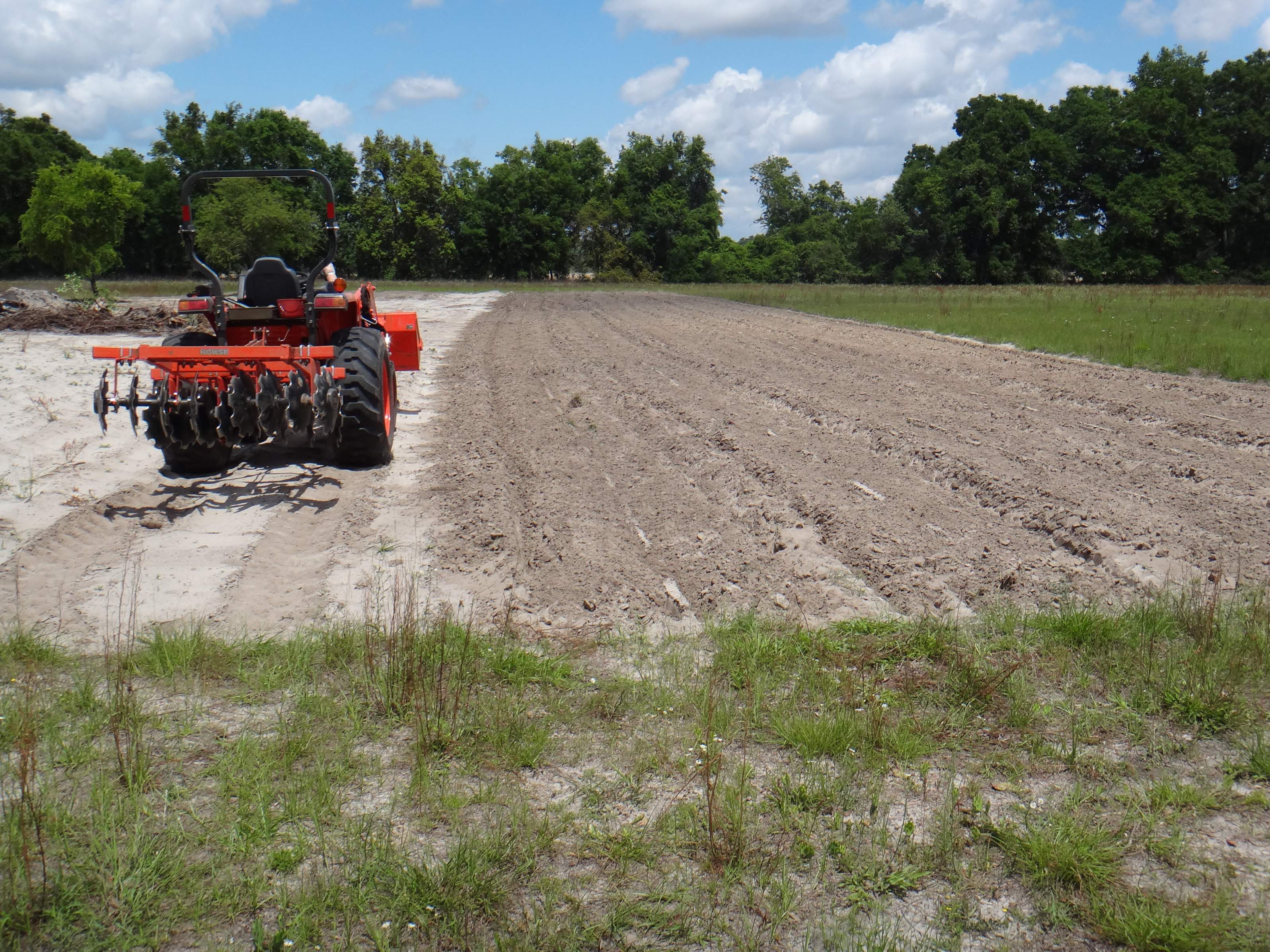

My everything attachments disks are at 46# per FWIW.
/ L3901 ? #34
But only 7-1/2" spacing between pans. Great for smoothing a field after it has been plowed.
Will not cut food plots very well. Space between pans gets shut down before pan angles can be adjusted aggressively.

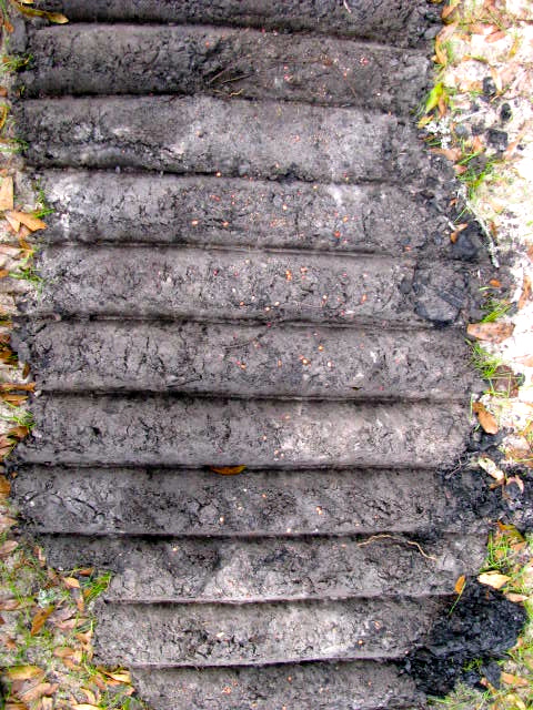

/ L3901 ? #35
Will not cut food plots very well. Space between pans gets shut down before angles can be adjusted aggressively.
Depends on the soil. This was previously planted pine that had been logged four years prior. Lots of blackberry/grass/shrubs/knee high pines. Dug stumps with the BH and this is after two passes with the disks. Did have to grapple some root systems but other than that it was all the disks.
