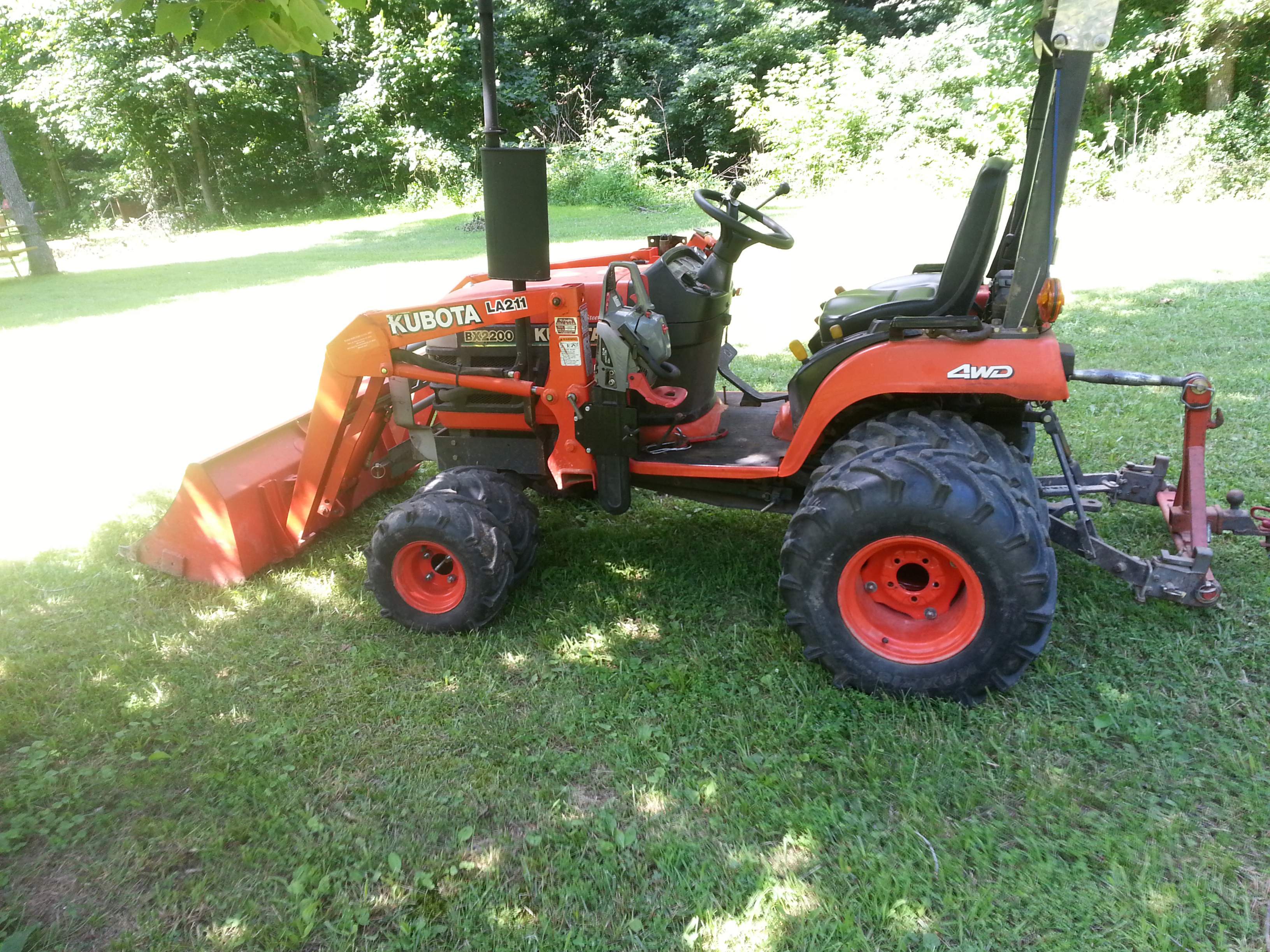

I put a vertical exhaust on my BX2200 and used an IH Cub muffler, way too loud so finally found a muffler for "97 Honda Civic that is small and quiet. 1.5" in and out so might be too small for yours.
   / L3940 HSTC #46
<img src="http://www.tractorbynet.com/forums/attachment.php?attachmentid=352622"/> I put a vertical exhaust on my BX2200 and used an IH Cub muffler, way too loud so finally found a muffler for "97 Honda Civic that is small and quiet. 1.5" in and out so might be too small for yours.
Very cool BX. Never seen front and rear dual on a scut, are they for stability or low ground compaction?
