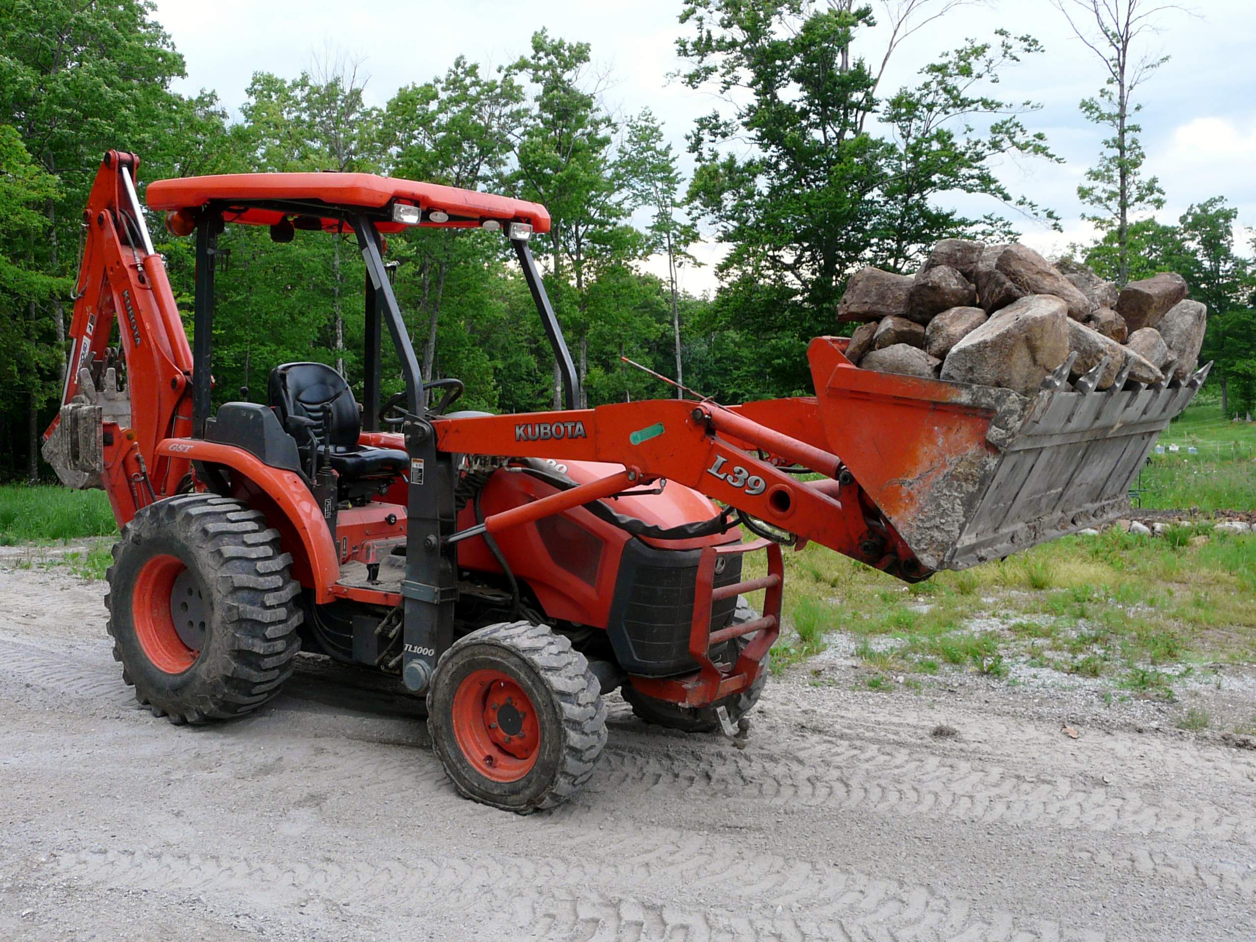

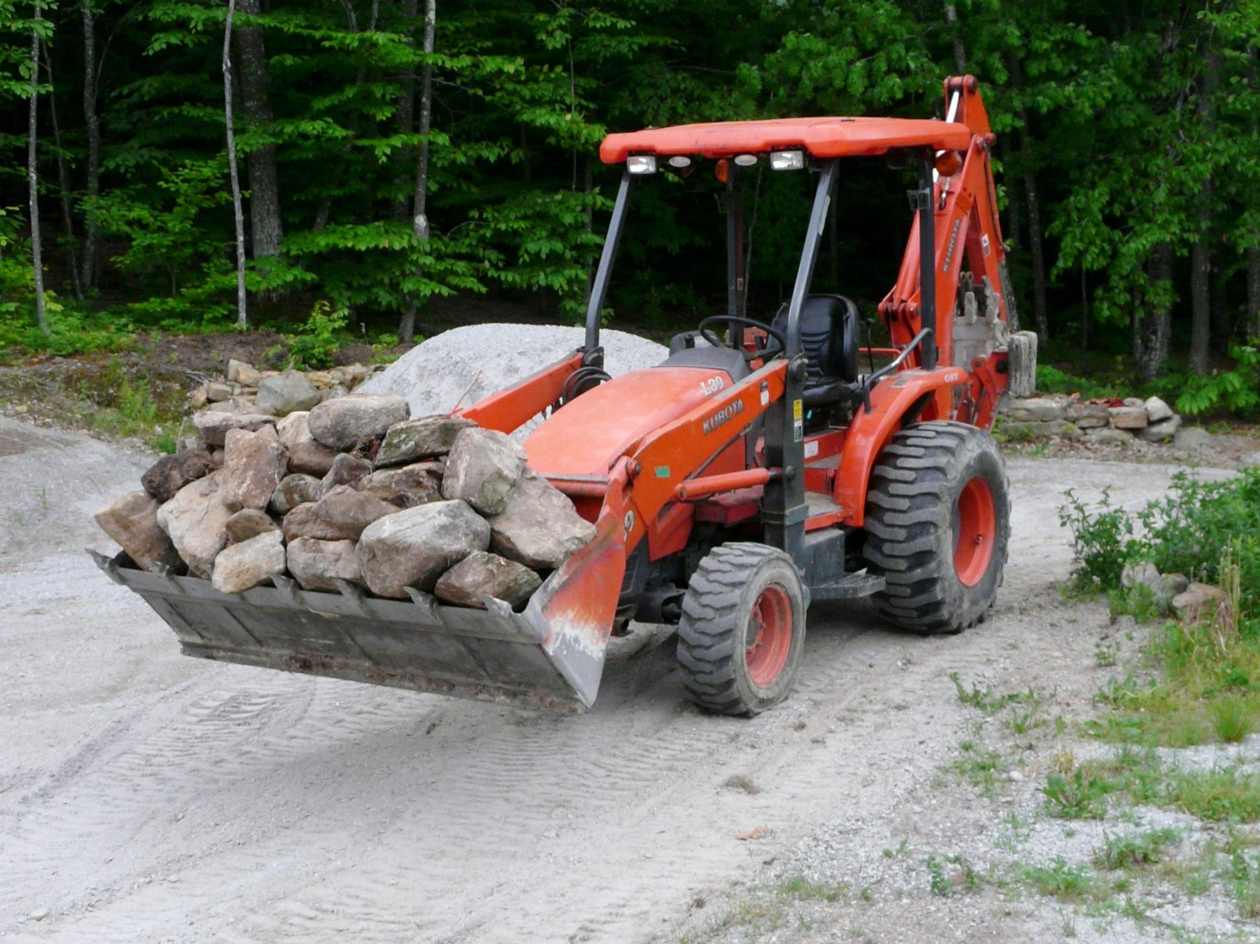

Getting the pasture ready for the cattle
Really Styrofoam rocks, just like the props in a B movie science fiction Monster flick, cant weigh more than 50 Lbs.
I'm using the rocks to line the edges of a ditch and culvert about 30 Long. I needed to haul about 6 Loads
There were also about a dozen boulders, from just under a ton to a few hundred pounds I hauled out of the woods.
I was going to use my excavator, but the batteries are dead again, so I used the L39 Hoe and my back.
