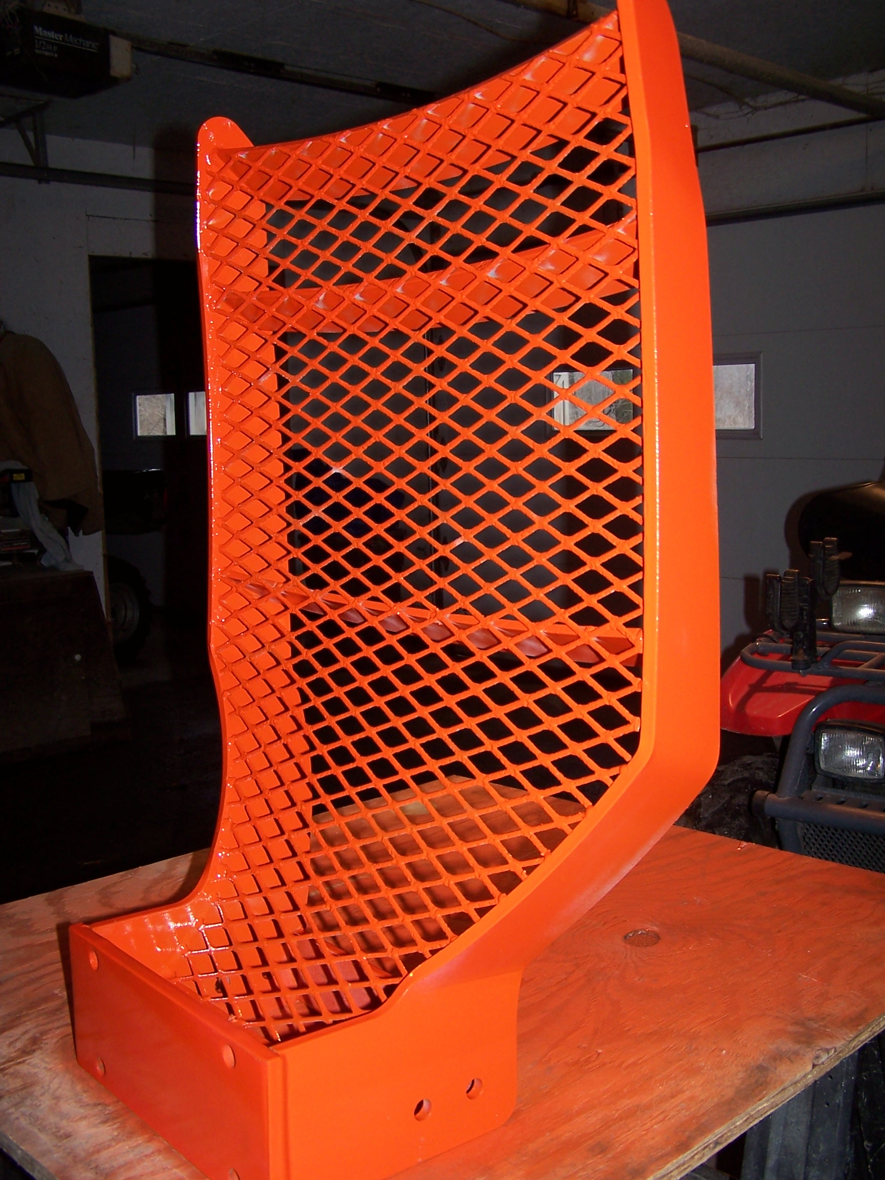

AFTER punching a hole in my lower grill and battery on my L4240;I decided to give it a little protection.Any-one with a grapple my want to consider doing this.I was lucky that I missed the radiator.

Did this very same thing to my Deere when I bought it and before I put it to work. Deere wanted $140 bucks for one that covers about the top 8'' of the Hood guard...useless IMHO, so I built one myself...Grilles and batteries are a lot more expensive than a little expanded metal. Looks good birdman!
/ L4240 grill guard #4
Very clean work!!! Looks factory made. Isn't painting expanded metal a PAIN!!!! ;)
I built sides on mine as well so nothing could slip past. All manufacturers should offer something similar as an option at least for loader tractors.

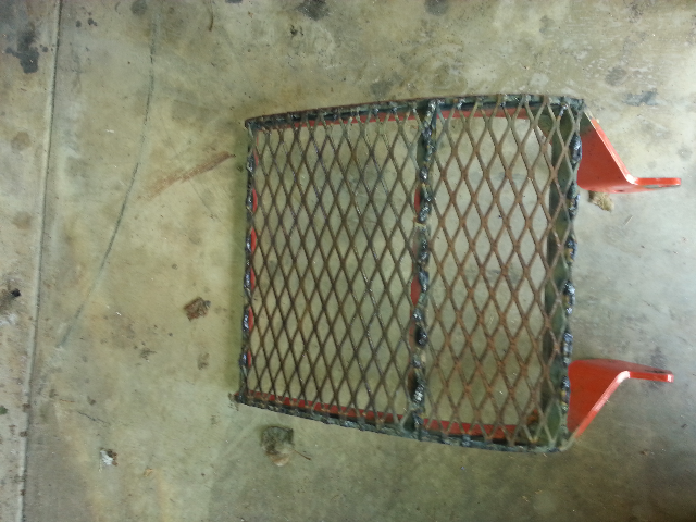

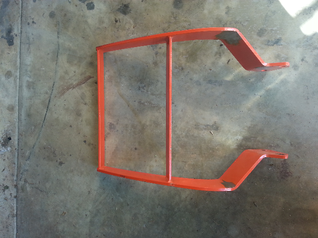

No worries. Don't wanna take away from the OP's ideas. I modified and strengthened the factory grill guard, using the same hinge points and latch.
Hopefully these pics will just add more to the imagination Took these today.

I had to keep the tilt to get my hood opened. I added some bracing and blocks for the guard to push against so the small latch pin didn't have to hold that load. I pile a lot of brush with my Grapple and am certain my guard has protected me from a LOT of tractor damage. I still get small scratches on the front of my hood and lights from small twigs getting thru the mesh.

I just modded the stocker.
I ditched the idea of the wrap around wings due to space issues, it would have only gained me 2" per side and that would have been pretty close to chafing my hydro hoses.
It needs some paint then I will take another pic after install.

I built wings while I was at it. Had plenty of space too which helped. I've got almost as many dents and scrapes on the wings as on the face of the guard. But I pile a LOT of brush with my Grapple!!!

If you are talking to the OP, he modified the factory guard. So did I.
