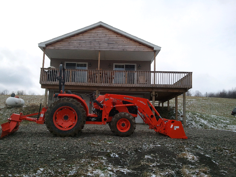

thanks for all the input, I think I am going to go with the L4240, I do like bells and whistles.. the more comfortable reclining seat alone is awesome. I think ill go down to the store this weekend and see what price I can get with a front loader and a rear mower.

Rear remotes are GREAT!! Get them if you can. I never had them on a machine before and now would not want one without them. I bought my 5100 with one set and are currently adding 2 more sets. Here in the states the 5100 does not have any rear remotes standard but up to 3 sets can be added. The first set is the most expensive set, then the 2nd/3rd will cost you less. I believe the L4400 can have factory sets added also but am not 100% positive.
I use mine to control a front grapple, great for grabbing logs and rocks. the 2nd set is the hydro top link - allows me to quickly hook up implements and control there "up and down" angle. The 3rd set will allow me to have a hydro tilt - excellent for blade work - allows you to work a blade and cut crowns on roads/paths to allow drainage (this way you are not getting on and off spinning the factory screw adjustments all the time to account for hills and such)
Normally the hydraulic thumb is controlled by the hoes hydro system and is not run off the rear remotes. This makes the system work a lot smoother and makes it a 1000 times easier on the operator. If you controlled the thumb off rear remotes the lever would be set up to be controlled from the regular operators position and not with the operator sitting on the backhoe attachment so it would be an ergonomic nightmare.
