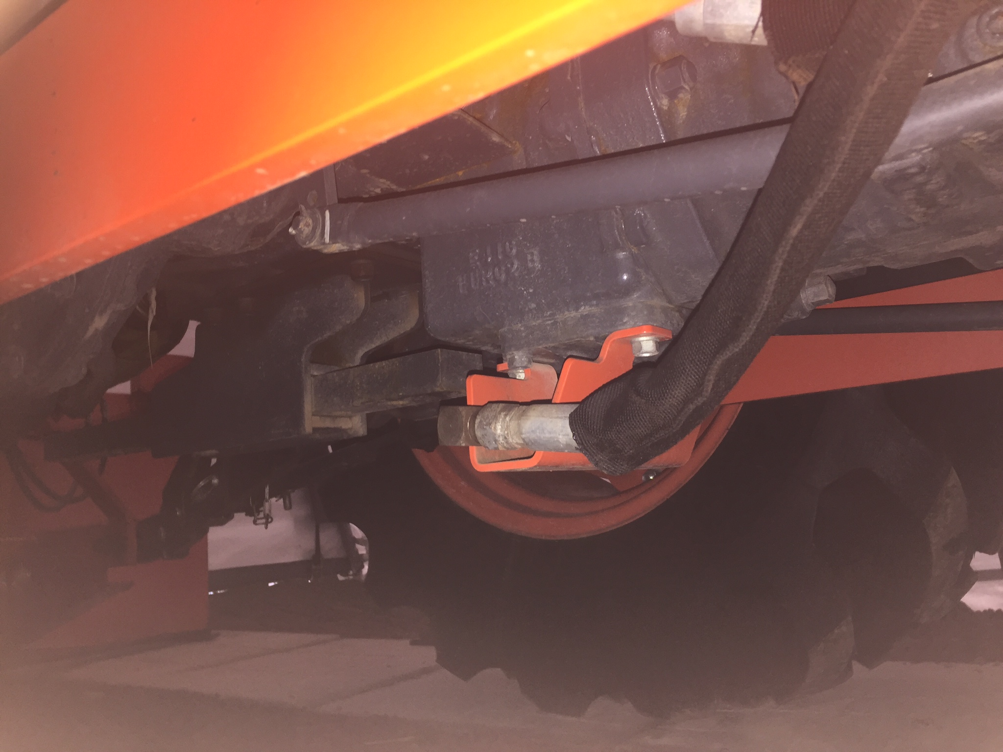

I've seen this set up on many of the GL 40 HST series tractors. When I service them I simply remove the hose with out removing the guard. It will drain like that. On the HST units you'll need to remove the drain plug on the bottom of each rear Axel housing as well to get it all drained off.
Incidentally my Kabota 2011 5740 has the same set up as yours but my 2008 4240 had a different set up for the third function valve without that hose in the bottom. Both are oem 3rd valve set ups. image.jpegThe 4240 is a very nice machine. :thumbsup:
Incidentally my Kabota 2011 5740 has the same set up as yours but my 2008 4240 had a different set up for the third function valve without that hose in the bottom. Both are oem 3rd valve set ups. View attachment 448737The 4240 is a very nice machine. :thumbsup:
It's nice to know you've seen this before, that helps.

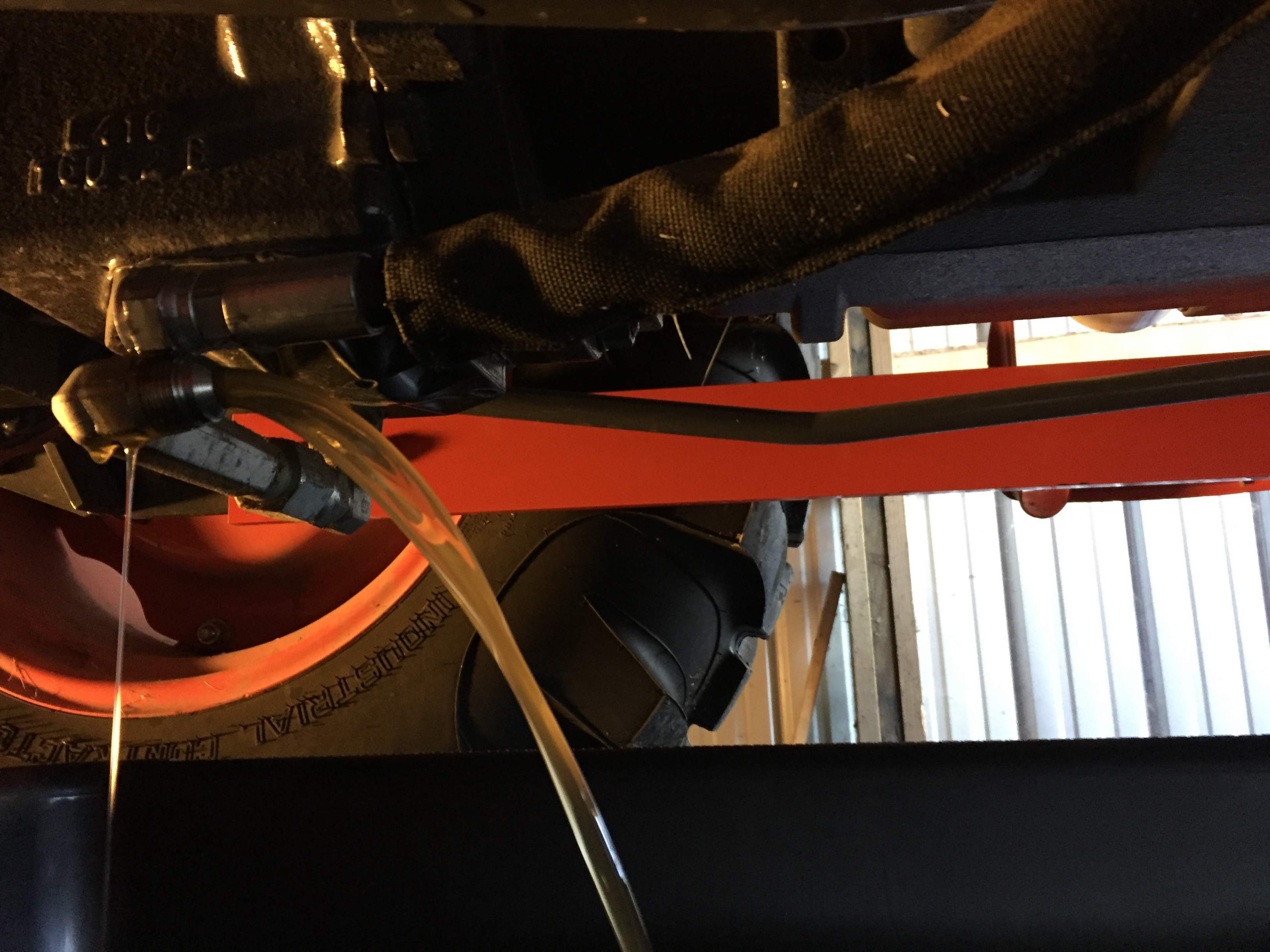

It didn't end up being as bad as I thought. Below is a picture of the trajectory of the fluid as it started draining when I removed the hose. The fluid from the axle drains actually came out a little more horizontal, I think because the drain hole and plug are smaller.

Fluid trajectory:
