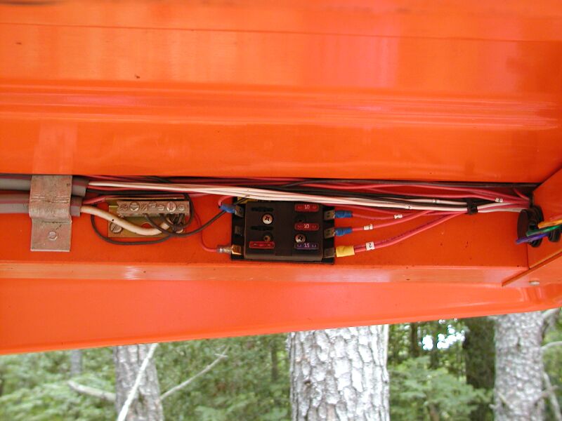

#181
Fuse block and ground lug.
MarkC

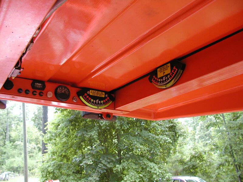

   / L4310 Enhancements
#183
Dual R & B Slope Indicators...
MarkC

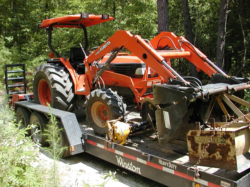

#184
A shot of the 24' trailer loaded with the stuff I used on a job I finished Friday. Right to left: Old beat up box scraper (you can just see the loader forks sticking out from under it), the Danuser digger with 30"/18" auger on it, tiller on the back of the tractor.
MarkC

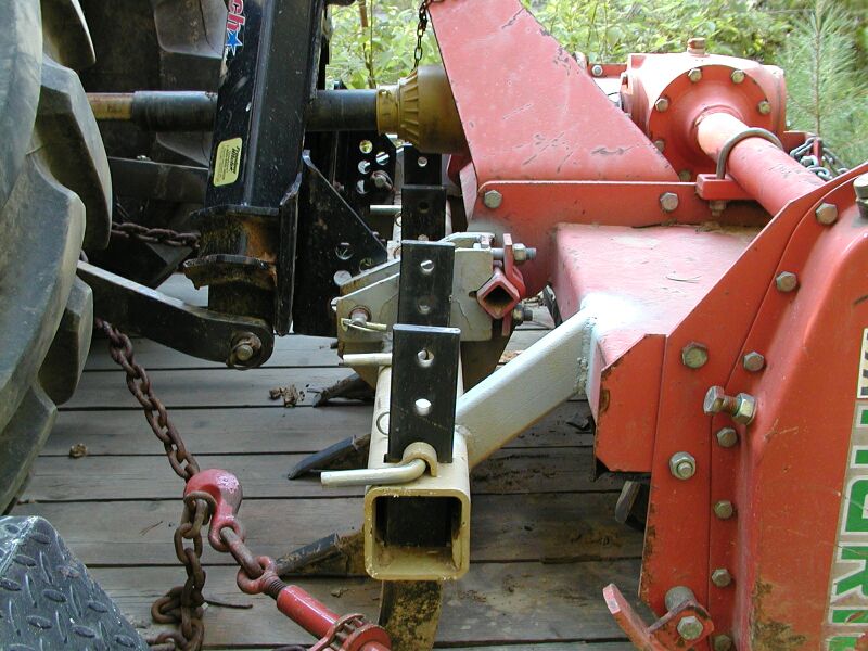

#186
Not strictly an L4310 enhancement, but a major improvement in my Agric tiller. A Landpride scarifier bar hacked up and welded to the front of the tiller. No more bouncing around on hard ground. It rolls big rocks up before they tear the tiller up. It breaks up really hard ground first so the tiller can chew it up.
MarkC

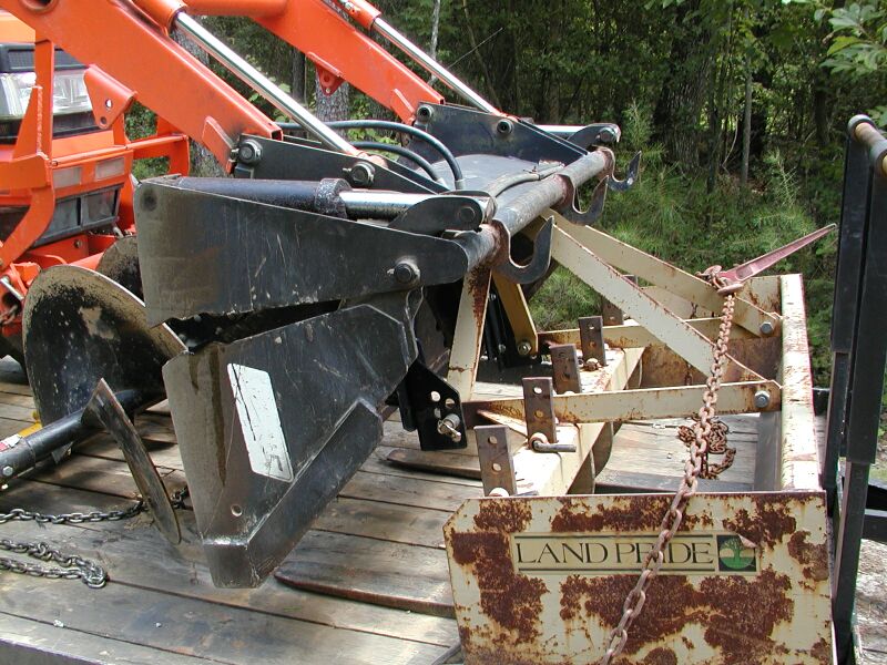

#187
4-in-1 bucket with pallet fork hooks (and leaking cylinder). Pallet forks under the box scraper.
MarkC

   / L4310 Enhancements #189
Never seen that done to a tiller before. Looks like a neat idea, so long as you have enough tractor to pull it.
Bird
   / L4310 Enhancements #190
Hi ya Bird
i have seen it done to a power harrow a few times and i think 1 brand of tiller ya could get as a addon.funny thing about it is ya don't need tiller+ripper Hp to work it ,as tiller is working in soft ground
catch ya
JD Kid
