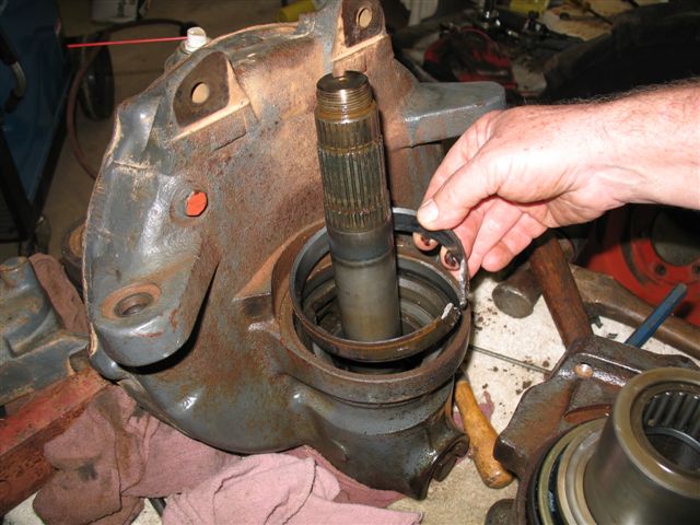

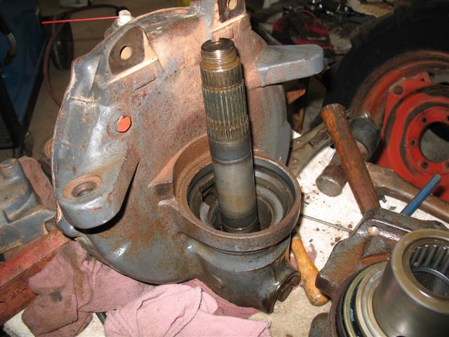

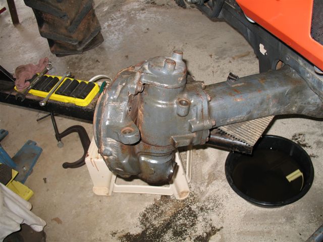

It took about 2.5 quarts of gear lube to fill up bevel gear case and axle case which is seperate resevoir than main axle that has screw in dipstick. Also, I want to be clear on this. I highly recommend Ronnie at http://http://www.tractorsmart.com/enter.htm , without his help it could have been a trip to the dealer. My father in law was there every step to help because this is NOT a one man job. This stuff is heavy and it would be easy to get hurt.
One more thing about Ronnie, he charged me $30.87 for the new seal. I called two different local Kubota dealerships and they each wanted $52 for the part. This is a great forum.
Ken
   / l4350mdt #15
Ken - its a great forum exactly because of members like you. Thanks for letting us all see this repair - not everyone would have the courage to tackle it. Great posts and pictures - great job.
   / l4350mdt #16
Ken,
Thank you for the great coverage of the repair. I am glad you have everything working again.
Design
   / l4350mdt #17
Ken,
Most excellent. Thanks for taking the time and effort to share.
