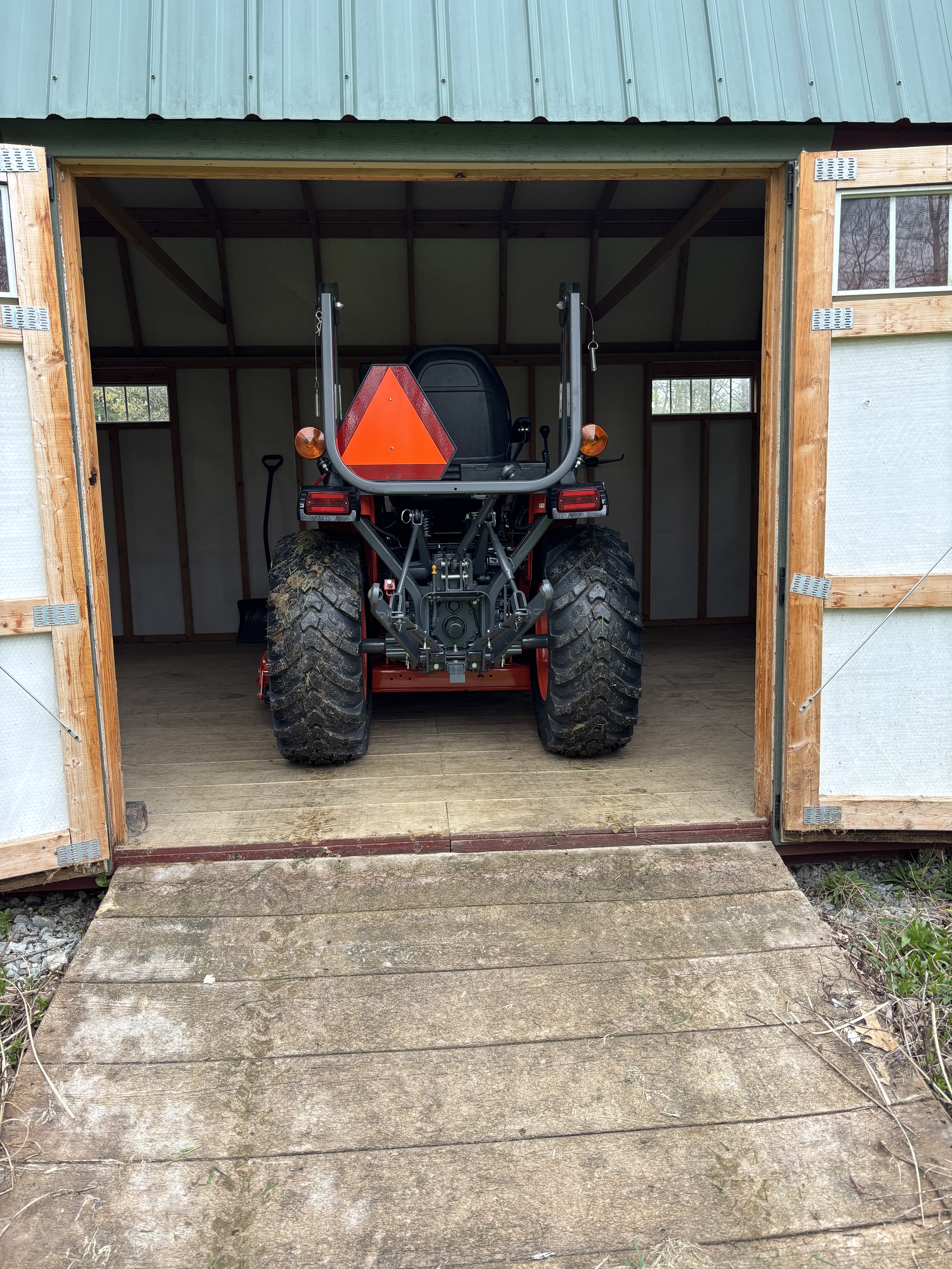

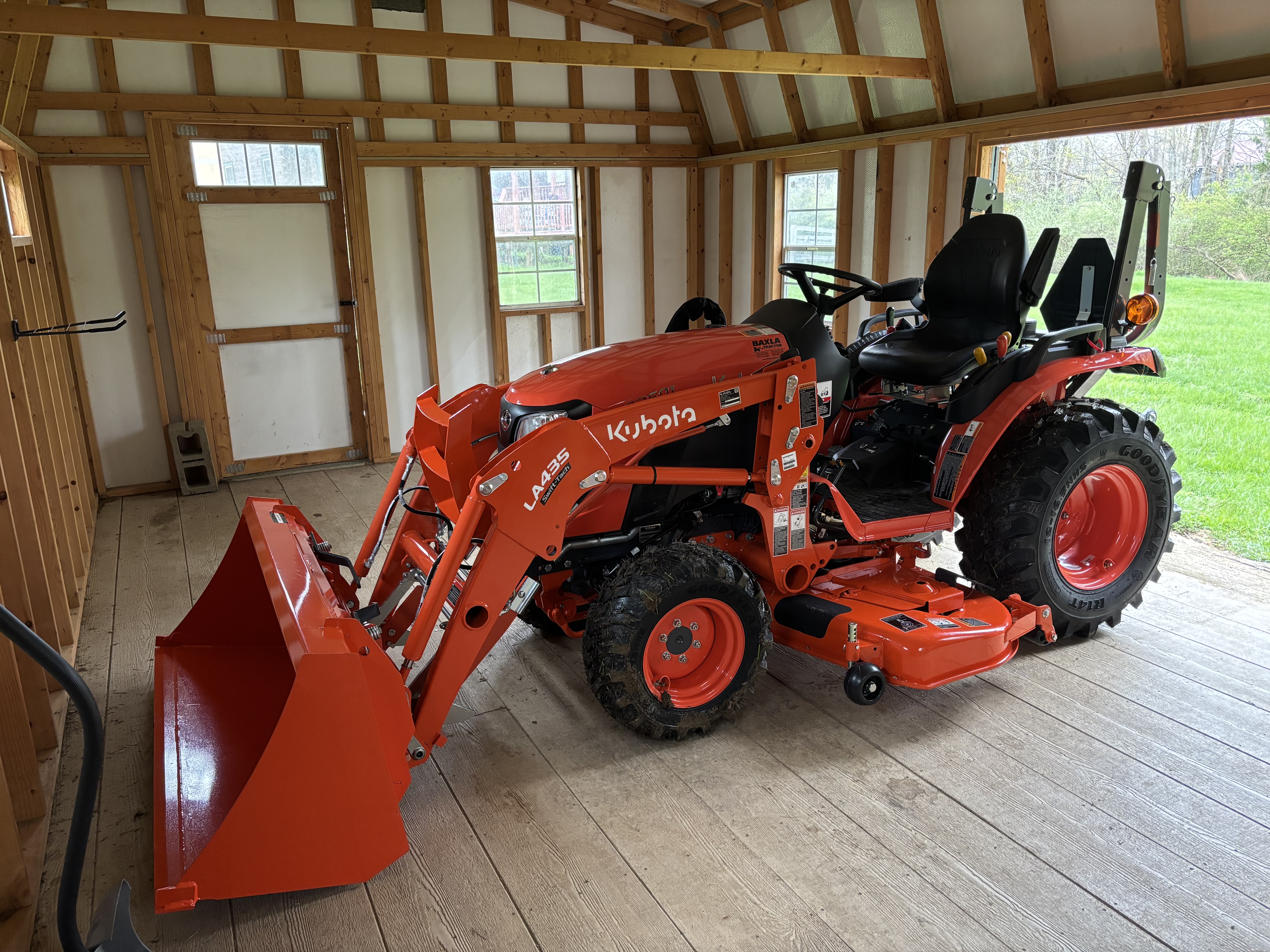

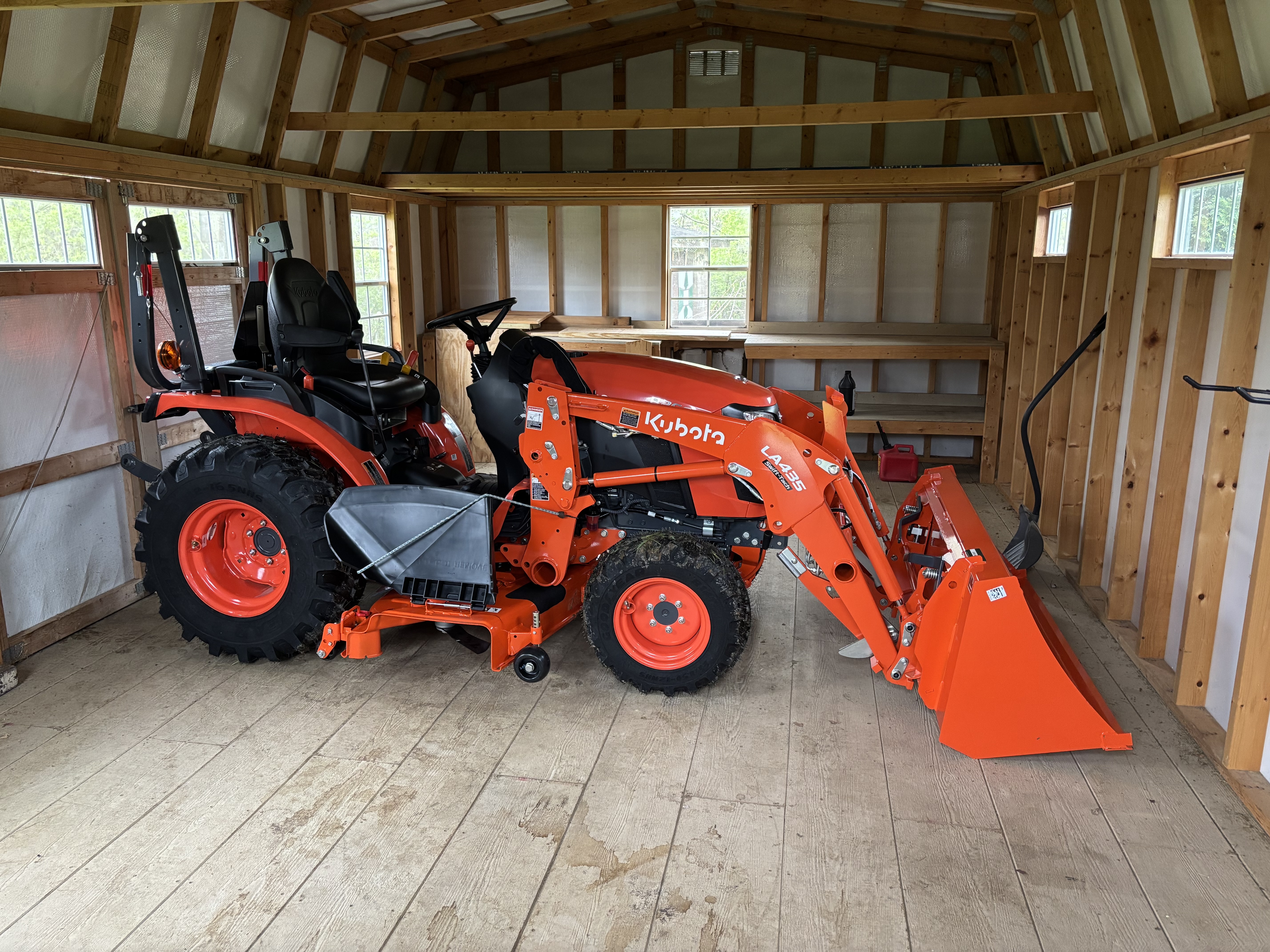

I think it was better in the long run going new. I went back and forth with new vs used but the pros vs cons was much higher with new. I looked at few brands as well. I looked at Kioti and John Deere. But Kubota won. Having one vehicle built in Japan and the other vehicle 1/2 American 1/2 Japanese I wanted a well engineered product with good dealer support. I know everyone knows what a b2601 looks like but here’s mine fresh off the truck.
