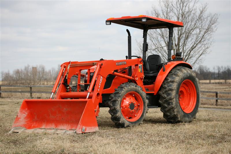

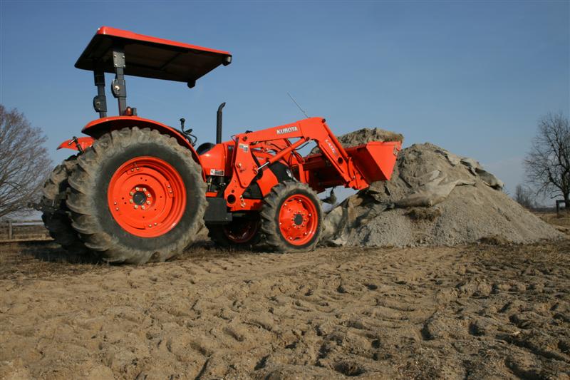

Get as many remotes put on initially as you possibly can!!:D I had two remotes on mine. I told my dealer I wanted three. He kinda looked at me like, what on earth for? Just ask Z-Michigan. He'll tell ya the benefits of getting the remotes put in initially. Or maybe it was MtnViewRanch who told me of the remotes. . .I can't remember. Oh well. But, you can never have too many remotes. In fact, if you're ever going to consider a top 'n' tilt with a hydraulic box blade, get all three remotes, and get 'em now!! Three remotes would also be useful for a batwing. You could raise/lower the deck and then raise each "wing" independently if necessary!! I got three remotes put in for that reason. And also I figured it would be 5 times as expensive if I decided to do it later.
