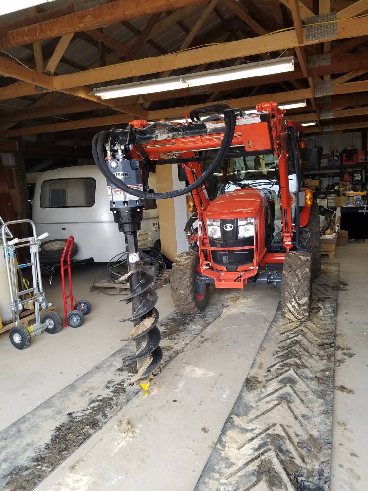

L4060 & OEM 3rd function... Its a bit weak & low on power compared to my old 3pt unit. 14hp hydraulic power, best case scenario vs 20+ easy on my old PTO. But reverse & downpressure make it better overall.
I have the smallest Danhuser one, for 8-14gpm or something to match my 12gpm on the machine.
I've heard rumors that the 3rd function solenoids might not be happy with continuous duty. But I've been fine with a few hours of the usual 1 minute on 1 off while moving around so far. 20170401_133255.jpg
