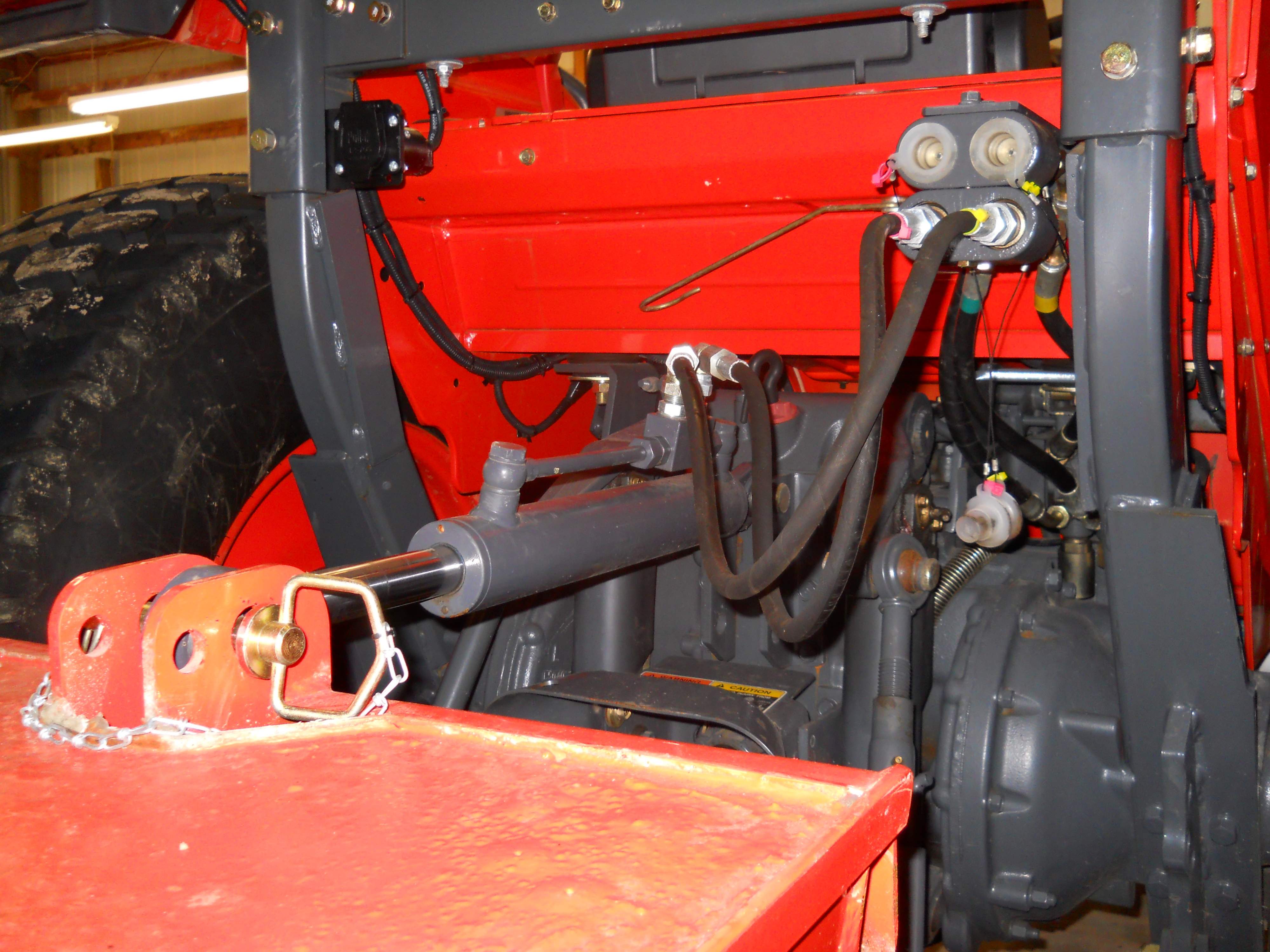

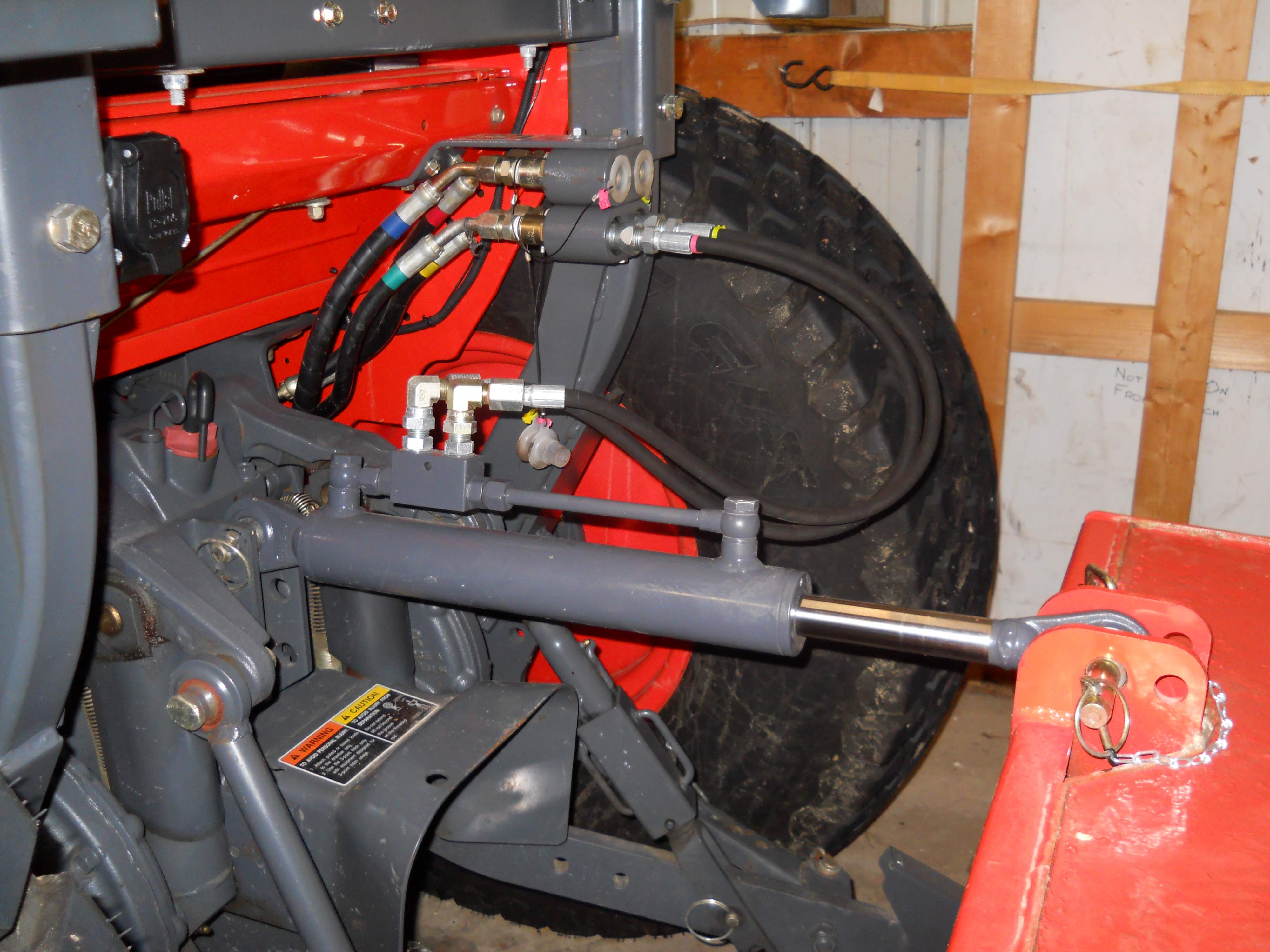

Here is a later pic of mine with the 90 degree fittings on the top link cylinder. With the straight fittings, the hose could hit the sheet metal under the toolbox. I just replaced the BSPP-JIC fitting with one from work, but the banjo fitting will do the same thing only better. Philip.

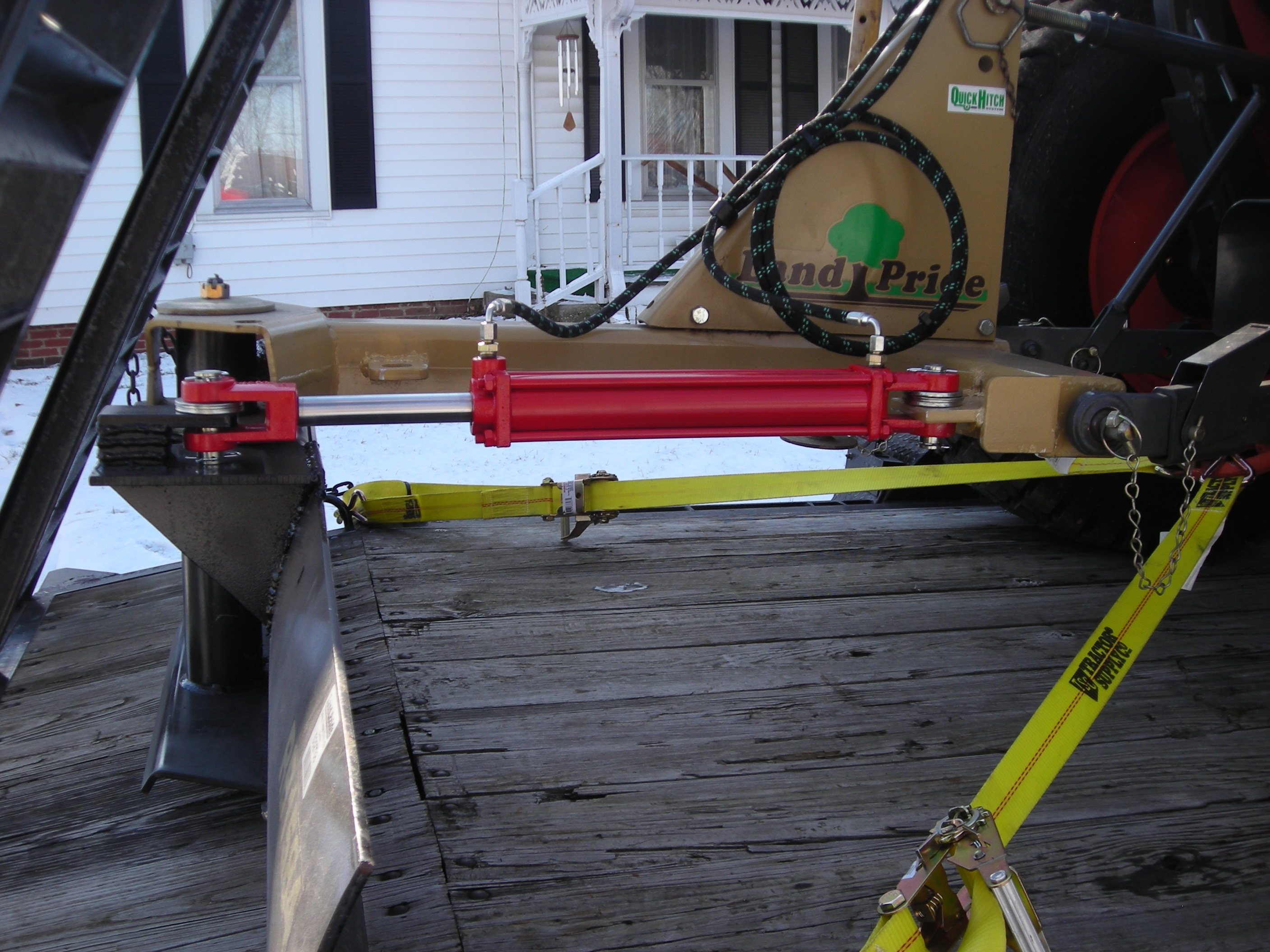

Yes, you could add one or two tilt cylinders, and I have thought about it, but I am not sure if that is something I want to do. Right now I do not have allot of applications for a tilt, and with the screw side link I know I am always level. I use my second remote to angle my rear blade. Philip.

Good golly...you're one step ahead of the pack! Now I see why! There's no reason to get one...
