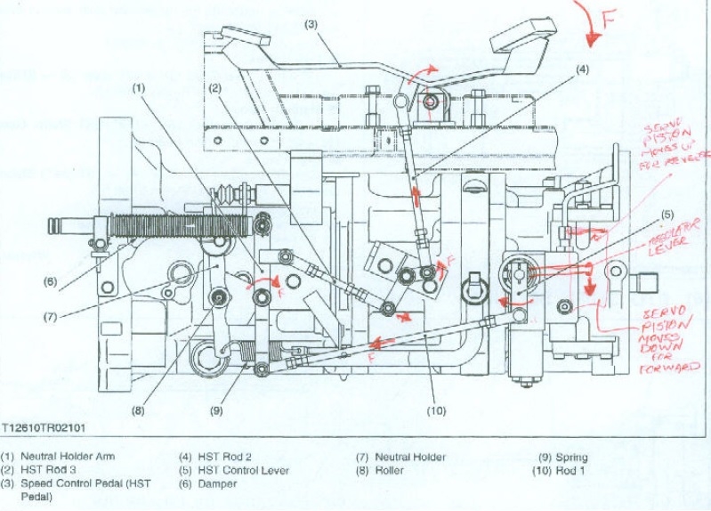

Many HST problems start somewhere in the linkage on the outside. Aux pump is not involved in HST's function. Usually something under the right floor board isn't right. Hope this helps. Dick B.
Nice illustration! When my HST F/R quit working it was an external control cable that had come undone.

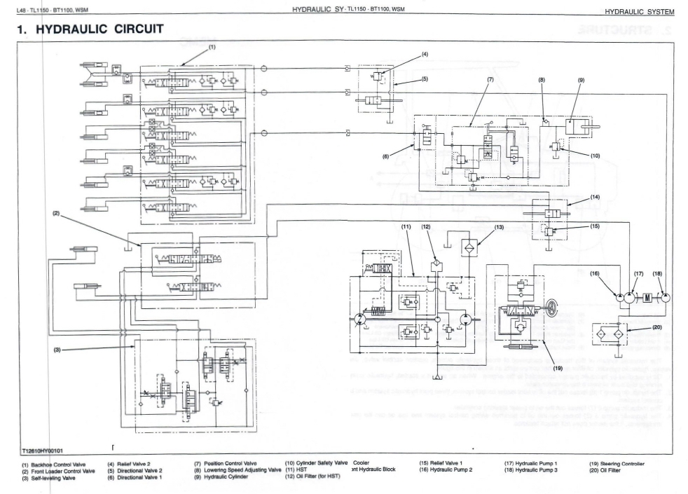

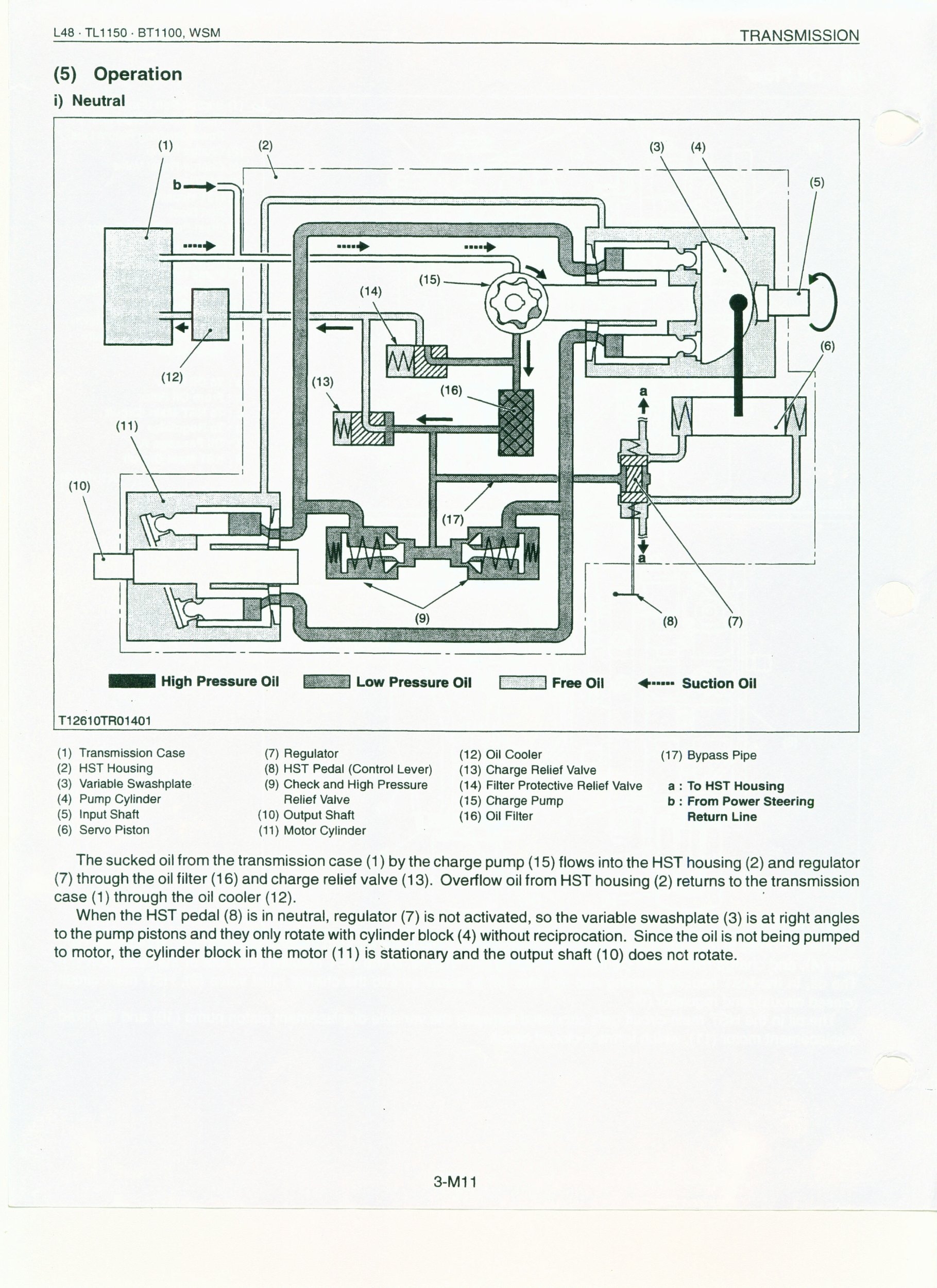

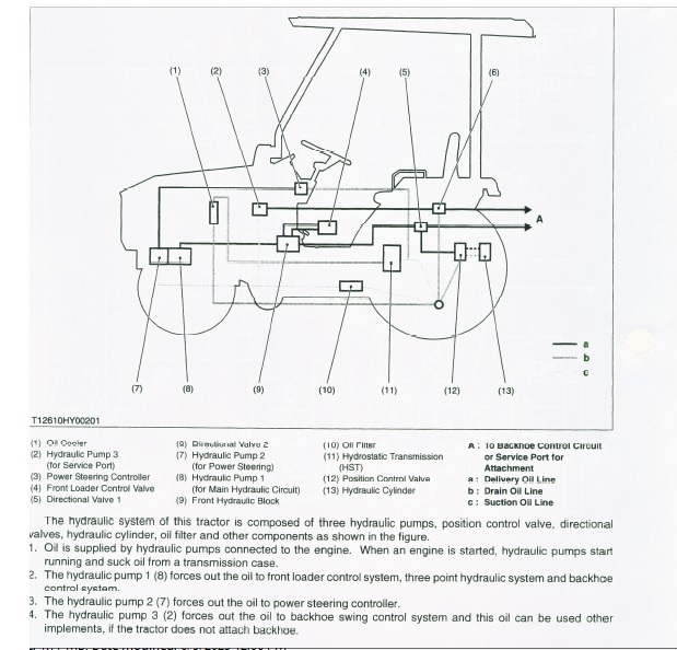

Did you replace the front-most pump (steering) or the one right behind it (main hydraulics)? Reason I ask is the HST's charge pump gets oil from the steering return line - if there's a loose fitting there or on the oil cooler the charge pump may be sucking air and not supplying the regulator - so no shifting.
/ L48 no forward or reverse #9
There's a discussion about similar symptoms here that might give you some ideas.
View attachment 807822View attachment 807825
Yes, I agree with that. I remember back at the start the OP said there is a slight leak at an upper connection. So we should talk a bit about suction leaks. A suction leak will put enough air into the system to prevent the HST from working, but will not leak visible oil out until the engine is turned OFF. The reason for that is that with the engine off, the pump is not sucking air into the line and that means that any oil that is sitting in the line or up in the pump is free to slowly leak out.
BTW, looking for an oil wetness that doesn't happen unless the engine is not running is a good way - an old mechanical trick - to look for suction leaks that you just cannot find any other way. First wash it down in that area with soapy pressure washer to get the old oil off and then you can tell by seeing new shiny clean oil after you run it. Or another way is to simply replace all suction lines and tighten suction joints. Particularly be sure to replace all 20 year old rubber suction hoses even if they look good - and especially if they are the kind held on with worm drive clamps - they leak at the ends where you can't see the split.
I cannot emphasize to strongly how often a suction (air) leak between the hydraulic filter and the pump is what is causing a hydraulic problem.

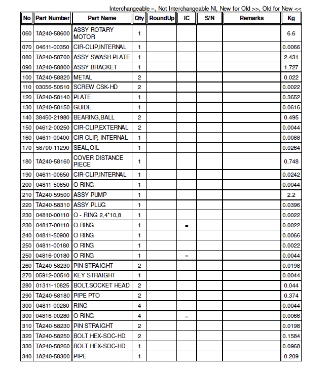

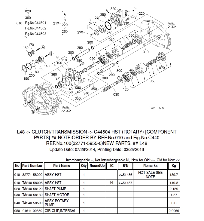

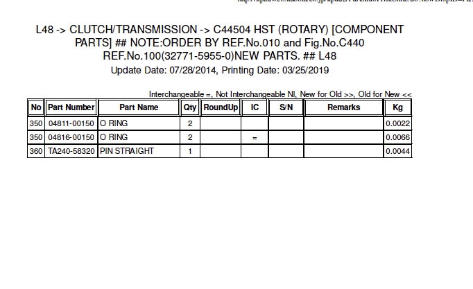

Here are views of the PDFs I posted yesterday.
rScotty
L48 HST Parts 1 of 3a.jpgL48 HST Parts 2 of 3.jpgL48 HST Parts 3 of 3.jpgL48 Hydraulic Circuits- combined.jpg
