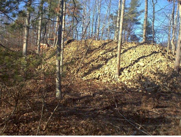

Re: L48 Loader Problems
Stopped in at the dealers this morning and the service manager showed me a brand new leveler valve. Said it was only $10 more than the spool so he ordered the whole thing.
He is going to try and get it installed next Monday or Tuesday so maybe I will have something to test next weekend. As to what they did to the spool. Looks like it is adjustable but if all they did was adjust it I'm not sure why they ordered a new one. I will see if I can't talk to the mechanic next week. Will let you know how it comes out.
Have 92 hr on mine now and have moved a lot of dirt also. My cabin site is about 60 wide 120 long and the cut on the back is about 11 foot high now.
John

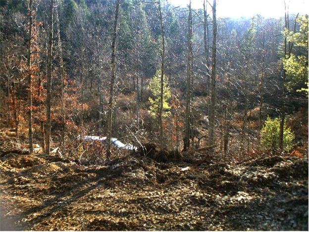

A view looking up at the site

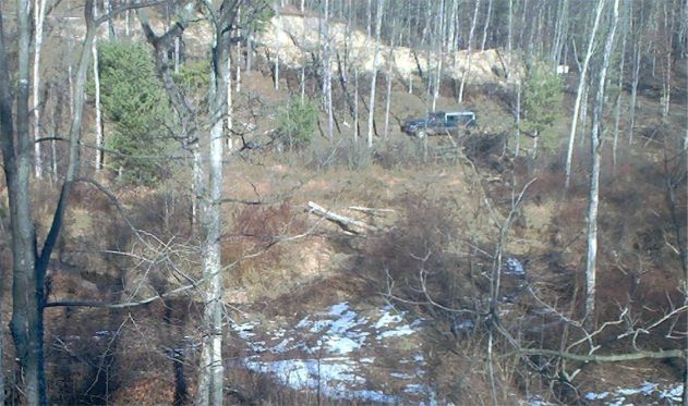

looking at the site from across the valley
