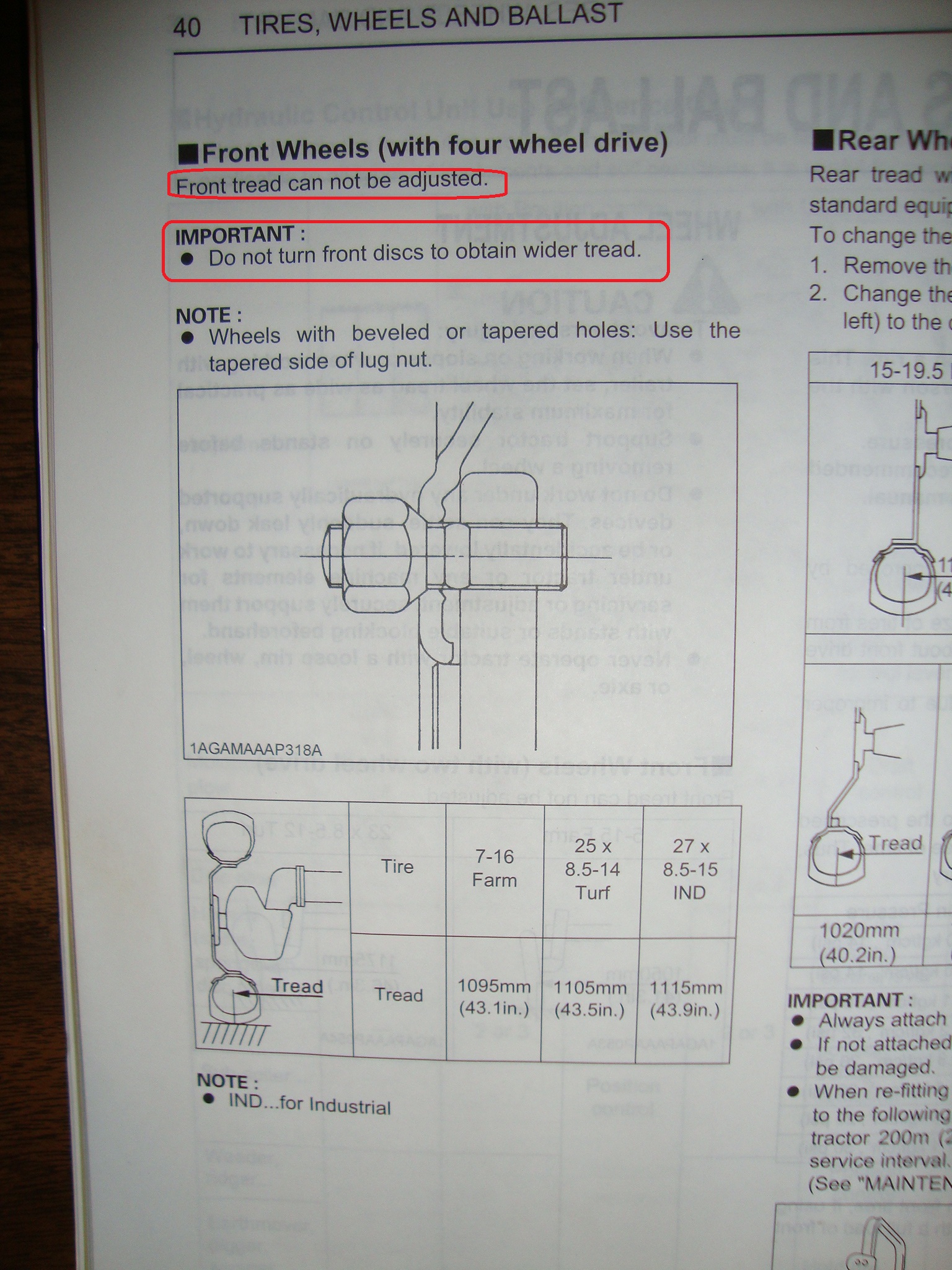

Usually the owner's manual says whether or not you can safely do this. Here's the page from mine, for an L3400.. you'll also see that they make a reference to tapered or non-tapered holes in the rim. Mine are not tapered, and have washers under the flat side of the nut against the rim.
Sean

There will always be someone willing to take a chance that the original equipment has an engineering safety allowance that will let them do something contrary to the owners manual...
Do as you will, but any additional loading on parts, with no gain, makes no sense to me.... and I have done many things that have exceeded recommended limits... I just don't do it when there is no real gain. and I know that just because I have not experienced a failure while doing it, I should not be surprised by shortened life of stressed parts...
If replacing parts is not a problem then it should be of no concern ...
With a wider stance on the front it will Always have additional forces on all front end components... Not just when you are operating at load limits... Things will always wear out... some times faster than other times.... and sometimes you can control just how quickly you are racing toward that failure.
   / L5030, increase stability by widening front end tires??? Not sure, difficulties found #20
My manual says not to. My dealer says not to.
Like said, tractor pivots at the center of front axle, so it wont help any way...
