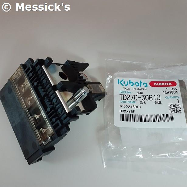

I have 12 volts to the starter. I don't seem to be getting power to the fuse box. The part shown below attaches to the battery and there are 2 connectors that plug into the bottom of it.
I do get power to the screw you see on top, and there is power to the left of the screw also, but no power to the bottom where the connectors plug in. It looks to be all intact, but still no power. I came into my office to call my local dealer to see if they have one in stock. But 2 dealers don't open until 8 am...
I'll go check continuity on this part now.

At least you have the problem isolated now.
What the heck is that box? Is there a fusible link in there or is it simply a junction box where the plastic modular plugs attach at the bottom to get power from the battery? I'm sure you wiggled things around and made sure the connections are all clean and secure.
I was under the hood of mine a couple days ago and tapped a new power wire right at the battery for a 3rd function valve. I don't recall seeing that box on mine. I'll look again.
   / L5740 battery/starting issue #18
Not sure what that box does....but I think you are on your way. Just keep tracing the power circuit. IF you are getting power to that box, but not beyond it I think you have found an issue. The question is whether its a connection issue or something that is repairable, or if replacement is the only answer

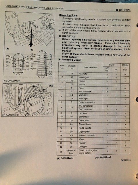

What about that main fuse block right behind the left headlight??? Sure everything there is OK?
There's a 60 amp Main fuse there and 3 others.

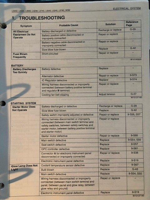

Here's the WSM troubleshooting page. Looks to me like you're still stuck right at the top section.
Hope you can read this. Let me know if not.

The picture you showed is a fuseable link block. The 4 windows in the front should show a thin metal bar (the bar will be burned off if that part of the fuse is burned out). I "think" the power from the battery will go to the first big lug, then the other big lug will attach to the starter. The smaller ones will feed the rest of the system. Look for a burned out spot in one of the windows. Usually you can put a meter or light on each fuseable link to check rather its blown on not.
