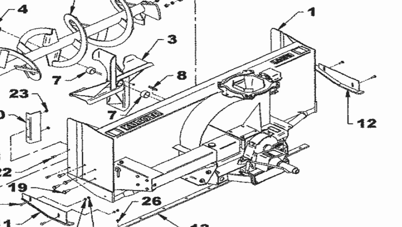

Did you purchase the "down pressure relief valve" option?
Kubota strongly recommends it but I didn't want to spend another $2000. My dealer suggested with my paved driveway, I would probably be OK.
   / L60 with front snowblower - pavement scraping #23
I did not but on float there is no down pressure so I would think the only need for that is if you are not using float and blower hits something. Like a relief valve when you add the blade attachment for it.
I will try new to widen the shoes, the design has long shoes BUT all the pressure is on the front inch wide section, so it just trenches like a knife. I am wondering if I lower the rear of show it would cause head to rise up.

While skill is no doubt important, I think the issue at hand here is that the implement in question doesn't have any manual or hydraulic ability to adjust the curl; and the set angle seems to be too aggressive and cutting in. Pretty hard to deal with even if you are, like the Sade song says, a smooth operator.
#26
Agreed. Unlike 3 PH blower where top-link allows adjustment of "aggressiveness" of bite, I can find no where in operator's manual, a way to make a similar adjustment.

i just switched from a L2195A front mount to a L4474 with the 4 point hitch, and I'm finding it digs in more than the L2195 did. The only real difference is the hitch and the skid shoes, and both may be contributing factors. The 4 point hitch is heavier up front and I suspect puts more down force on the blower than the old style hitch. Additionally the L4474 has the smaller skid shoes, not the full length style like Moship shows in post #11. The "old" style are longer and have a more gradual incline. I'm considering ordering a pair of the old shoes to try. They will fit, but I would have to drill the mounting holes.
One other point, not directly related, is that the new 4 point hitch is 5 inches further out the front, which I can notice in turns, as the blower is that much further forward from the front tires. Not to bash, as I'm pretty pro Kubota and pro Canadian made, but the paint job on this thing sucks. No primer and if flakes off pretty easily.

I normally don't use float. I just adjust the height depending on what's coming out of the blower. If it's snow I'll actually lift the front tires off the ground and brake steer. If it's rock or dirt I'll lift it up. May not work perfectly but it usually does the job without shearing pins. I also use my plow truck for the first plow to get the larger loose rocks off the drive. When in the garage my blower sits flat on the cement when down. If yours isn't then I would guess something is either wrong (maybe a mistake during fabrication) or you have a wrong part somewhere. Your dealer should be able to help you out.
   / L60 with front snowblower - pavement scraping #30
Today I had a closer look at the skid shoes on the new L4474 while parked in the garage and I could see that the whole blower is tipped slightly forward and was it ting on the fronts of the skid shoes. There doesn't appear to be any way to adjust the pitch of the blower, but I was able to adjust the skid shoe so the front mounting bolt is one lower than the back, thus raising the front of the skids. In this configuration it sit on the back of the skids which should help. Will have to test it to see.
