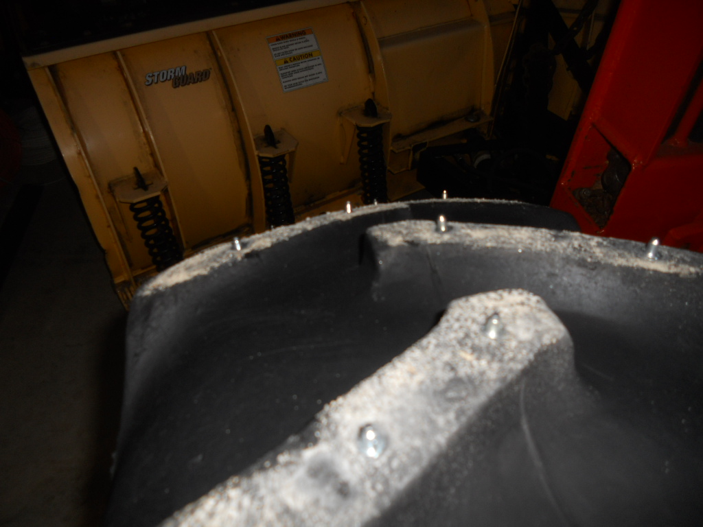

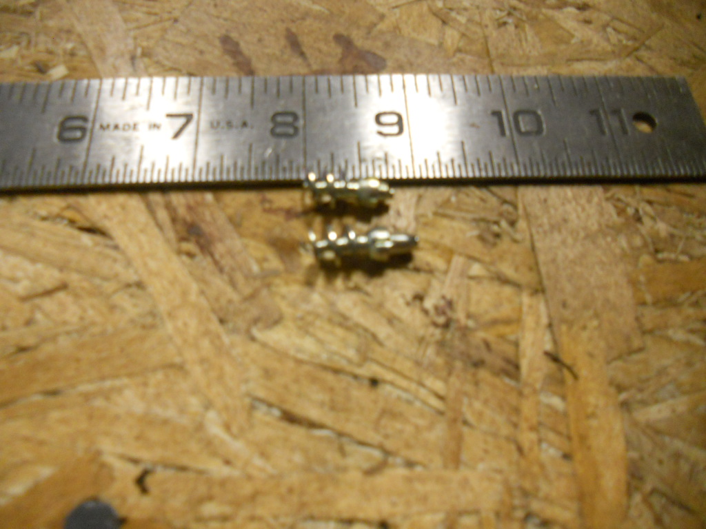

I don't know if you've seen any of the conversations here about chains & tire studs, but I have been running the screw in tire studs because 1. I run the roads (plowing driveways) and would wear them out fast, besides jarring my teeth out. 2. Much more gentle on the paved driveways providing you don't aggressively spin the tires while stationary. The studs are removable but they leave a small pocket (small hole) in the tire lug. I removed then the first year just because I thought it was a good idea, but after seeing these small holes fill up with gravel/sand, I've just left them in for the past 3 years or so.
The bigger (longer) studs are in the rear, shorter on the fronts.
These are the front tires
Wet snow is the devil, I too would be concerned about damaging 1/2 of pavement. These studs are about a $1 each, not real cheap when you add up the number of them you need. I put 2 in each "bar" and iirc I bought 400 of so of them so it's not a cheap alternate, just another choice to consider. If you decide to give them a try you could start by 1 in each lug or 2 in every other etc. The plus for chains is that I would guess for a lot of your snows you'll get away with just the tires, esp if your house & tractor is at the top of your hills (opening up down hill), as with many things, gravity is your friend.:D
