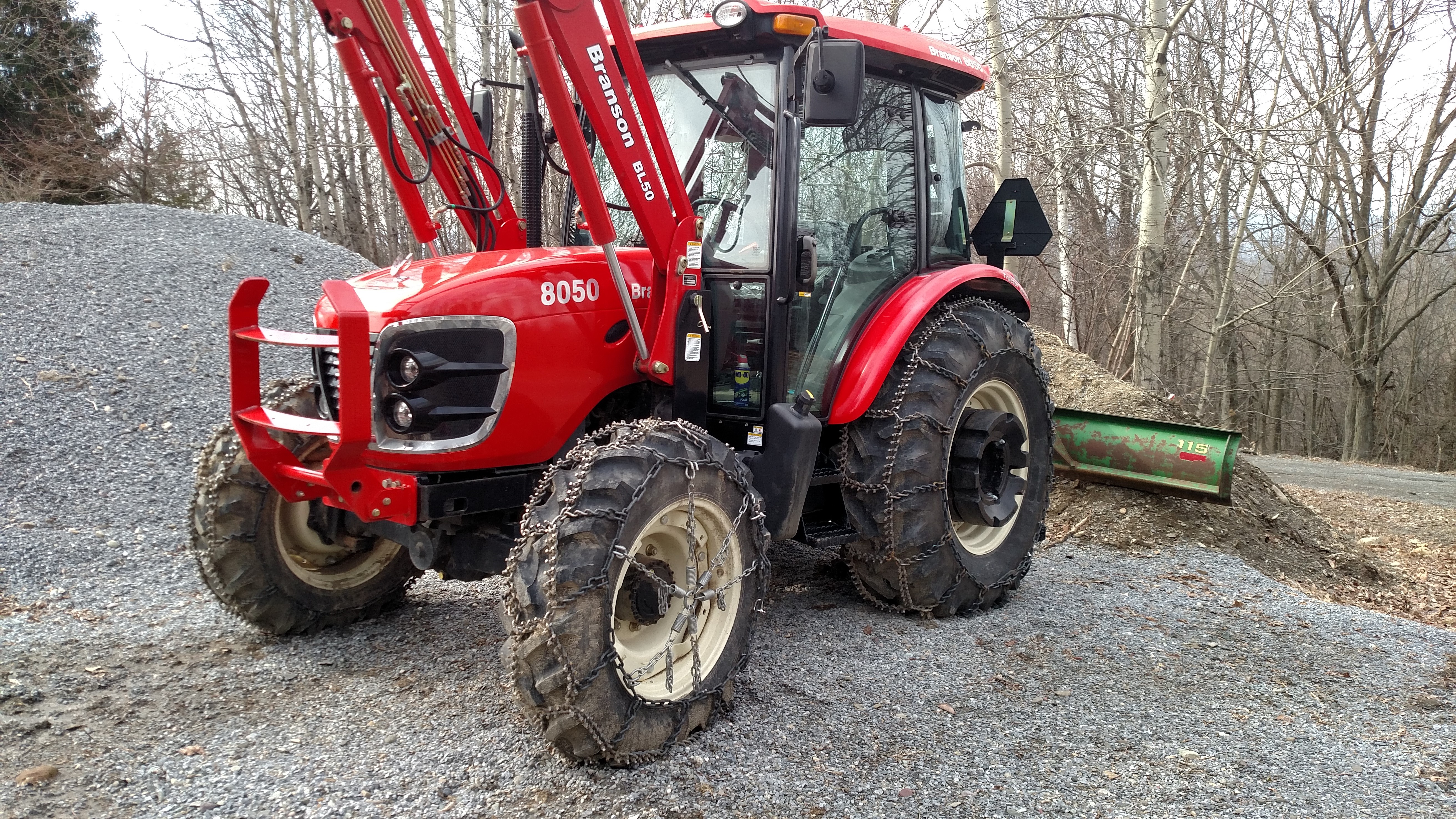

While weight is helpful, chains are what will put the power down.
