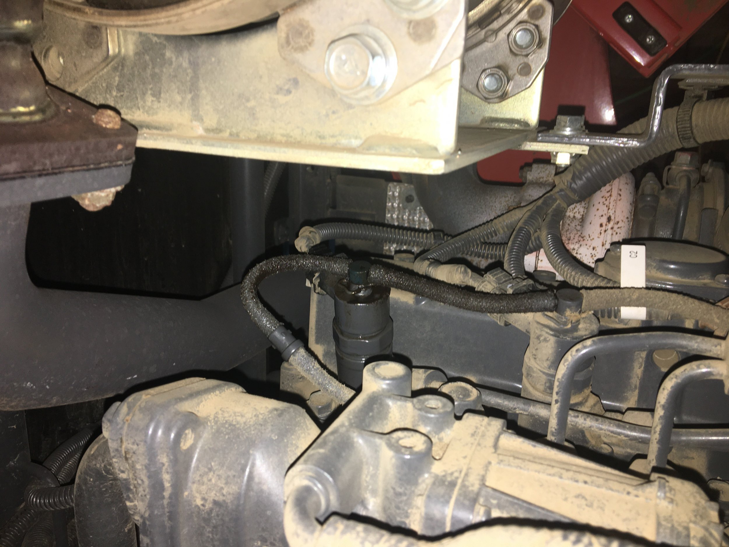

While looking for the GP's, to see how hard they will be to get at, in order to test their resistance, I noticed what appears to be a leaking fuel line or injector. At least I think this is an injector. That liquid on it is definitely diesel. I'm calling the dealer tomorrow to discuss this and the hard starting issue.

Fix the fuel leak first, that is also an air leak into the fuel system when the engine isn't running, the fuel tank is below the level of the visible leak. As the machine sets, air is allowed into the fuel system at that leak area, then when starting, the fuel system has to compress the air then bleed the air out before fuel pressure is high enough to actuate the injectors. Fix that first!
Maybe that was the knocking I was hearing, when trying to start it. Maybe the leaking injector was not yet adding fuel to the cylinder. I want to check with the dealer regarding what is covered under my current warranty. I don't want to be fooling around with something that is covered and then have them deny coverage because of something I did.

That leak appears to me to likely be an excess fuel return to tank line.
Could be as simple as bad hoses or it could be an injector going out and dumping to much fuel.

I sent the picture in to the dealer and called this morning but he was on the phone. I left a message for him to call me to discuss the injector and hard starting issues. I think the injectors are covered under the emissions warranty but will get him to confirm.

Good news....... sort of. The service manager tells me that it appears to a leak in the body of the injector and that will cause the symptoms I am experiencing because the fuel system is loosing it's prime, as someone else has already stated. They are going to send someone out next week to fix it and it IS covered under the emissions warranty. He also said it is ok to operate as is. I am still going to put into the heated shop to see if it starts any easier when it is warm. I could also check the resistance of the GP's and see if they are getting proper voltage.

The dealers part guy sent me a service memo that states the glow plug relay on certain serial numbers of the GL series had a known issue with the relays in very cold weather. Apparently the relay could get moisture in it and then freeze, making it no functional. According to the serial numbers he gave me, my tractor is a newer one and should not have that problem. I haven't checked to see if has the newer relay but I can tell you that after moving the tractor to my heated shop, it started very easily the next moring and now starts easier in cold weather. Mind you, it has not got down to -35*C either.
The injector issue is another story. The service guy ordered a new return line assembly over a week ago and it still has not arrived at the dealers. Could be another few days plus the weekend. The snow around here has been piling up and I NEED my tractor to deal with it. After taking the leaking return line off and fooling around with it, I could see a small blemish on the o-ring at the base of the Tee fitting. I didn't think that was bad enough to cause the leak but it was. I measured the 0-ring dimensions and thought I would have a match in one of the large 0-ring kits I have in my shop but no such luck. I phoned all over the local town and the big City closest to us and could not find anyone that had an 0-ring that small. One outfit said he has something close. I needed one that was 6.0 mm OD and 1.2 mm thick. He had one that was 6 mm OD but 1.4 mm thick. I drove 3 hrs to get this o-ring because I was desperate. I needed to get my driveway blown. I installed it but it did not seat properly into the injector. I tried forcing it but no luck. I then tried gently increasing pressure on it while wiggling it and it then popped into place. I was ecstatic. 🄳 Ran the tractor for a bit an no leak. So last night I was out blowing snow to open up the driveway. Today I will deal with all the snow around the buildings. In some places the snow is over my knees.
