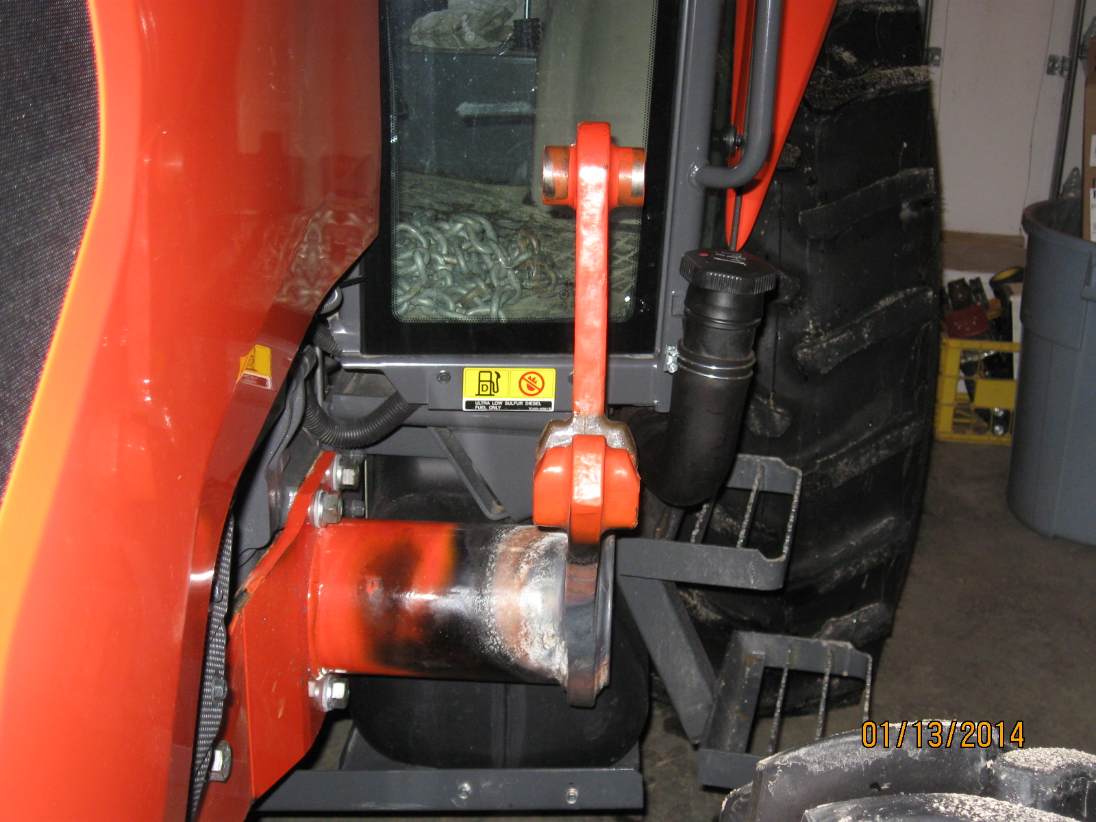

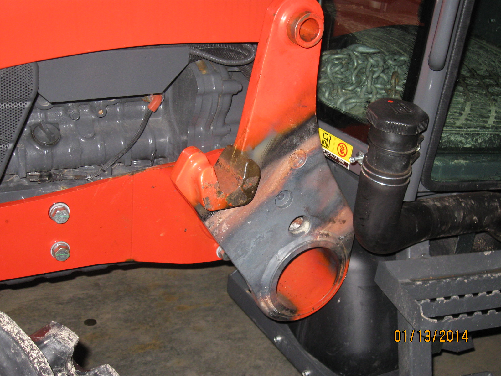

I have a fairly new (65 hours) Kubota M6040 with a LA1153 loader that I bought new. While moving some snow yesterday, one of the 2 main pins that holds the loader assembly in place, fell out. I was pushing snow into a bank and the failure caused the loader to swing to the left thereby bending the main frame on the left side. My dealer, Chappell tractor of Milford, NH said it will not be covered on warranty because there is no broken part that caused the problem. The poor design of the pin that does not keep the pin from falling out is not a "broken part" so tough luck for me. The service manager said that both Kubota and New Holland have the same pin design with a sliding pin the goes through a hole on the frame. It seems to me that a jarring of the tractor during normal plowing operation could allow the pin to dislodge and fall out. He said it has never happened before. Personally, I think the sliding pin should have a hole drilled in it and a spring pin through the hole to prevent the sliding pin from disengaging. I plan to do that fail safe myself once the tractor is repaired. In fact, the LA1153 owners manual states under "Reinstalling the Loader Important: 6. Stop the engine. Reinstall the mounting pins and secure them with the spring pins." So someone thinks there were or should be spring pins on the assembly like I do. Anyone else have a similar problem? Thank you, Jack
Wow that really is a shame. Are you going to take that bracket off and have it pressed back into correct orientation?
Thanks. Yeah, that's the plan. I'll let everyone know how it works.

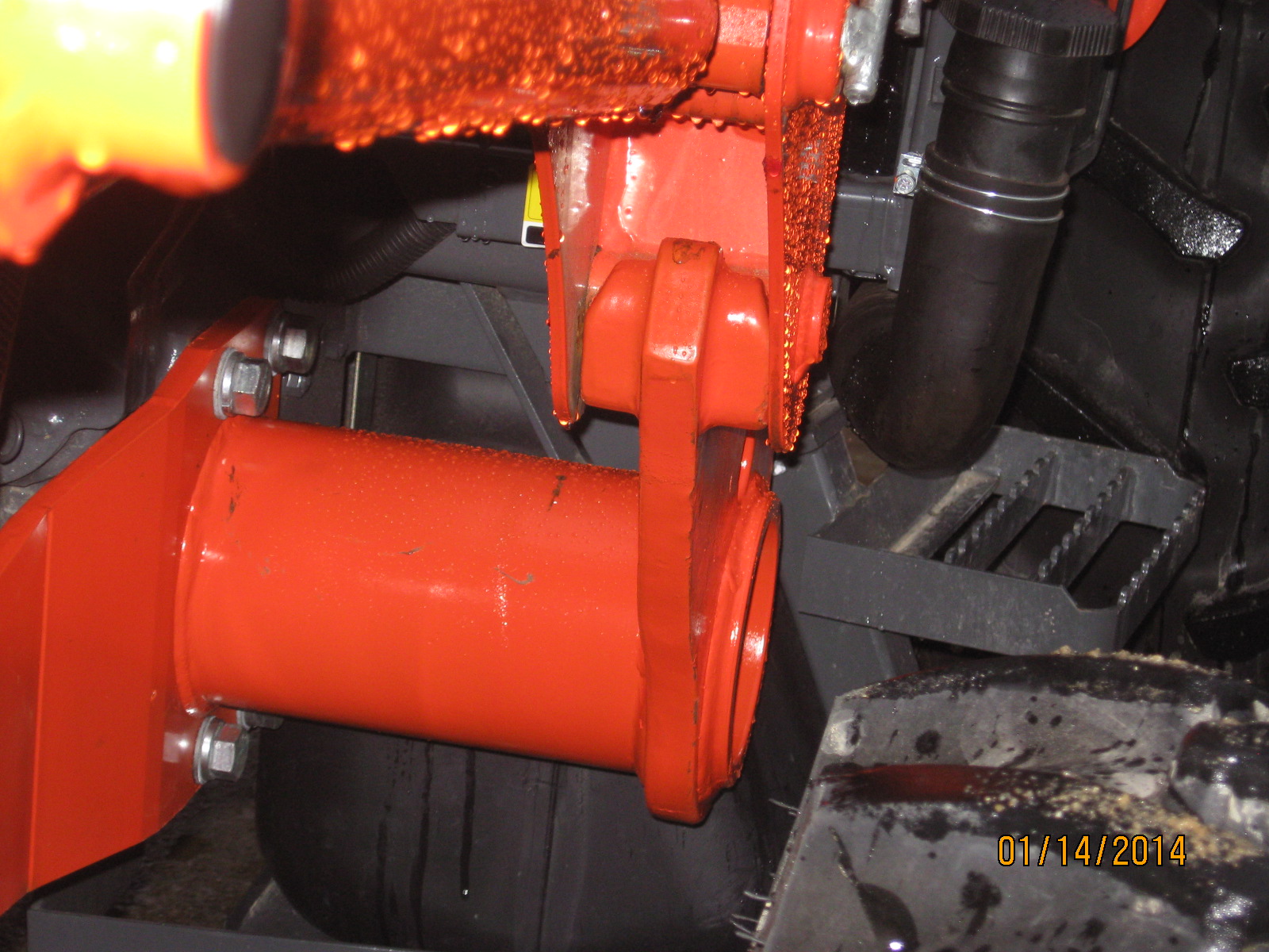

OK, my M6040 is repaired, painted and back in business. We removed the damaged bracket and heated and bent it back where it belonged. Installed it to make sure it fit and worked. Removed it again and scraped, primed and painted it. Re-installed and did the fail safe as designed by OVRSZD (see link) "http://www.tractorbynet.com/forums/owning-operating/300460-qa-loader-frame-latch-pin.html" It was a bit more complicated than I planned but I liked the idea.
I also replaced one hose that was crushed in the failure. It wasn't leaking but I didn't want to wait for it to fail on a Saturday afternoon when I can't get a new hose made. Total cost of repairs about $600 and 11 man hours.

You don't owe me any thanks. Glad we could all brainstorm and offer some very easy, quick solutions. This kind of modification/fix offers little reward. Us that use it will never know how many times it saves us from such a damaging failure.
Again, glad to see you got it going. Thanks for posting the pics and describing the process of repair.

That took some serious heat to straighten! I don't think my torch set would have been up to the task.
