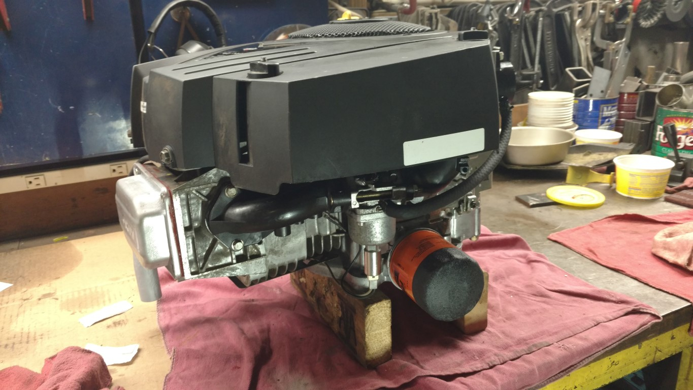

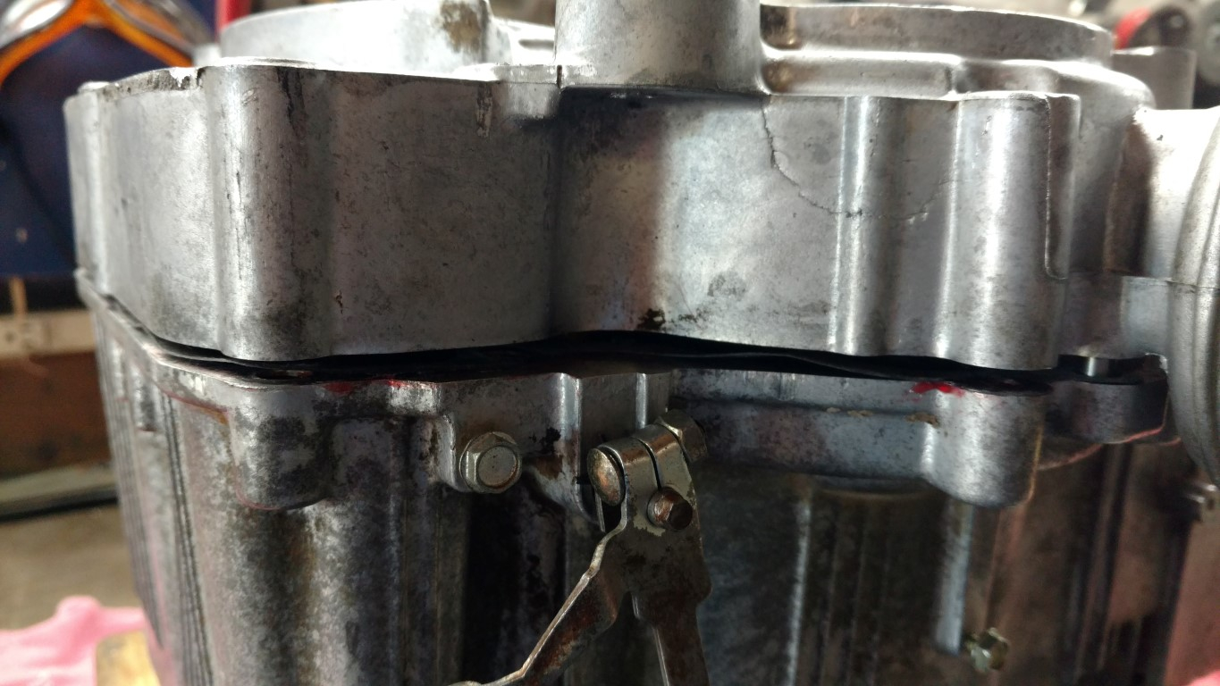

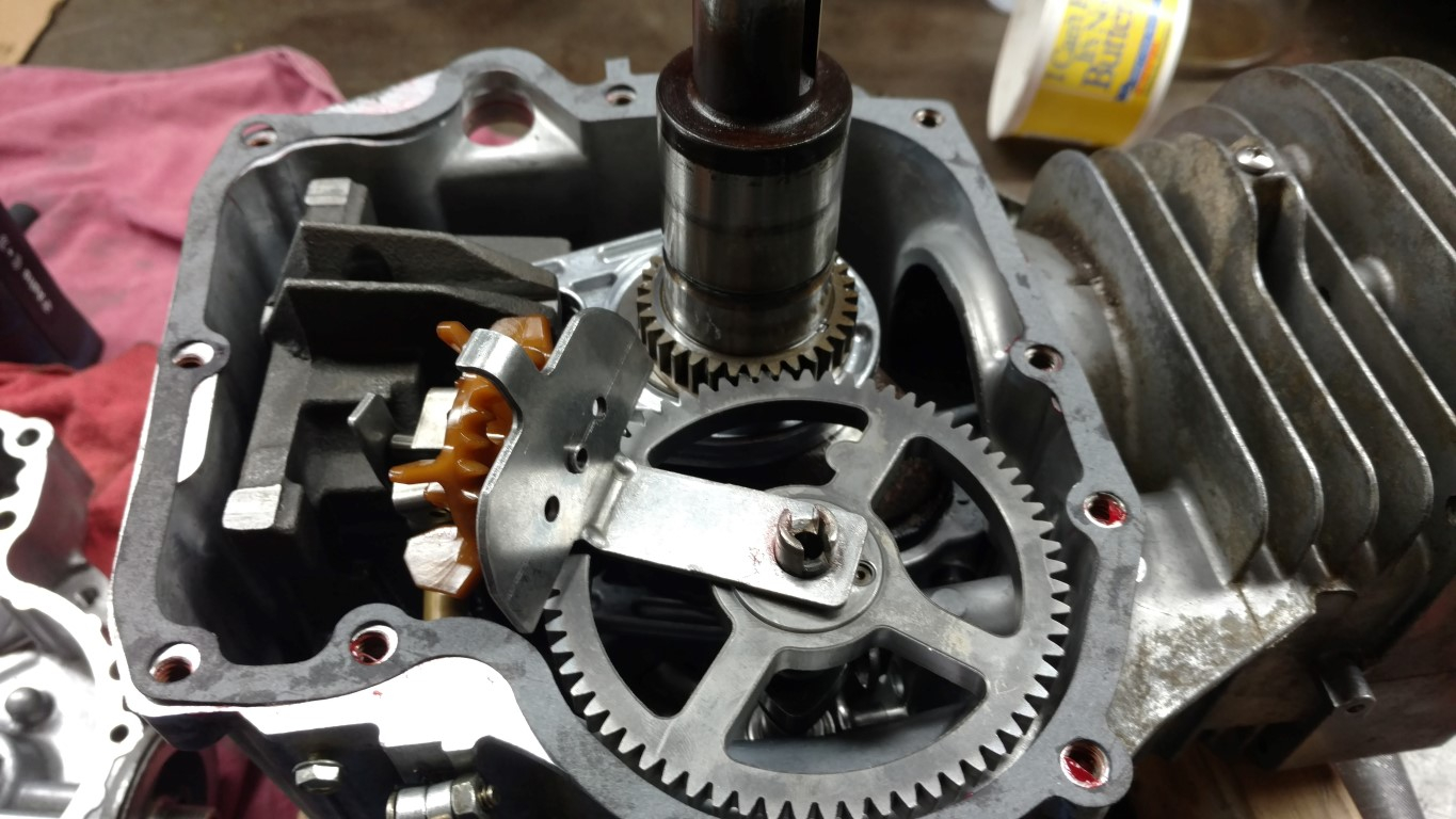

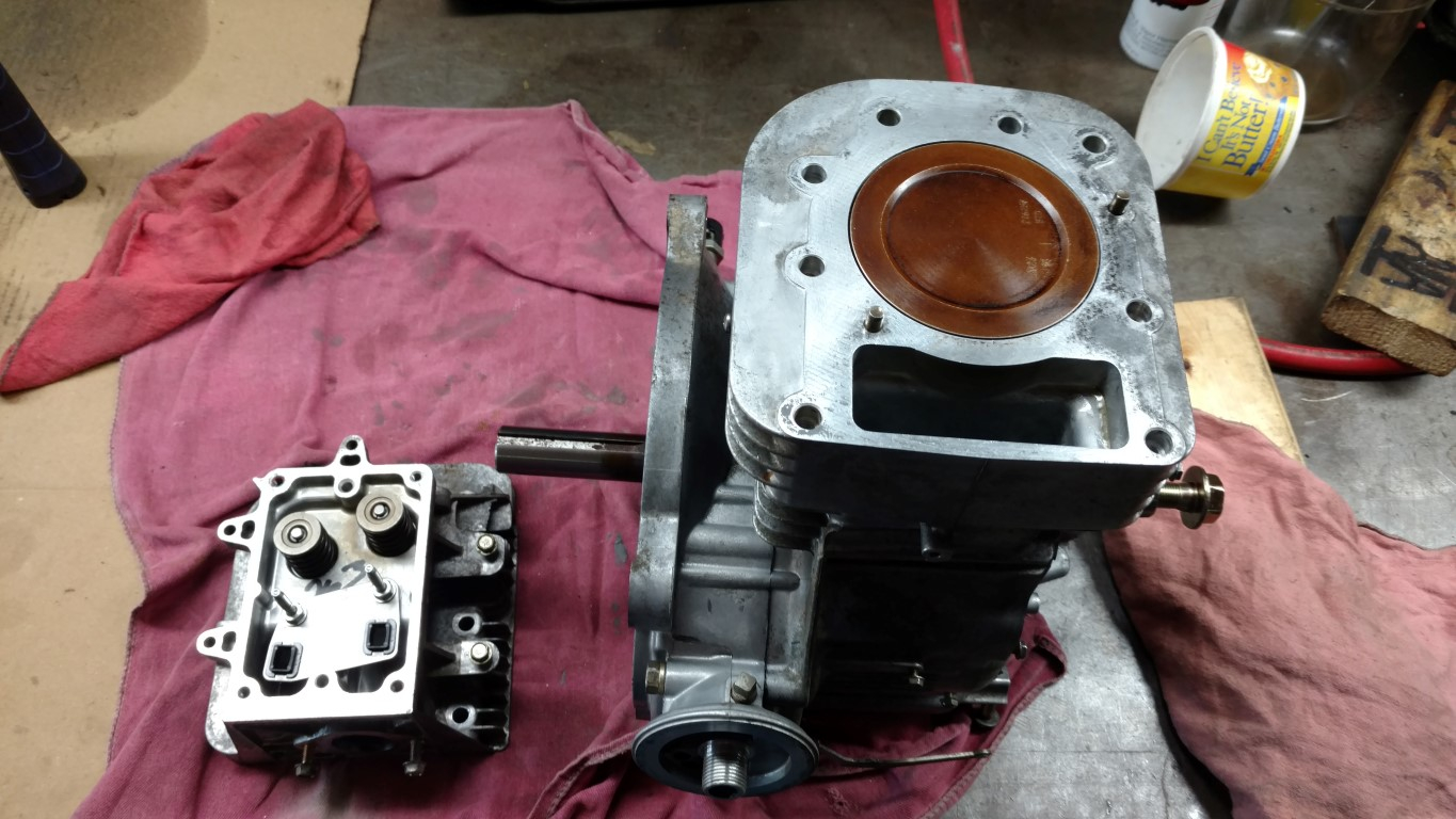

Started putting the engine back together today. Put new seals in the crankcase and cover, put the crank in, installed the rod and piston with new rings, and torqued the rod bolts up. Then I put in the lifters, cam, and governor assembly. Installed the case gasket, made sure everything was in place and dropped the cover on. Had to use a small screwdriver to get the seal lip over the crank PTO end running surface and the cover dropped on, almost all the way. Lacked about 1/8" of going on all the way. Tapped on it with a soft hammer, but something was hanging up near the middle of the cover. Took it back off and put it back on at least a dozen times and it still stopped an 1/8" of seating.
Got interrupted by a friend with a problem with some blind nuts on the firewall of his model airplane. Seems he got some epoxy in the threads when he fuel-proofed the engine compartment. I was able to use a 6-32 tap, a Lisle tap adapter and a 1/4" drive handle to get in and clean them out.
Back to the engine, I was showing him how the cover was giving me a problem, but when I put it back on, it dropped right into place, tight against the crankcase. I have no idea was was hanging up, but it is on and bolted up now, and everything is free and working.
I used a block of granite I have with a piece of 150 grit sandpaper and got the sealing surface looking pretty good. Then I pulled the valves, cleaned them up and lapped them in, put on a new intake stem seal and put it all back together.
By then it was 6:00 and my daughter and grandkids were going to The Hacienda in town for some good Mexican food, so I closed up shop and headed to the house to get cleaned up.

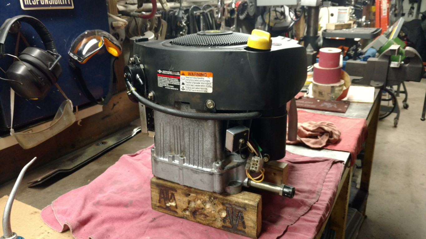

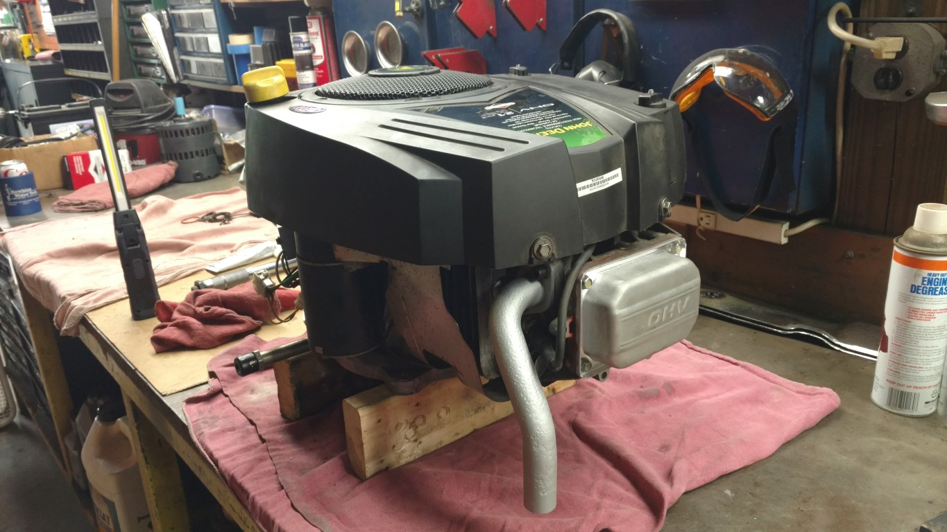

Got the engine completely assembled this afternoon. Went pretty smooth except for forgetting to put a baffle on the top of the crankcase before I put the flywheel on, so I had to pull it again. No big deal, I know exactly which puller parts to use now, was a 15 minute job. Also had the external governor lever on backwards, but that was easy to correct. I have to get an oil filter and oil, as I forgot to get them when I picked up the other parts.
A friend is coming over tomorrow to give me a hand setting it on the tractor, so I should have it all done in the afternoon, again.

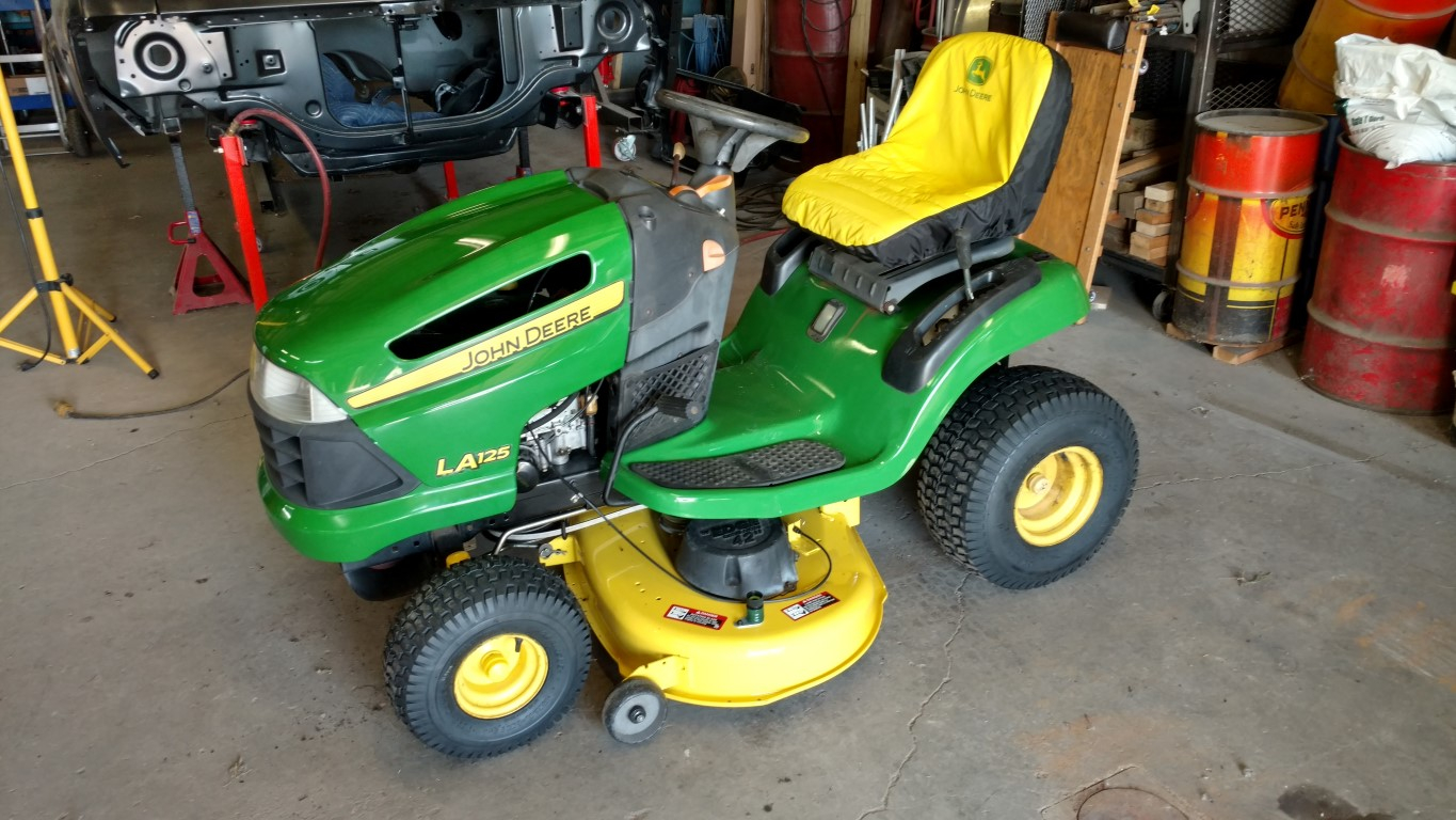

After a lot of thought and rumination, yes I did. I gave it a good coat of Permatex Copper Coat gasket sealer on each side of the gasket. I figured that if it doesn't hold, it's not a big job to pull it off and replace it again, now that I know how to do it without removing the engine.
And I did get then engine installed and started up today. It runs like a top, no blow-by to speak of and only one oil leak.
Apparently the because problem I had with the bottom cover going on, and taking it on and off about a dozen times ruined the lower crank oil seal. So, I think I can raise the front of the tractor, remove the drive pulley and replace the seal without too much difficulty. I hope. We'll see.
But it does really run nice and smoothly.
Since I wasn't able to take it back to my niece's house, I loaded the BX up and went over and mowed her lawn, it was getting pretty shaggy. The BX with the new Oregon Gator blades make short work of it.

Picked up a new seal and some oil at the JD dealer today, got the new crank seal installed and everything put back together. Ran it for 15 minutes, and no leaks!
It's going back home tomorrow, finally.

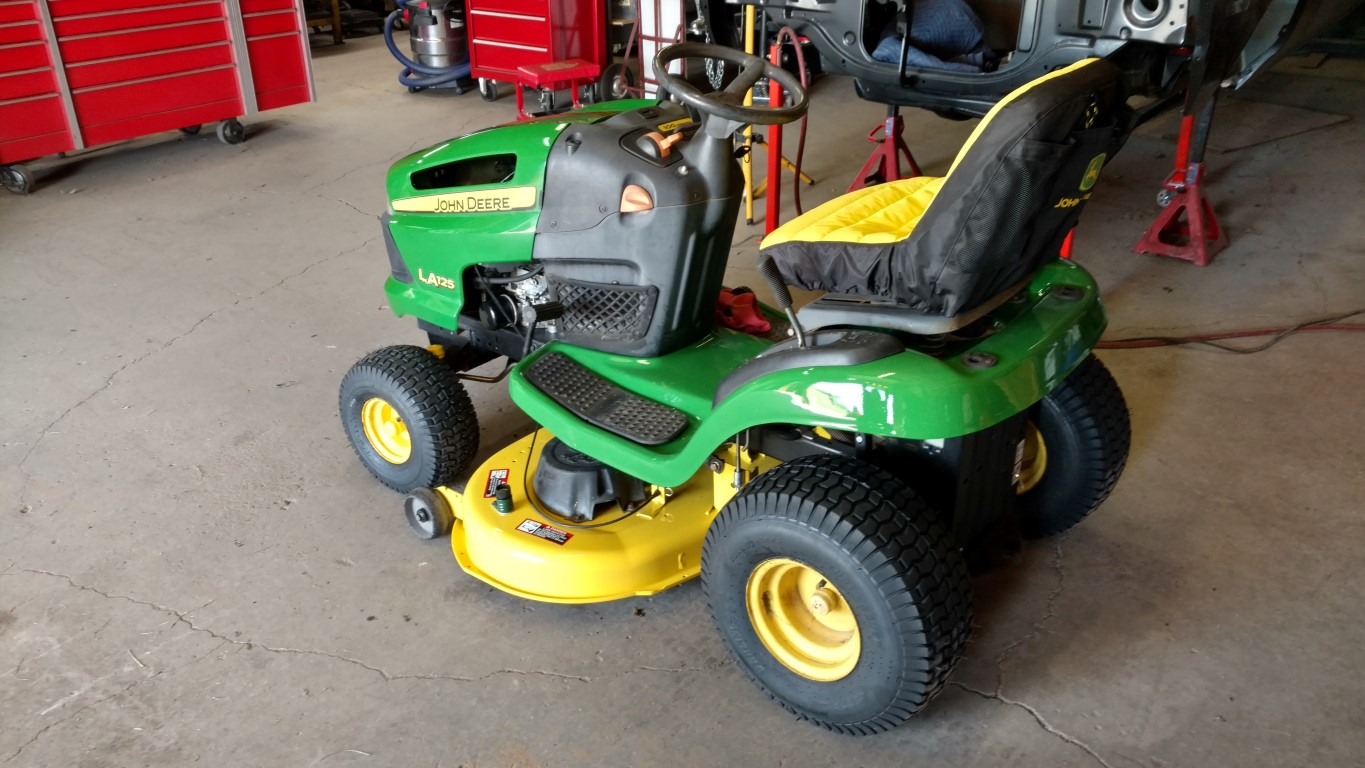

Here's a picture of it finished up, before I had to pull the engine. A friend buffed out the hood, and it looked as good as new.
