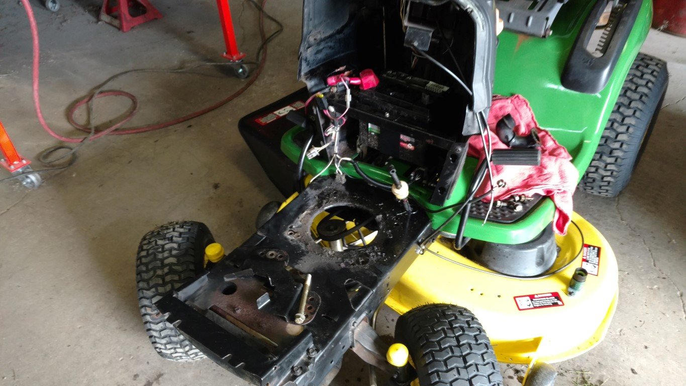

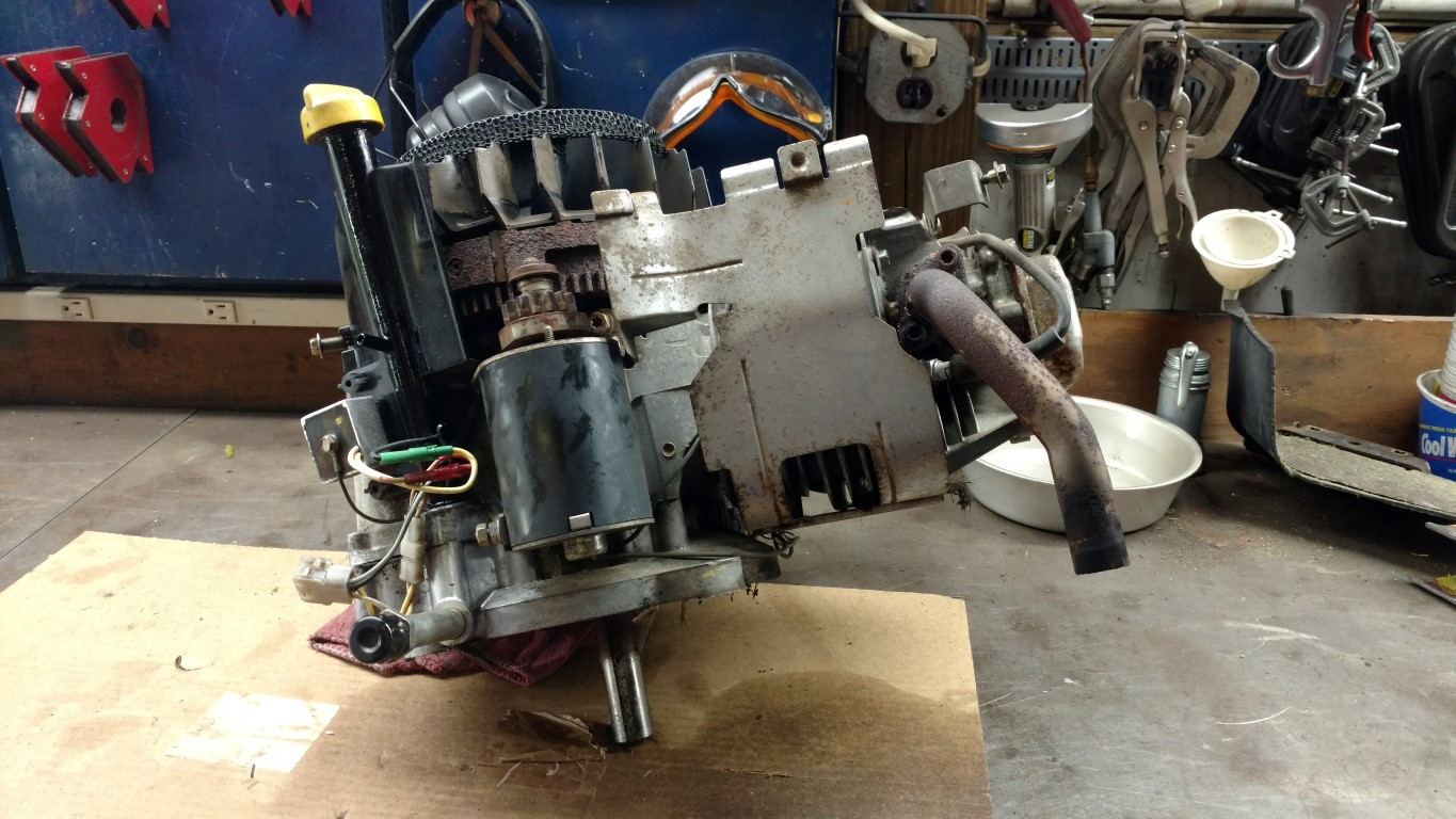

Well, just when I thought I had the mower finished up, I started it up and mowed a patch in front of the shop to see how it ran and mowed. At first it seemed okay, but then after a couple of minutes it started smoking blue smoke out the exhaust and missing sometimes.
I pulled it back into the shop and noticed a lot of oil on the frame behind the engine and running down onto the mower deck. When I pulled the dipstick, oil and vapor sprayed out all over because the was so much blowby in the crankcase.
Well, *****!
After I shut it down and pulled the dipstick again, the oil on it was already black as coal. Not good. 🙁
So, after mulling over what to do, I figured the engine had to come off and be checked out. I HOPE that a new set of rings, maybe a piston, and honing out the
cylinder will take care of it, but until I get it all apart, it's hard to say.
It was easy to get the engine out, only took about a half hour. Four bolts hold it to the frame, an electrical connector, starter cable, throttle cable, fuel line, remove the mower belt and finally take the bolt out of the drive pulley on the bottom and it slid right off the crankshaft. It not even that heavy, so I lugged it over and set it on the bench. Probably pull it apart tomorrow and see shat the verdict it.

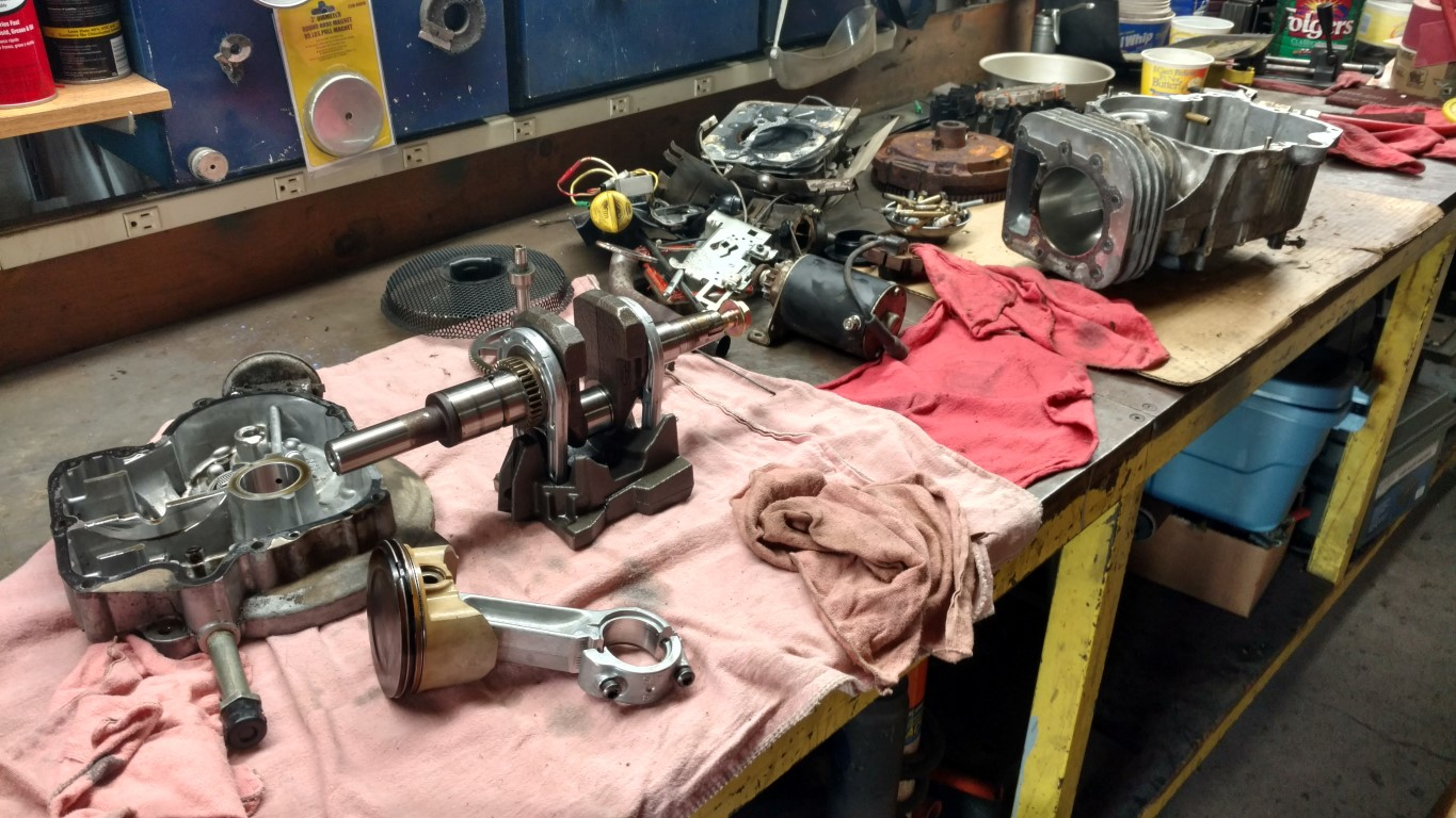

Hi BX
Don't rush to rip into your engine with rings etc. The oil on the frame and blow-by are the classic symptoms of a blown head gasket on that engine.
No biggie and an easy repair.
Notice that the oil on the frame (Chassis) will be coming from the breather gauze in the vacuum fuel pump in the Left Rear corner of the cowling?
That's the clue that the head gasket has blown between the cylinder and the pushrod tunnel cavity.
You'll see the blown evidence at the 3-o'clock position on the cylinder when you remove the cylinder head.
It's the common fault on this B&S engine model.
No need to open the crankcase. Just change the engine oil twice to flush it after you install a new head gasket.

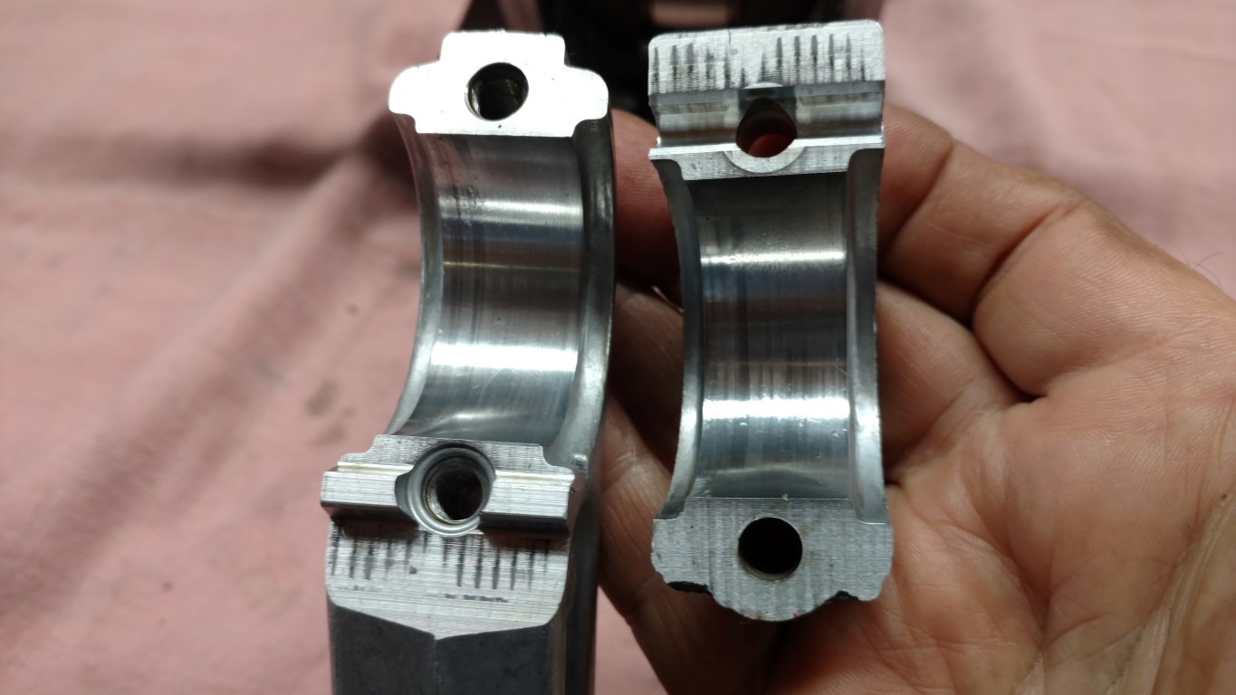

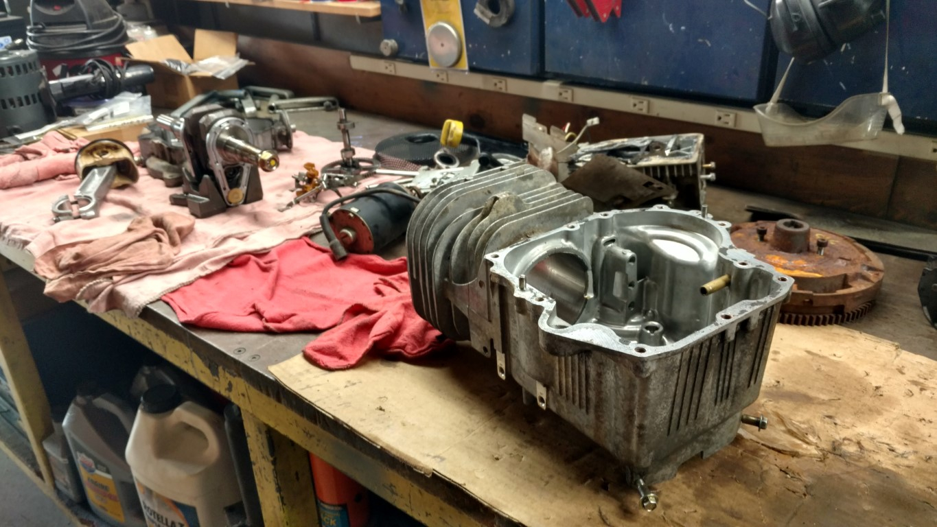

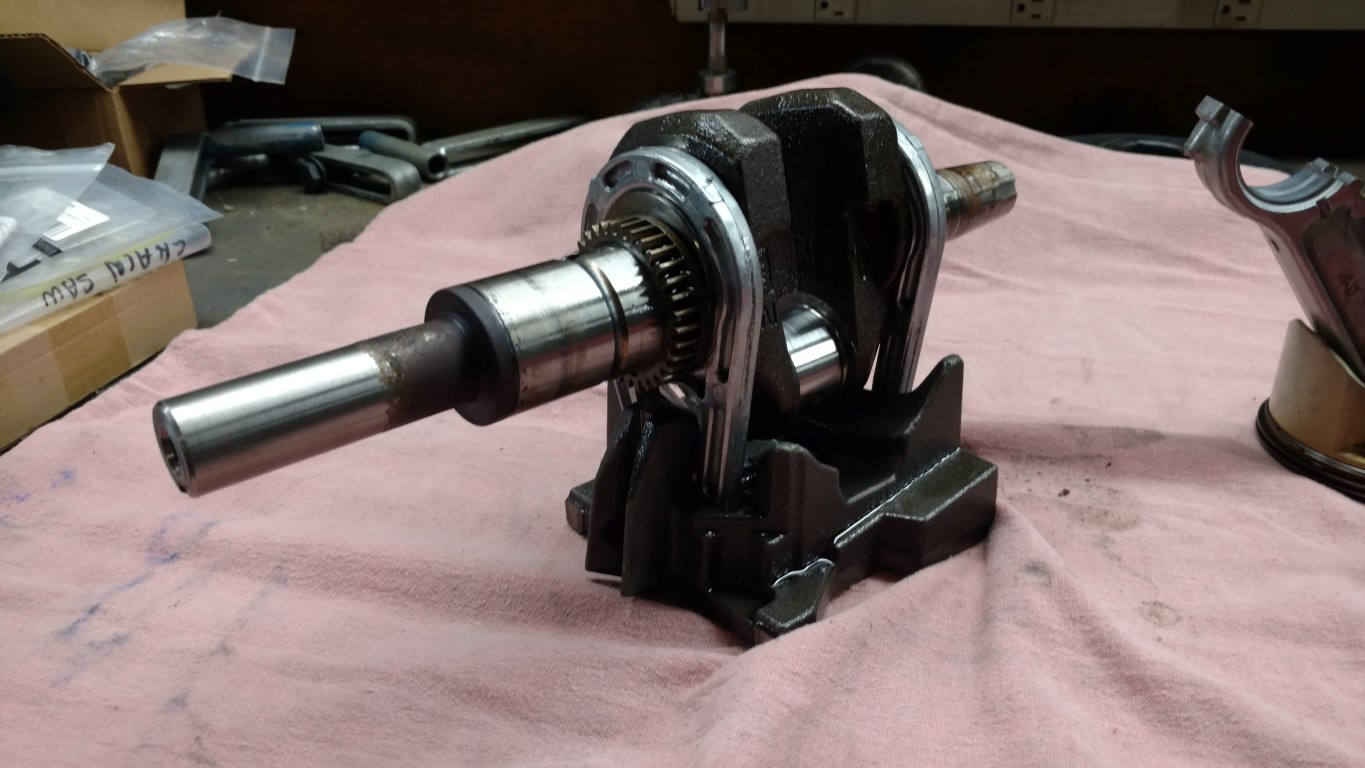

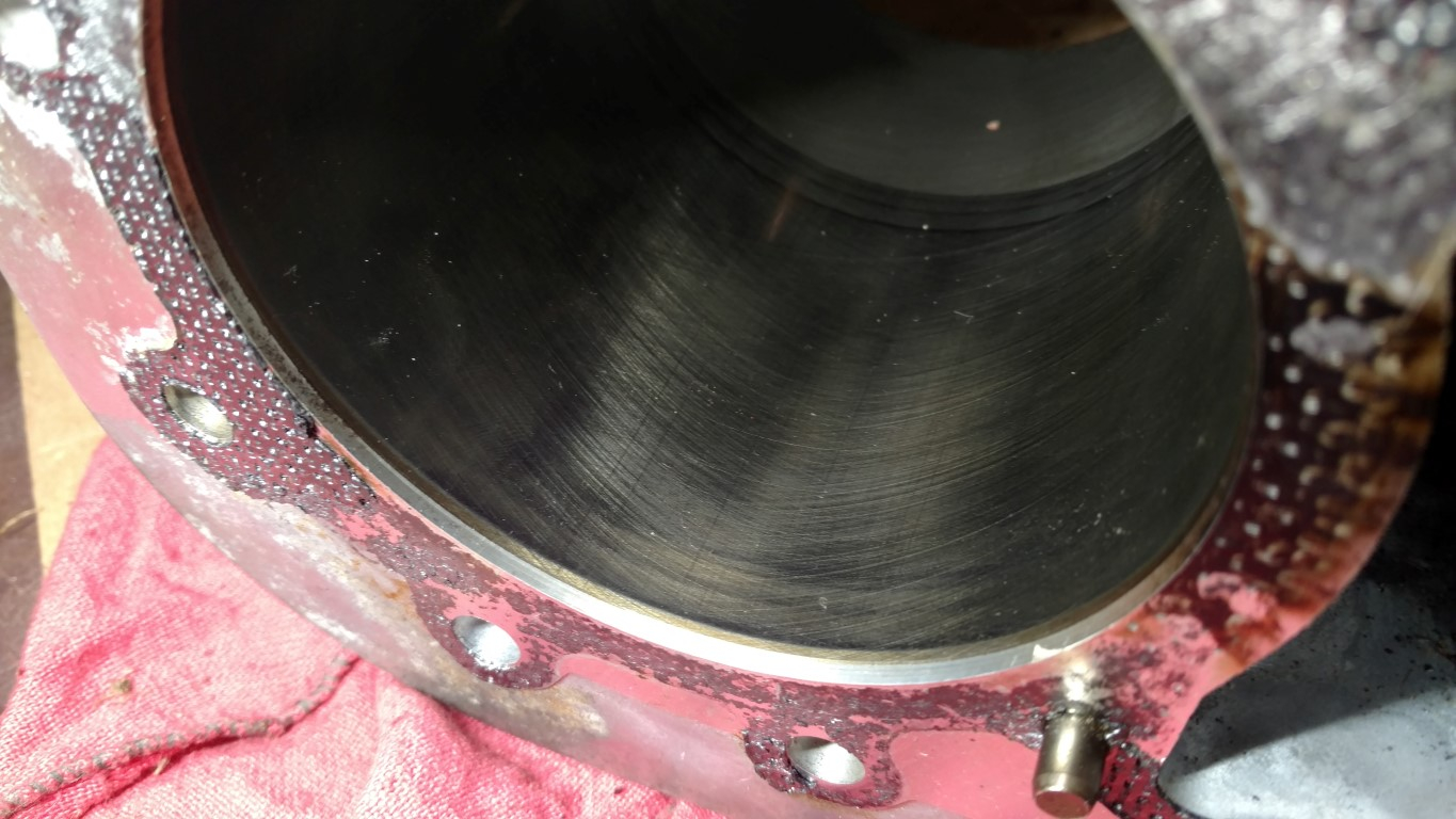

Too late! I pulled the engine apart this afternoon. The head gasket looked okay, I didn't see any area that looked blown, but I guess it could have seen leaking. I did find the two compression ring gaps were within 1/2 inch of each other and the oil ring had virtually no tension on it, which is why there was a lot of oil in the cylinder. The bore look very good, plenty of cross hatch still visible, Piston looks very good, as does to connecting rod and crank journal.
I ordered a set of rings and a gasket and seal kit this afternoon from my local JD dealer, so I should have them early next week. I spent a couple of hours cleaning up the crankcase, bottom cover and cylinder head. Also blasted and painted the rocker cover and a couple other parts that were rather rusty. Will probably get the rest of the parts all cleaned up tomorrow.
I had one small screw that holds the cooling baffle to the the bottom of the cylinder, snap off, despite tapping on it with a hammer and gently working it back and forth, so I'll work on getting that out tomorrow also.
I was surprised when I got the bottom cover off the engine and saw the huge balance weight attached the the crank. I've never seen one of those before.
I'll knock the glaze off the cylinder wall and get a nice new crosshatch in it so it'll be ready to reassemble when I get the parts.
Edit: On examination of pictures I took, it does look like the head gasket was blown like you suggested. Oh well, at least now I know it will be right, and like I said, there was a lot of oil in the cylinder when I took the head off.

   / LA125 Overhaul #30
So, is there a tip to keep it from blowing again?
No, not really.
The 'tip' is to recognise when it is blowing.
In your 6th photo of the cylinder cross-hatching you can see the blown area right there at 3-o'clock between the cylinder and the pushrod cavity.
Understand that this is a design issue where there is no head bolt in that area at all so clamping pressure on the gasket is reliant upon the head bolts at 1 o'clock and 5 o'clock.
That's a lot to ask for a simple compound head gasket to deal with. Inevitably, yes, it will happen again.
The telltale indication of trouble is when you begin to see oil on the area around the vacuum fuel pump at the rear of the engine cowl. In addition to the crankcase breather the additional excess pressure in the crankcase is relieved by blowing through the pulse line to the fuel pump. Eventually you begin to see oil on the chassis in the area near your left foot. (Below the fuel pump)
At that point, where oil is on the chassis you know your head gasket is a goner.
The upside is that it's a relatively simple repair in-situ. An hour, (in the field even) , at most.
The downside is that if you miss the oil-on-chassis-signal (Red Alert!) you will lose the engine through "insufficient lubrication".
Easy monitoring involves checking the dipstick every time before mowing. It's that simple.
