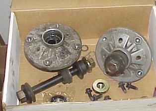

I have a 2008 LA150 with 52" deck. About 110 hours on deck. Of the three spindle bearings, 1 is very rough, 1 is ok, and the last one is perfect. The idlers and belt are all good.
I only clean with air, but I greased only about twice a season. In reading this thread I see I should have greesed more often. The bad part about my deck is that you have to replace the whole spindle, and not just the bearing.
   / LA145 48" Deck is high maintenance #43
If your blade spindle assemblies look like ( or similar ) to this, the bearings are all that need replaced unless there is damage to the housing that contains them or the shaft.
Anyone with just a little mechanical ability, a few simple tools and the will to do his/her own work can do this repair. I've found foreign bearings for as little as $1.78 at the farmers Co-Op and for as much as $15.00 for Fafnir that are more than likely foreign made also.
Yes, those look like mine. One of the two bearings is replaceable, but then I read somewhere about how to pound the other one out, and press a new one in. Matching up a new bearing shouldn't be tough (and may even be the same size as the replaceable one I can buy from JD). When I get into this project I will definately see about doing what you recommend.
Thx for the comment!
