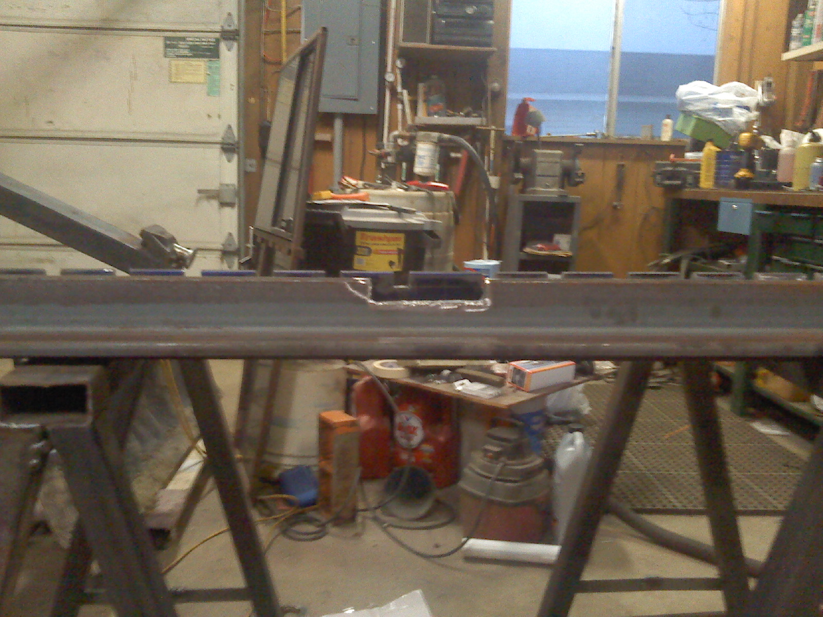

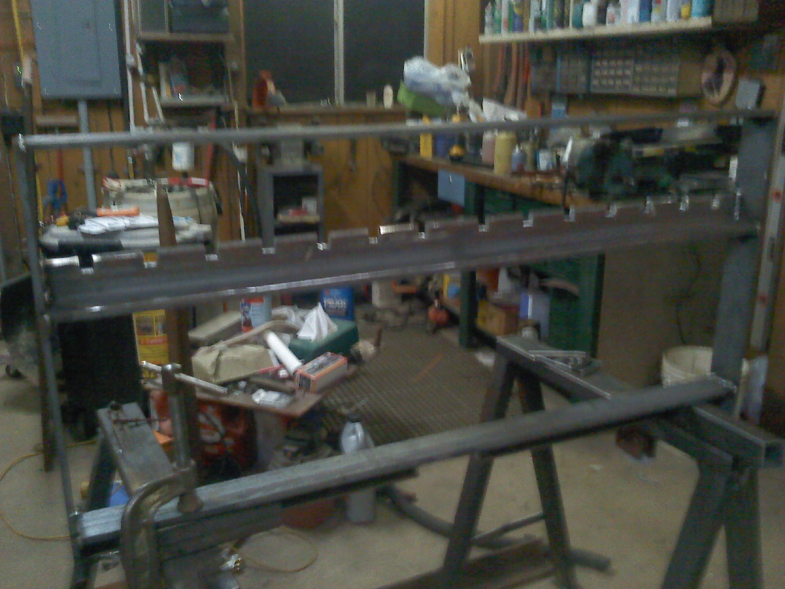

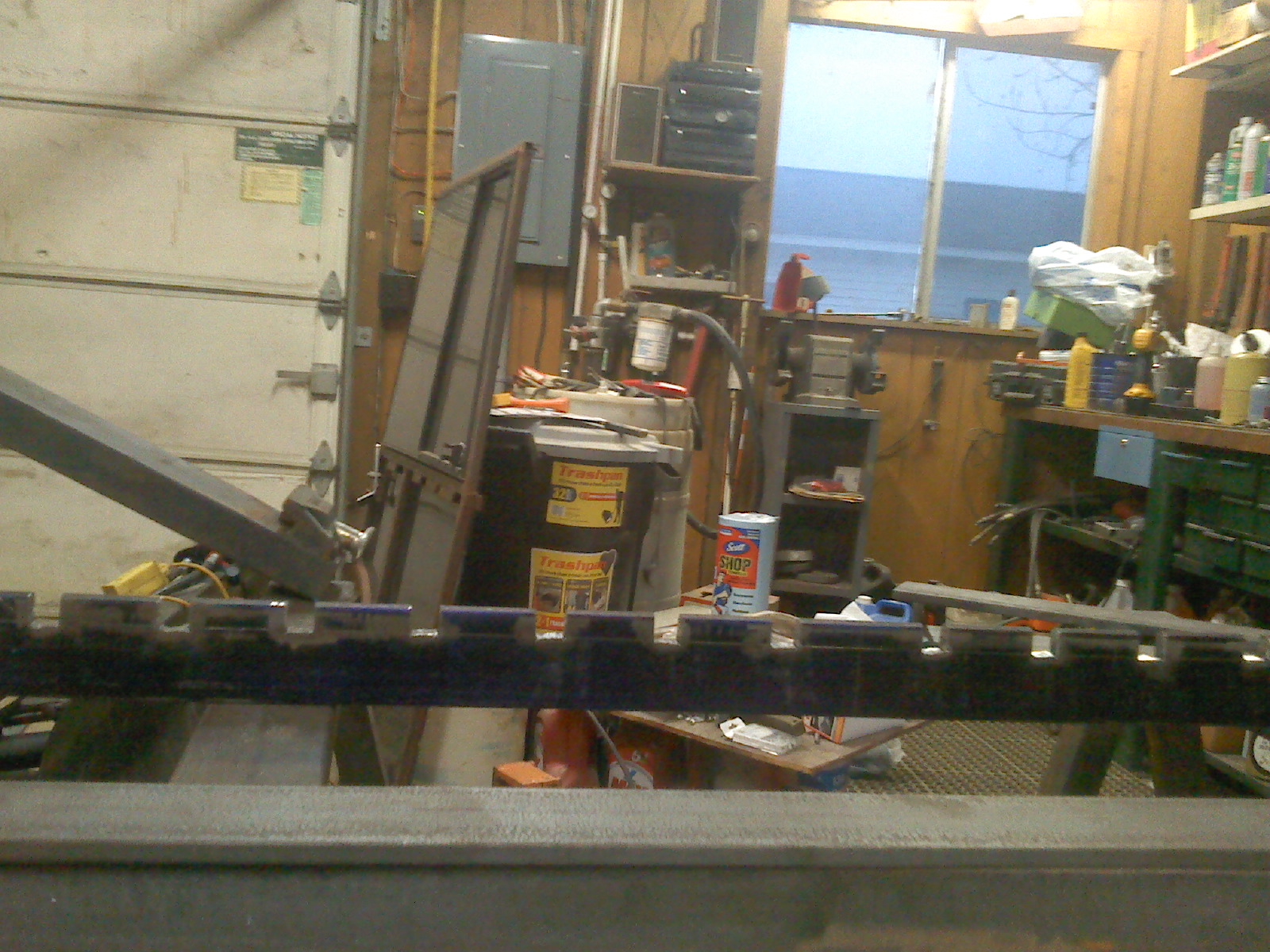

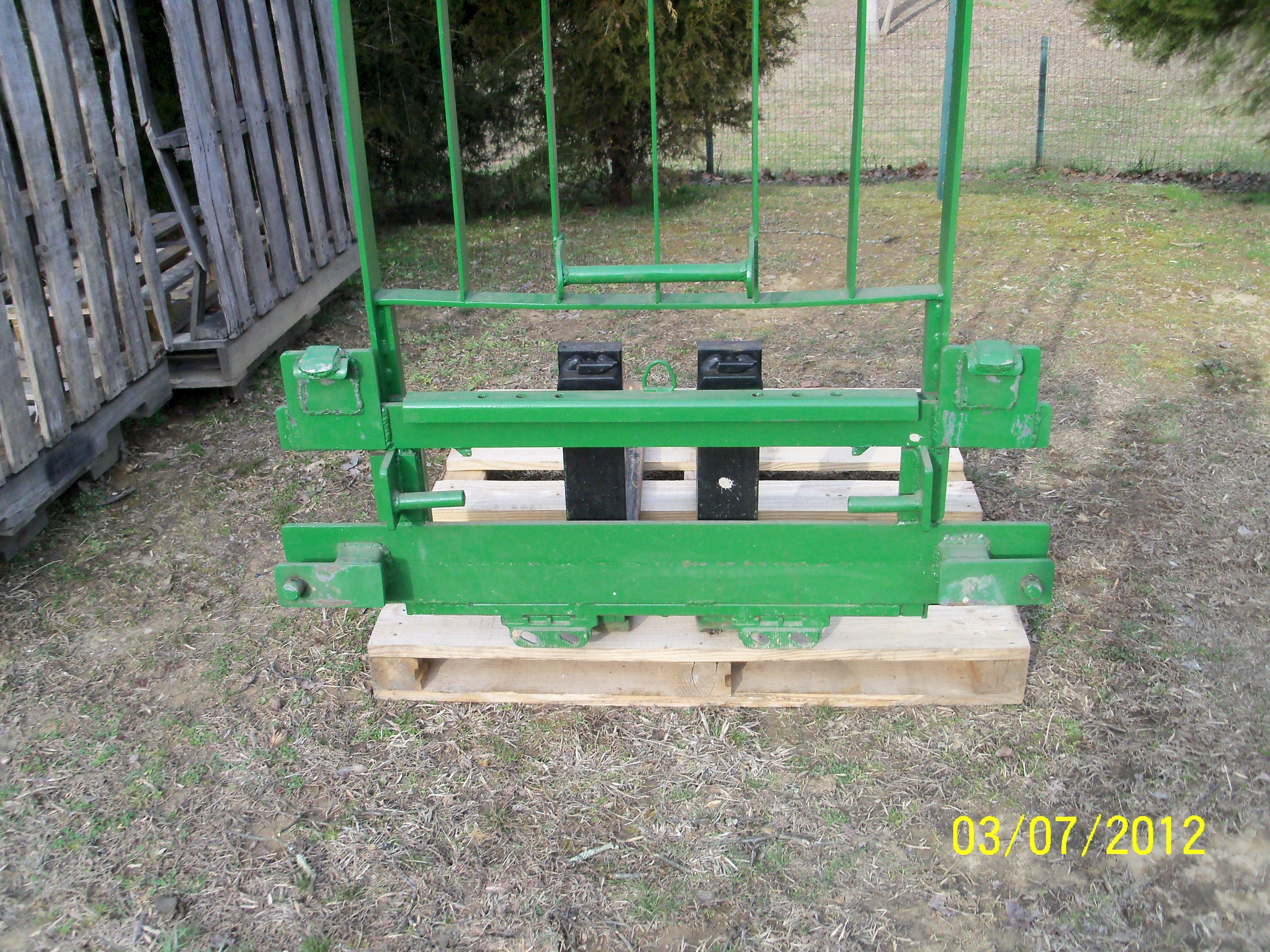

You know why I made the QH for the loader don't you? Yep next on the agenda is a set of FEL forks! I got a set of 42" forks last summer from our jitney repair man for scrap price $.15 a lb. x 80 lbs ea = $24.00! I got started on them tonight. Sorry no pics (phone was on charge!) I am using 2.5"x2.5"x.5" angle for the top and bottom rail that the forks slide on with 2.5"x.375" flat bar for the uprights. I notched the top bar from the center to the outside edge 2.50" on center, 7 notches each side. I made a 4" notch in the bottom center to facilitate removal. That's about all I got done tonight. I will post pics tomorrow.
So here are the picks from last night
The last pic is of the first project a set of steel saw horses I made because I build heavy things and my plastic horses don't hold up.

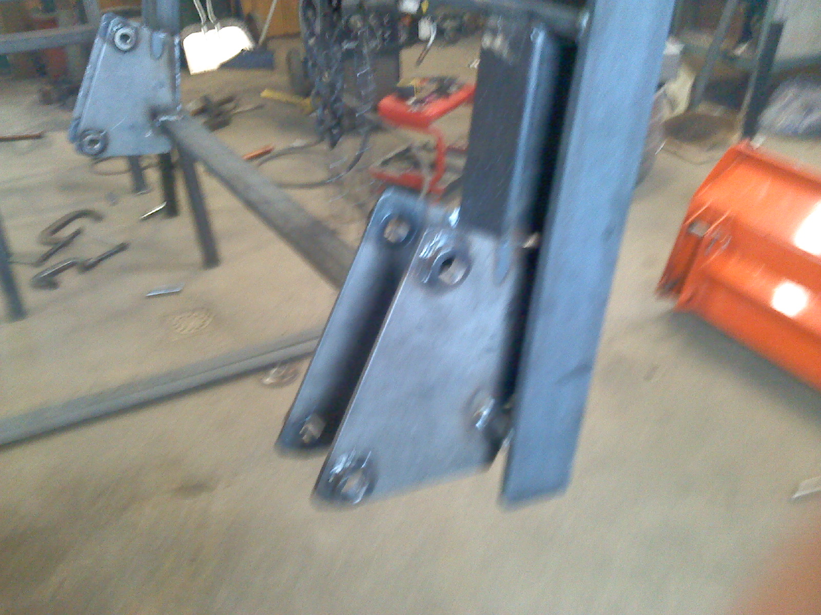

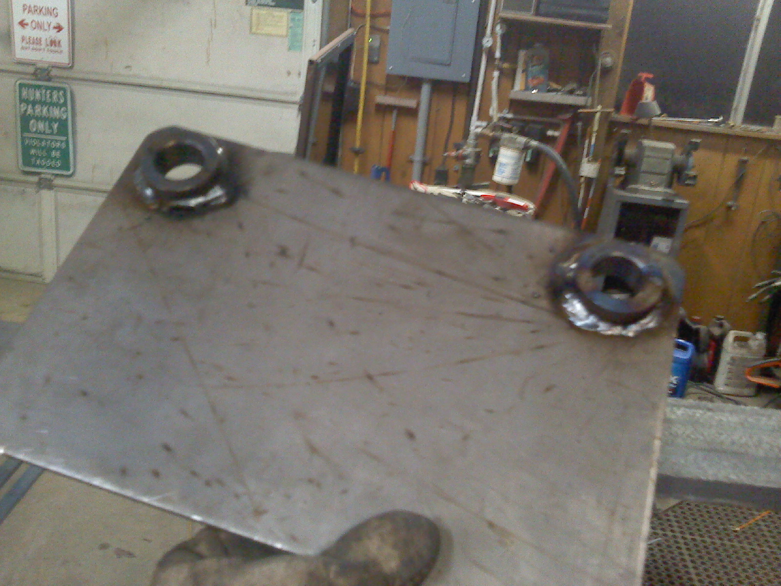

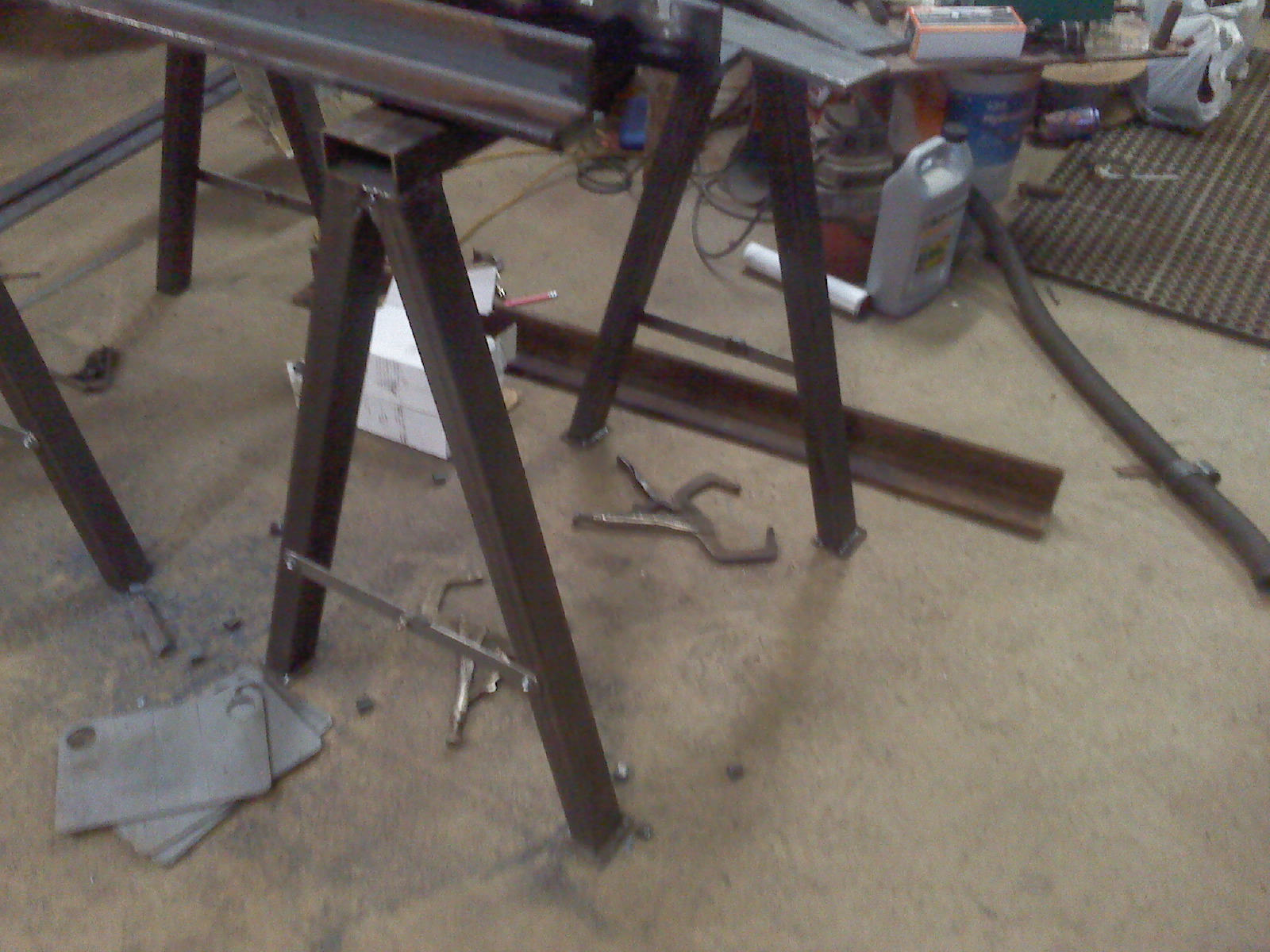

I got the sides welded to the cross pieces and the bushings welded to the mount plates tonight.
Note to all: When you are welding heavy objects on horses don't be pushing and shoving the object so much it falls off the horses!!! OUCH it fell and whacked my right arm between the fork and saw horse! I should have tacked it to the horse. My arm is all black and blue and it took my breath away it hurt so bad! :(
Notice the "clamp holding the frame to the horse? Hind sight is 20/20!!!!! :thumbsup:

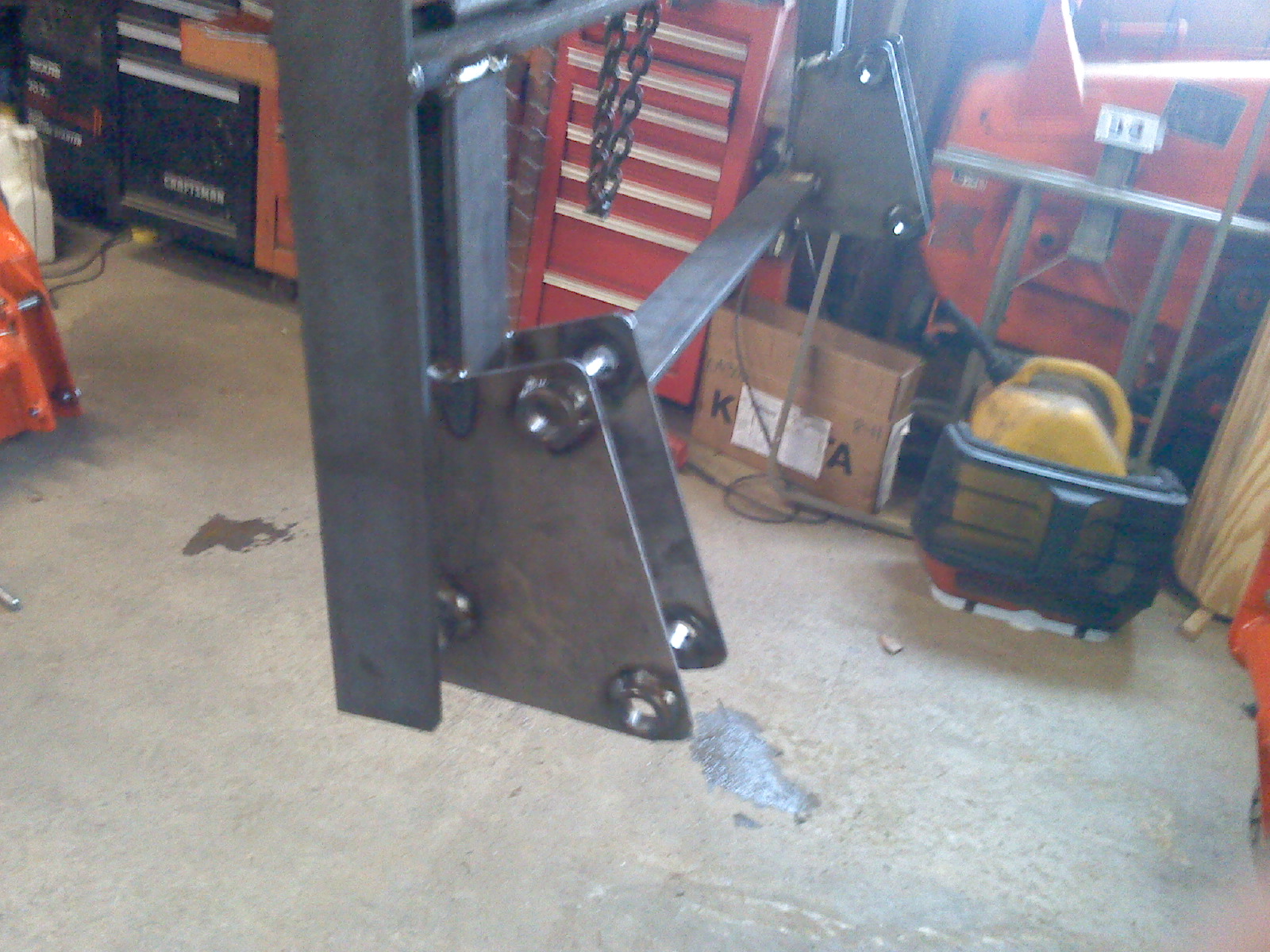

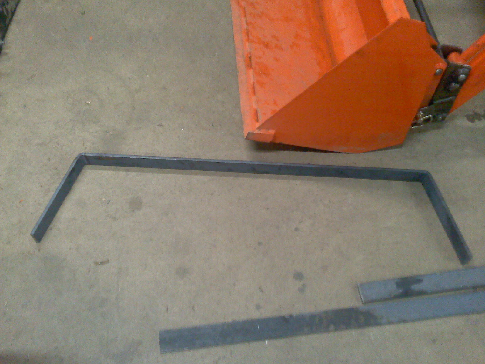

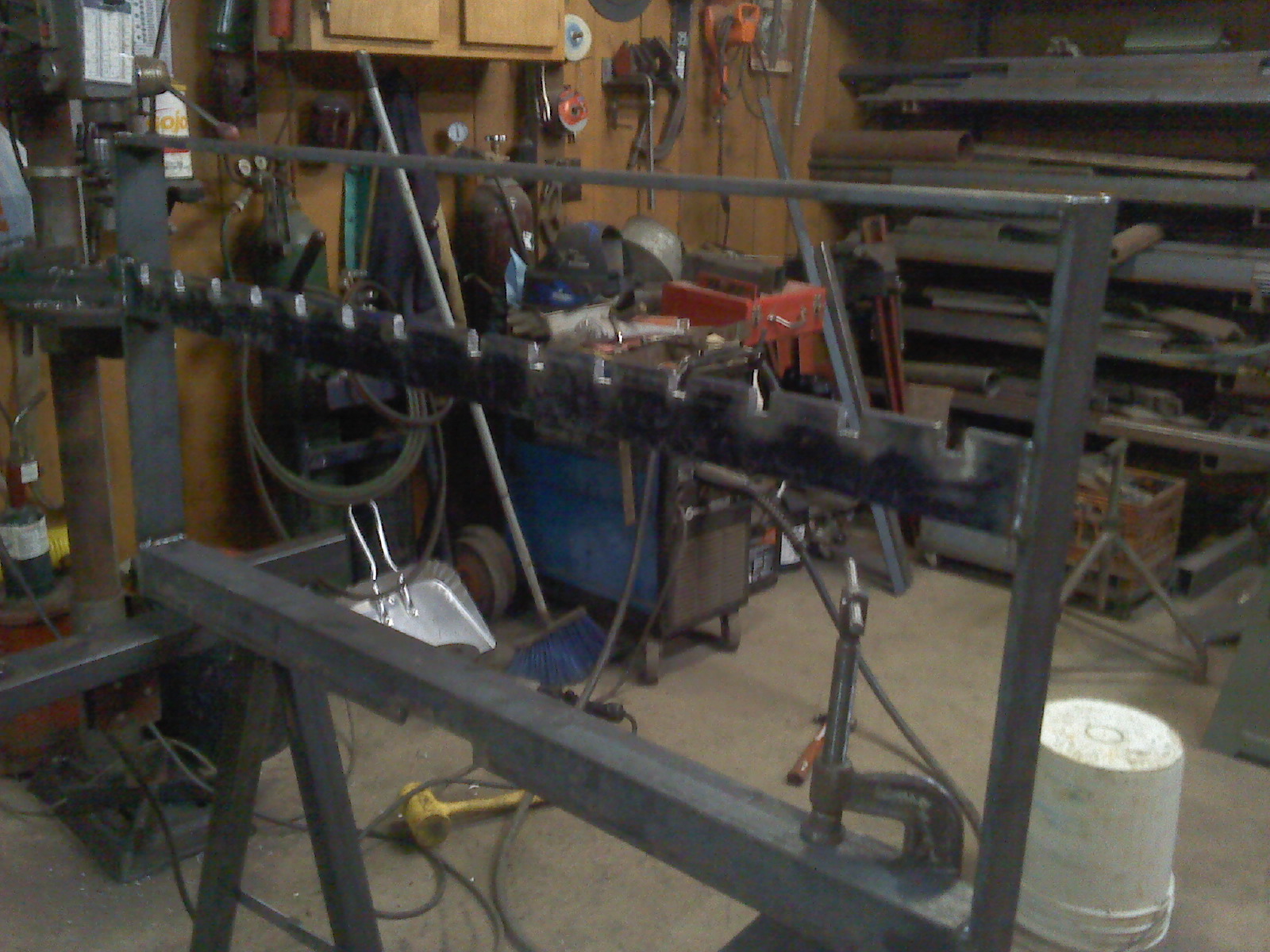

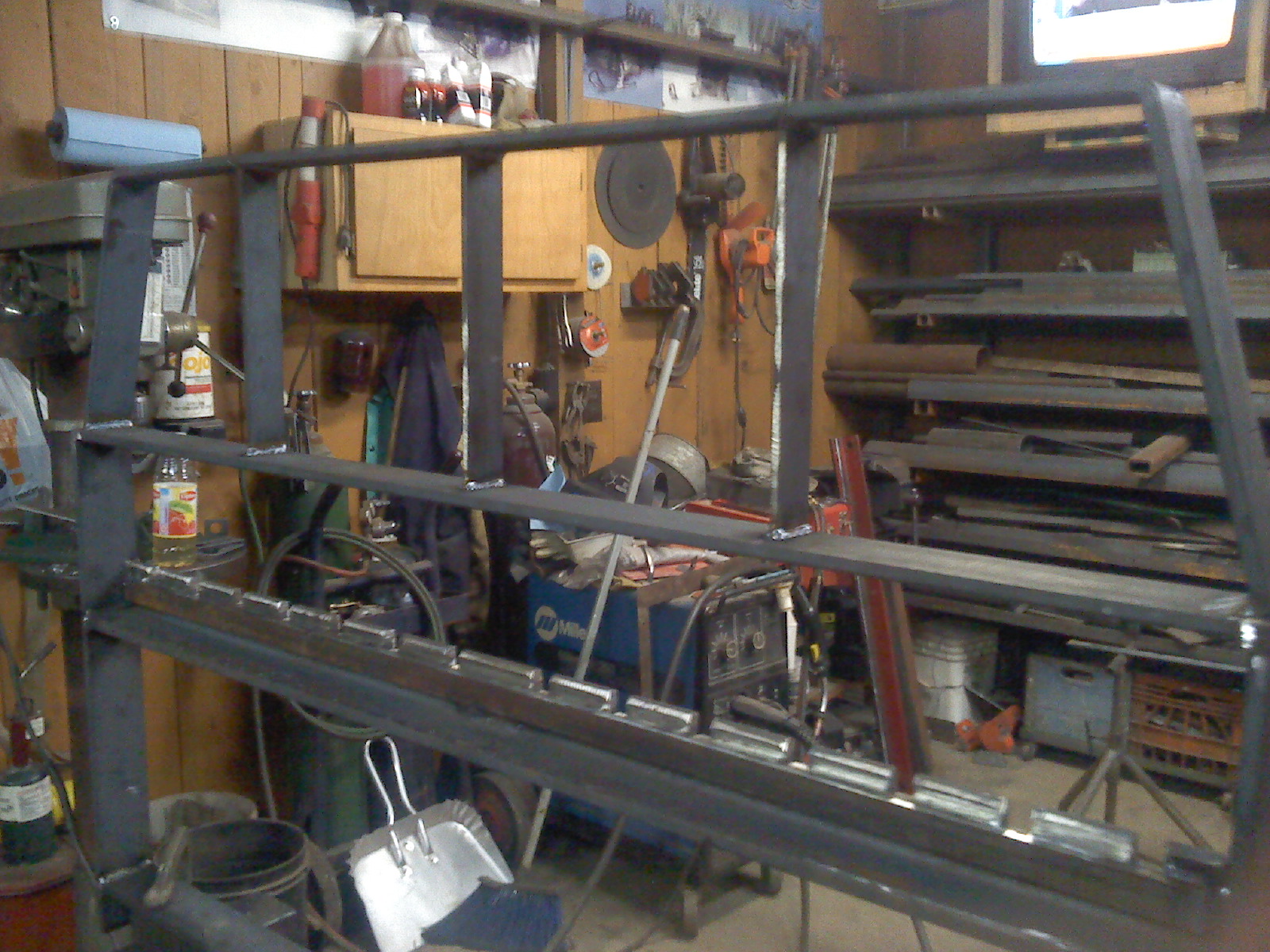

I got some more done on the forks tonight.
The first thing I did was to weld a 1/2x7/8 bar on the backside of the top rail for the forks to slide on. Pic 1

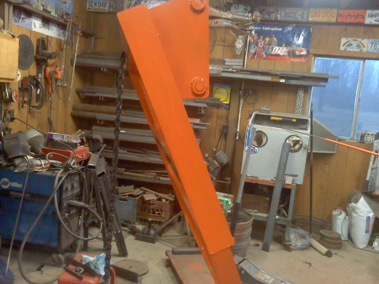

I decided to make the headache guard match the brush guard on the tractor. I used some 3/8x2" bar to make the frame. I heated it with the torch and bent it in a vise. I bent it to 73* 10"s from the end to match the angle and height of the brush guard. pic 2
Then made 3 braces for it out of 1/4x2" and welded it all together. pics 3 and 4
The last thing I did was to fit the pieces of 1 1/2x2 1/2x1/8 wall rectangle tube for the mount and called it a night. Tomorrow I should be able to get it finished.

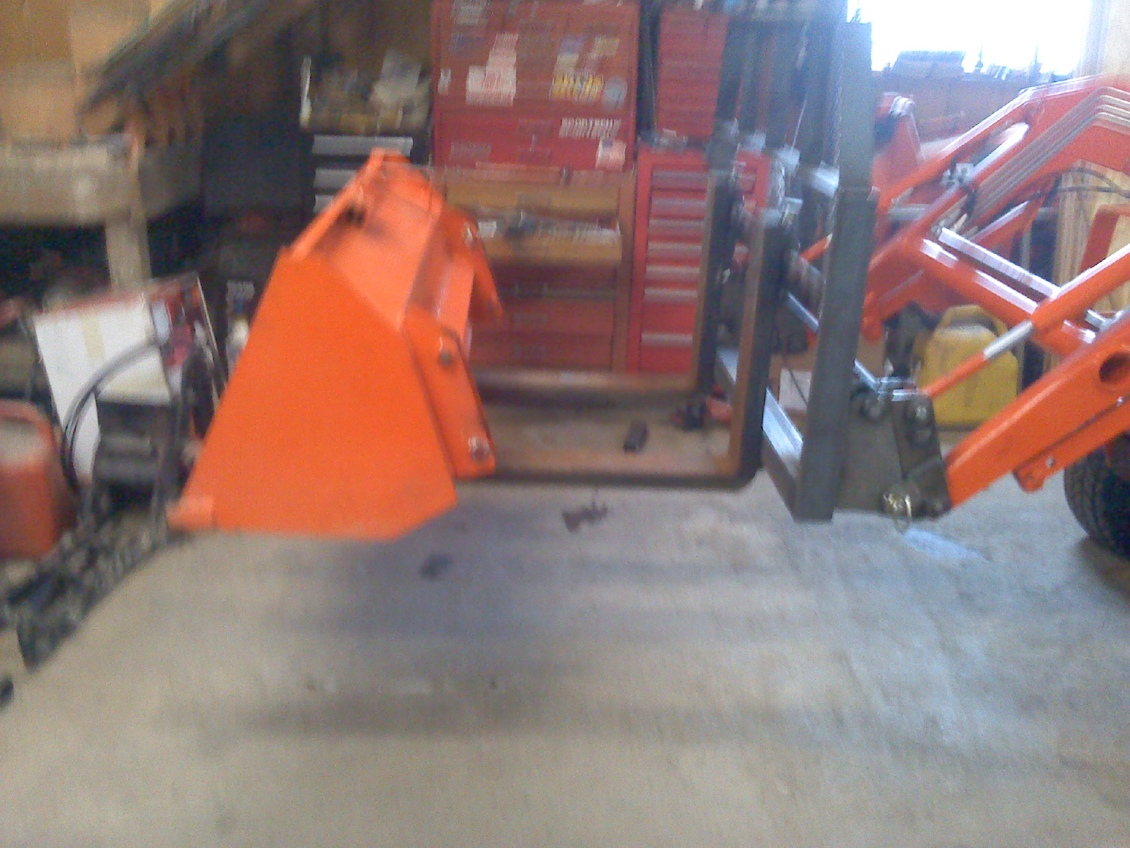

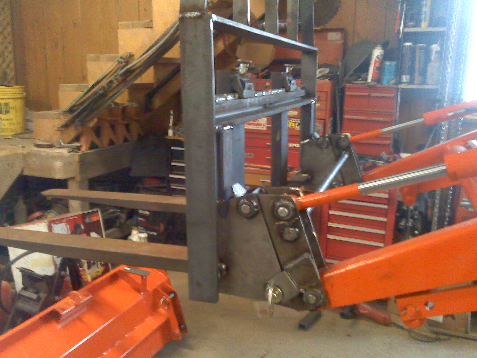

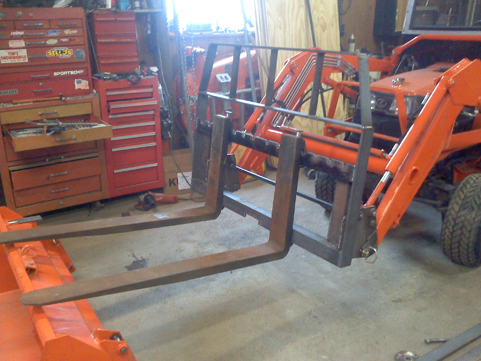

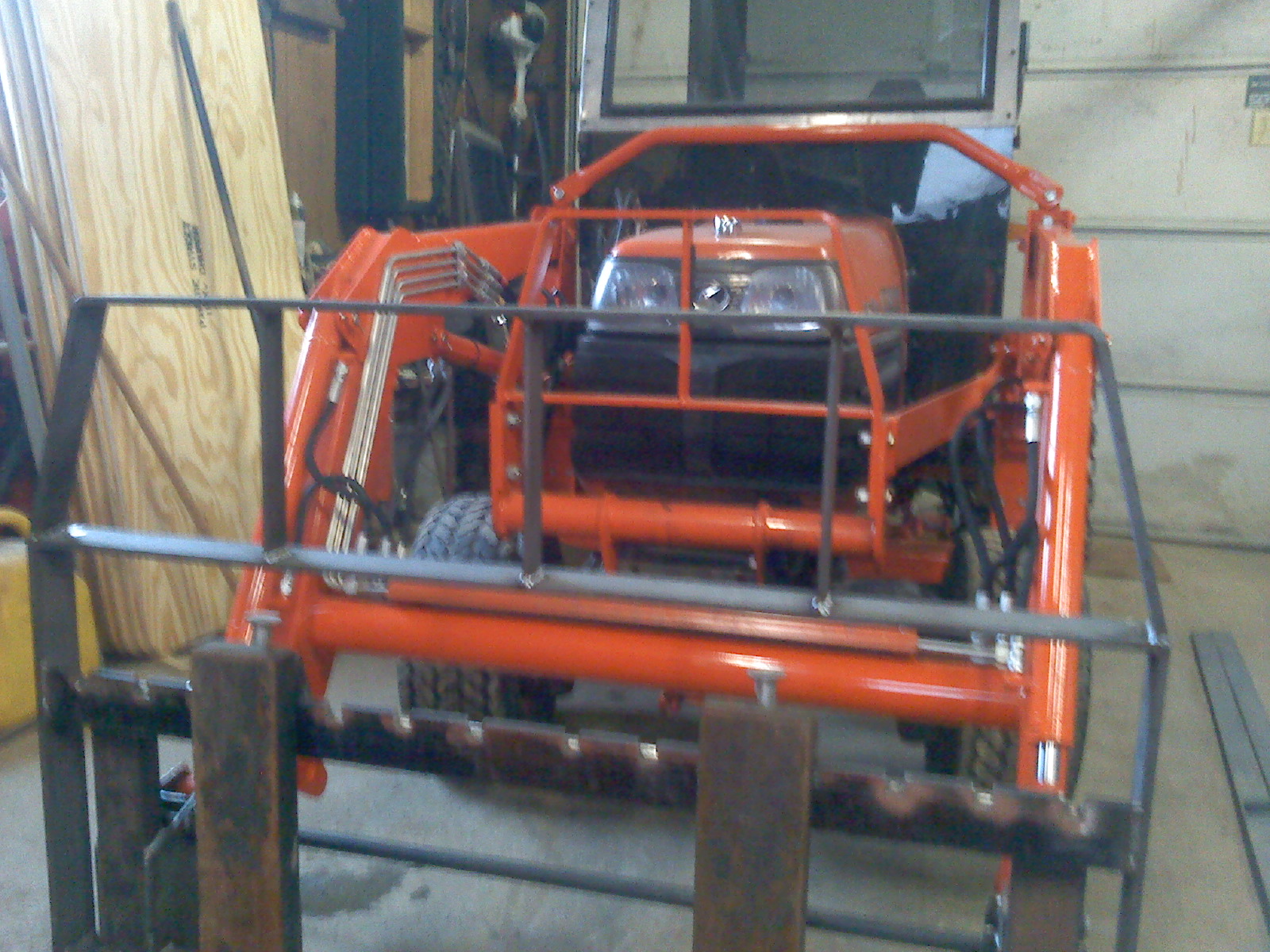

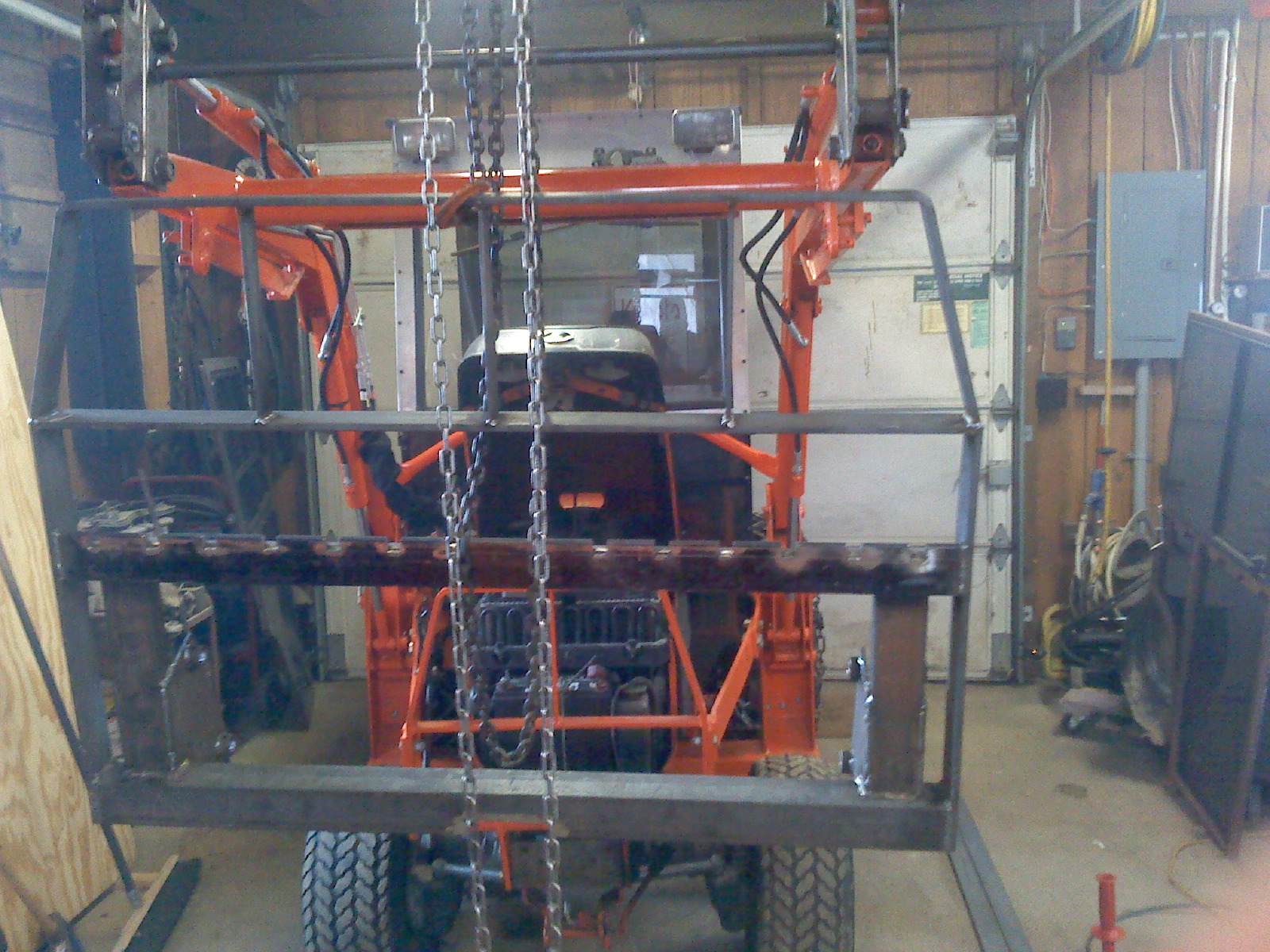

I got the hitch mounts done and welded to the frame all works great but...... My forks weigh 80# each and the frame probably weighs 120# so the capacity is down to about 500#. This is a guess. But now I can "lift things up and put them down"! :laughing:

I didn't like the 42" forks for my little LA302 so I swapped them with a friend for a set of 36" forks. They weigh less and should limit what I try to pick up so I don't over do it.

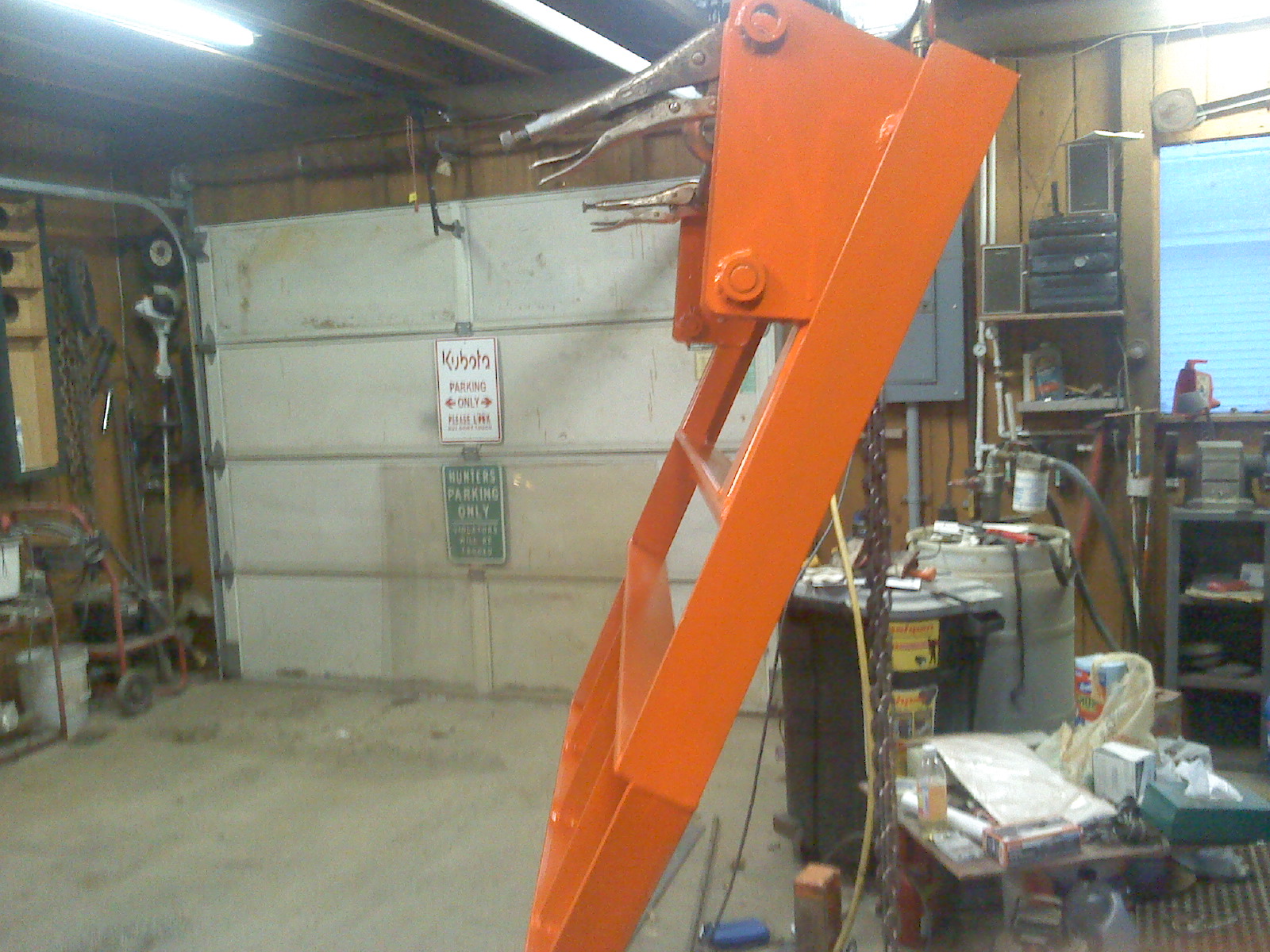

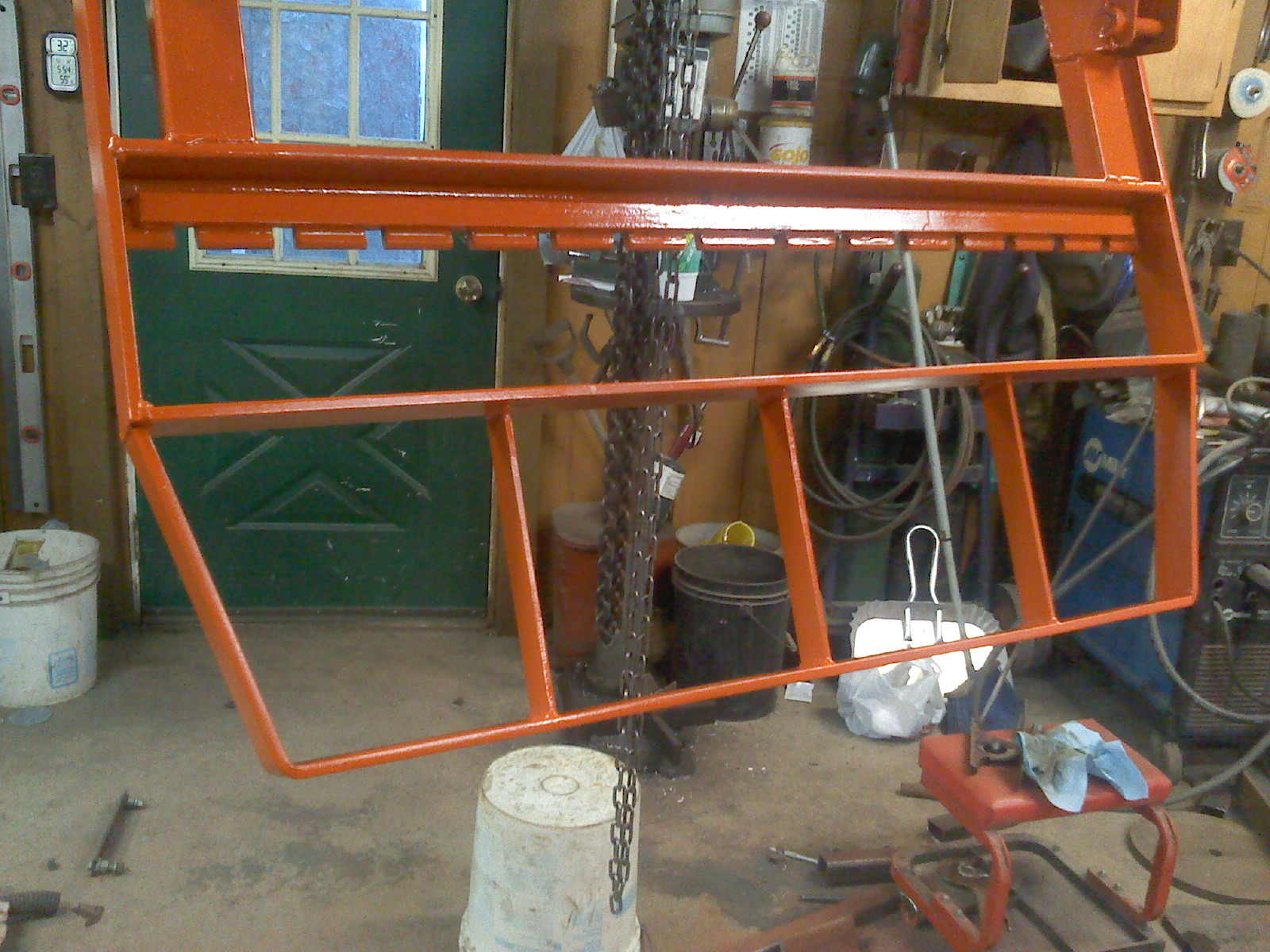

Well I just couldn't wait for warmer weather so I took the forks off today and painted the frame!! I think I will shoot a second coat maybe Monday. I shot it with spray bombs and I think it turned out pretty nice........ but then I am biased!! :D

here is the fork frame all painted and re-installed on the 'Bota!

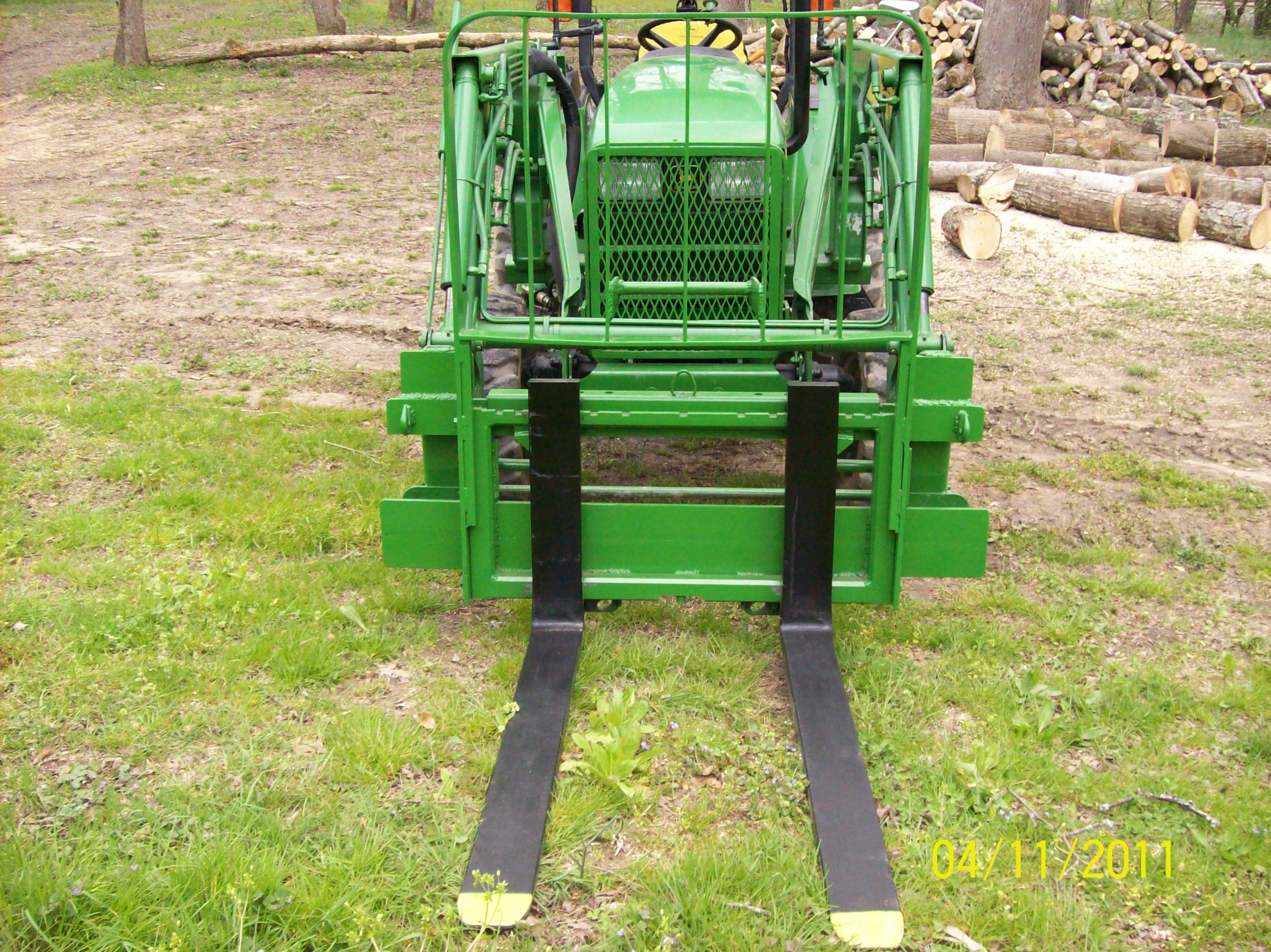

I built a set last year that are 42"... I made them ''FEL Quick Attach'', and welded pins so they will also be ''Quick Hitch Attach'' for the rear!... I really like to use them on the rear if I'm just moving pallets of firewood around!!

I just found your thread this morning!:eek:... I know it will be a pain to grind off the paint if you wanted to do this... I can unhook the forks from the rear without leaving the tractor seat!:)
Here's a few pictures....(I can take a better picture of the forks tomorrow if you need one, I'll be using the forks anyway.)

Here's a picture that shows the lower pins.
Hope this helps!

That does help! Looks like you have had a few heavy loads on them! :laughing: Looks like the top link pin is bent down and the left pin is bent up! I will have to do some checking to see if I can make them universal front and rear mount. Thanks.
