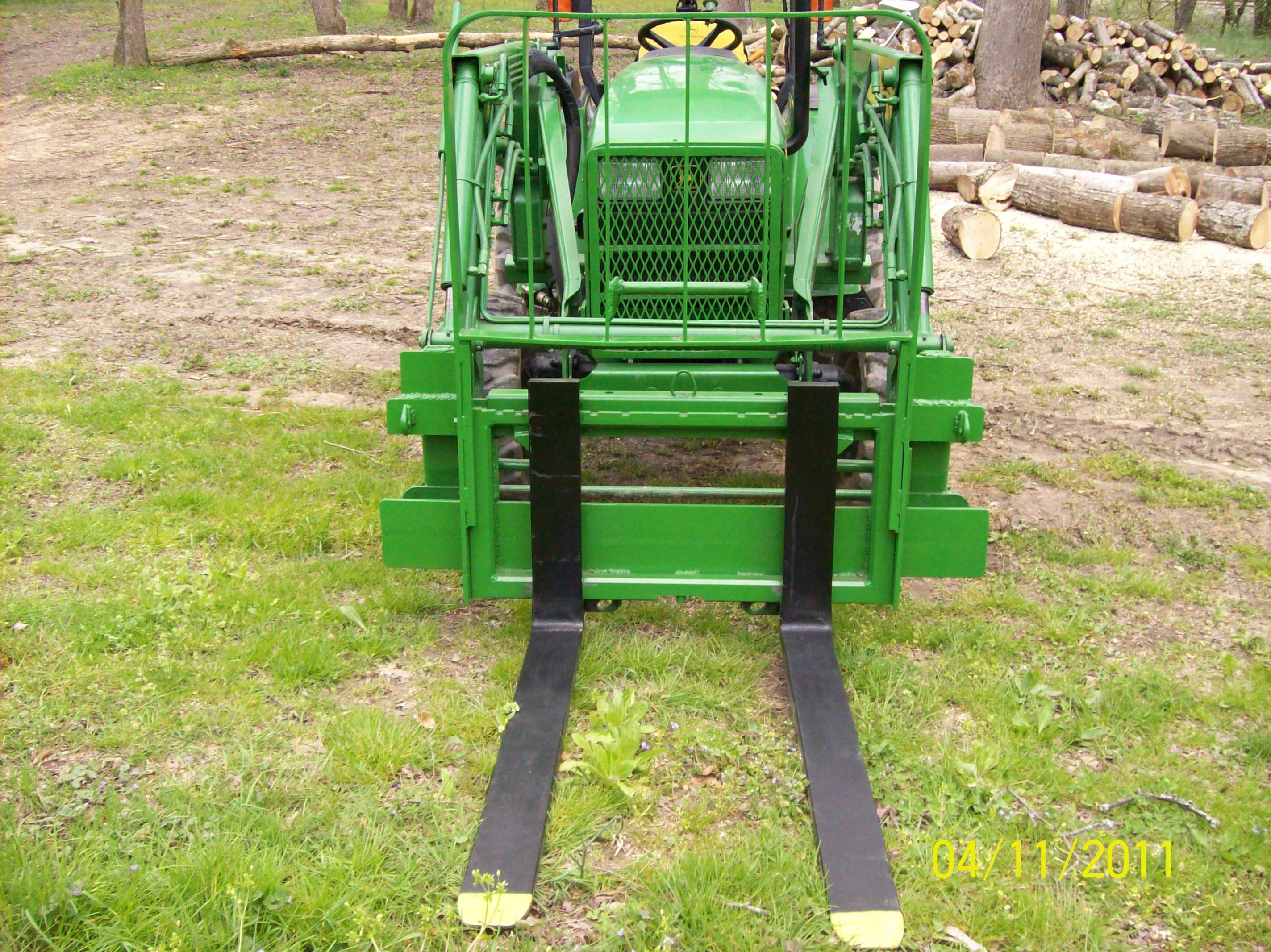

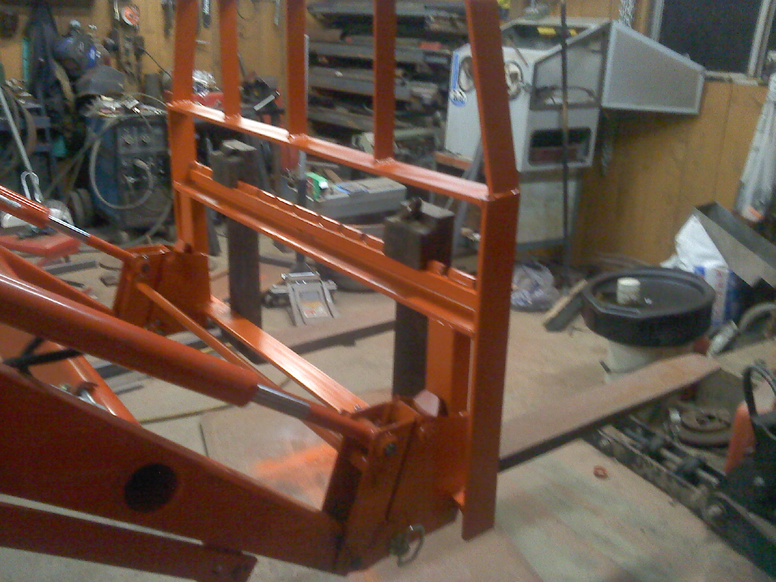

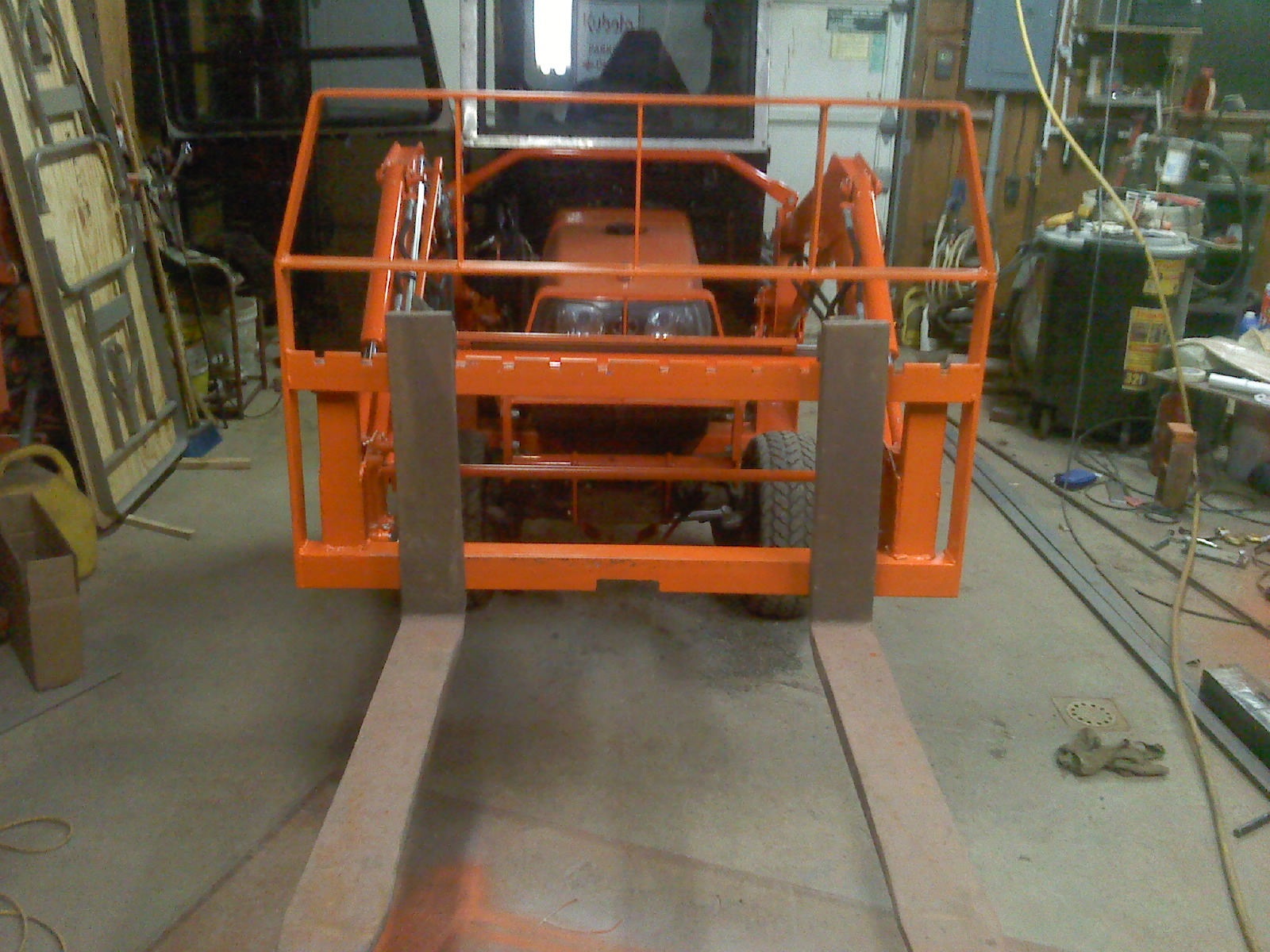

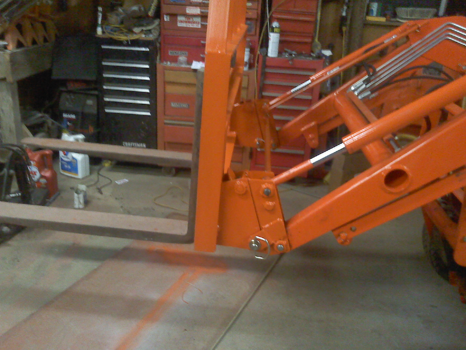

here is the fork frame all painted and re-installed on the 'Bota!
Nice job on the forks!!!:thumbsup:... They look great on your tractor!!
Forks on a tractor are a ''must have''!!!:D

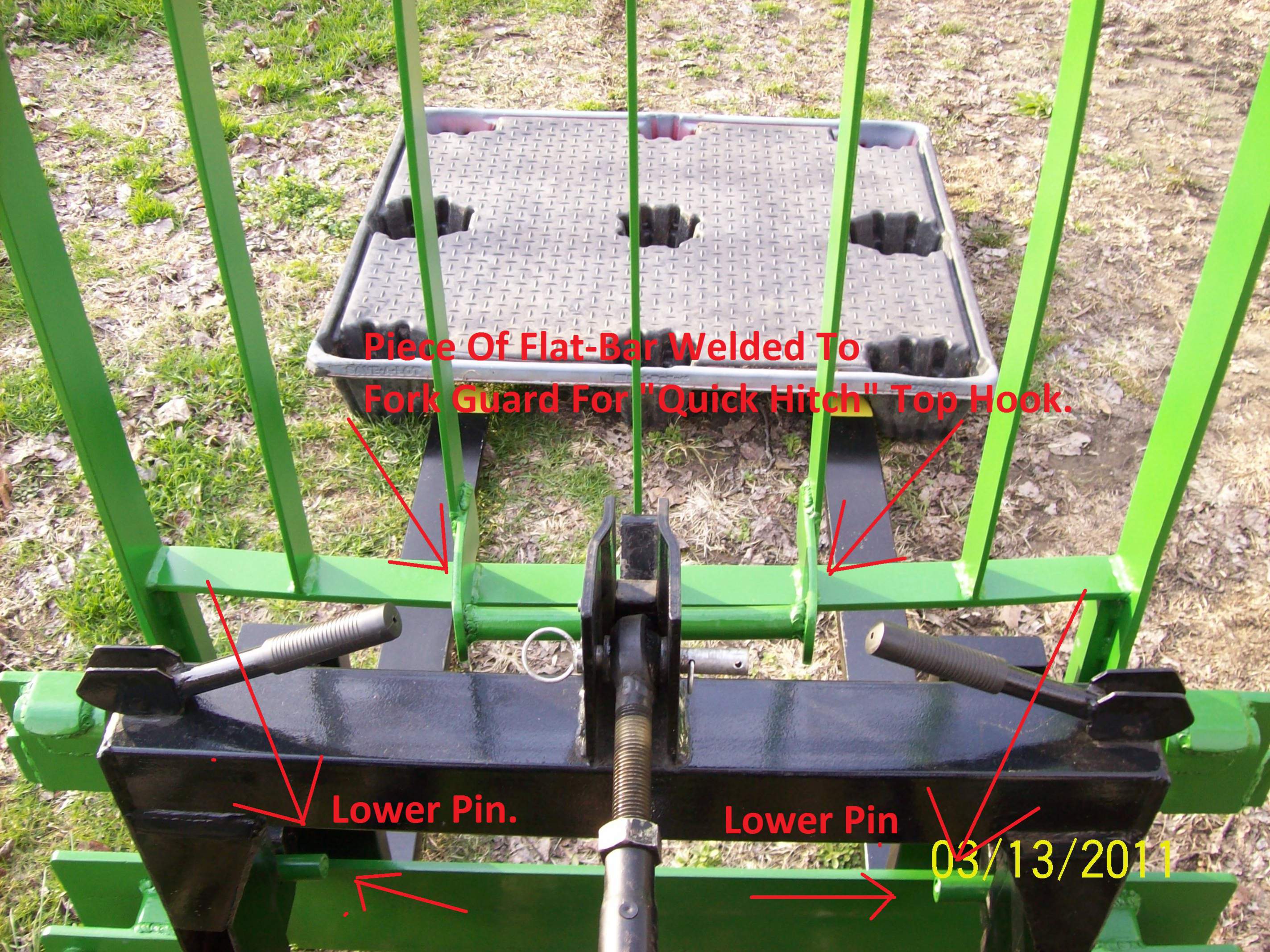

I built a set last year that are 42"... I made them ''FEL Quick Attach'', and welded pins so they will also be ''Quick Hitch Attach'' for the rear!... I really like to use them on the rear if I'm just moving pallets of firewood around!!

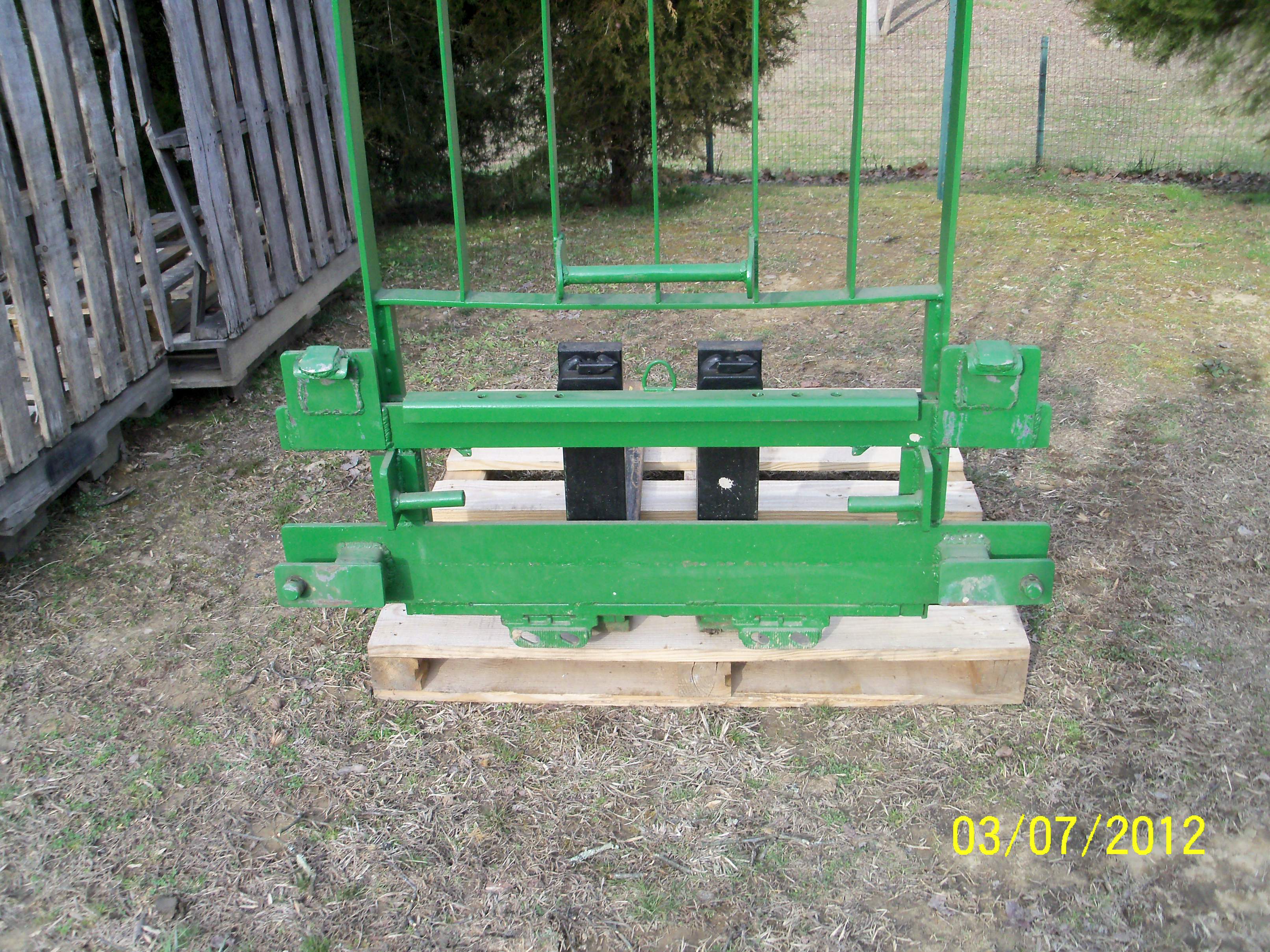

I just found your thread this morning!:eek:... I know it will be a pain to grind off the paint if you wanted to do this... I can unhook the forks from the rear without leaving the tractor seat!:)
Here's a few pictures....(I can take a better picture of the forks tomorrow if you need one, I'll be using the forks anyway.)

That looks great! I would definitely like to see a pic of the back side with it not on the tractor.

Here's a picture that shows the lower pins.
Hope this helps!

That does help! Looks like you have had a few heavy loads on them! :laughing: Looks like the top link pin is bent down and the left pin is bent up! I will have to do some checking to see if I can make them universal front and rear mount. Thanks.
