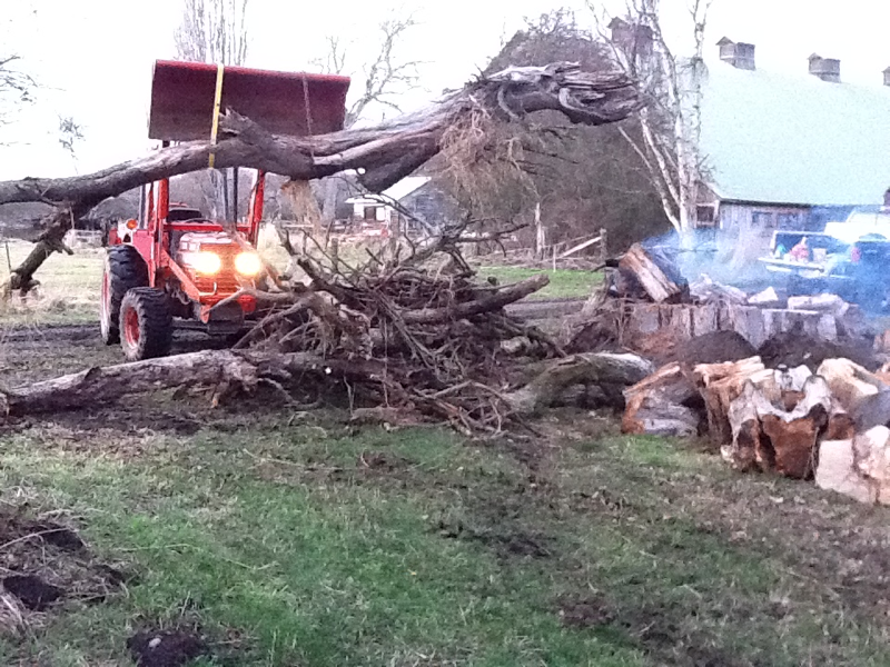

Thank you for the great answers. I will be needing to take the backhoe off the L5450 in the next few weeks and this helps a lot.

   / LA5450 with L1150A FEL #22
Taking off the backhoe is easy thanks to Bradco's design. All you'll need is a level spot and a hammer for popping the wedges loose. The hoses to the tractor are long enough so you can lift the machine off, set it down, and get it all "parked" before disconnecting hydraulic power. I have the Bradco owner's book in a .pdf (2.6 mb) if you'd like it - send an email address by pm. Take care, Dick B

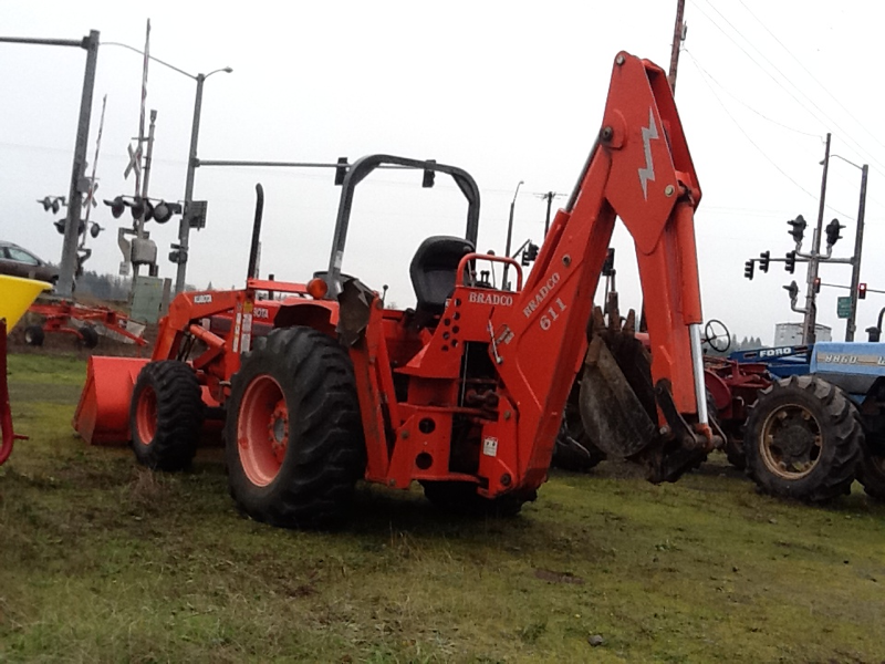

rbargeron,
I've taken the Bradco 611 off of the L5450 twice now. Both times the left wedge showed pin was quite suborn, even with the load relieved. Does the sloped portion of the pin face the front or the rear? Other than this, it sure is a breeze to remove and attach. I was thinking of adding a liitle grease to the sloped pins next time.
   / LA5450 with L1150A FEL #24
Sloped pin. Sorry.
   / LA5450 with L1150A FEL #25
Grease on the wedges is fine - They'd never push out by themselves, and they work facing either way.
