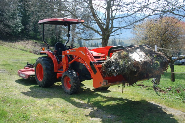

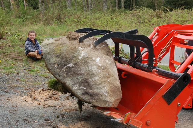

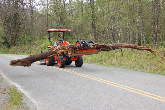

A few pictures of the loader in action.

L3240, what grapple and toothbar is that on your tractor?
