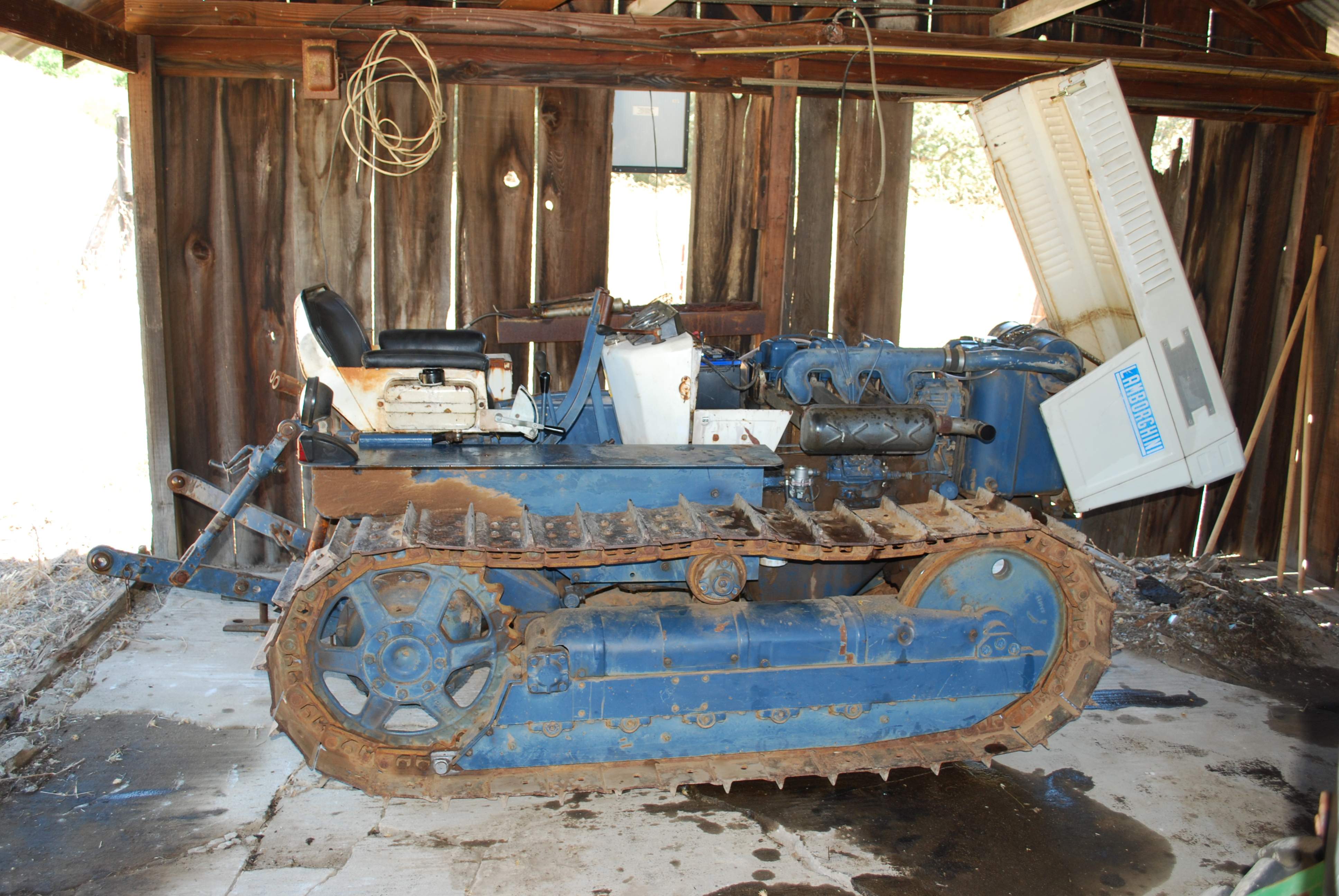

I'll dig up a photo and post. Its a crawler, 62 HP 3 cyl. air cooled diesel. Looks pretty sturdy but compact like a lot of Italian tractors. But that is about all I know too. Just wondering if anyone has had good or bad experiences with them.
   / Lamborghini C603
If I managed to do this correctly there should be a photo of the Lamborghini attached

Wow - that is a cool little crawler! That should be great for getting into some tight spaces with a fair amount of HP! Good luck and hope you get some information that will help you out!
Thanks for the photo
