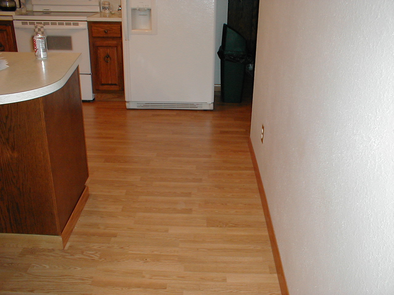

I installed Pergo flooring in my own house several years ago. It was a tongue and groove type that you ran a bead of glue in. I did install a new 1/2" sub floor in mine. 4 years ago I installed snap and lock flooring in a second home I own that one of my sons rents from us. Attached are a few pics of that install. We installed a 1/4" sub floor on top of the existing floor then lay down foam padding then the floor. The laminate floor is a floating floor that moves. Installation instructions say to leave a gap all the way around for expansion. It went down fairly easy. We did the living rm, dining rm, and hallway in one weekend.

George2615,
Very nicely done, and thanks for posting the completed pics for us !
