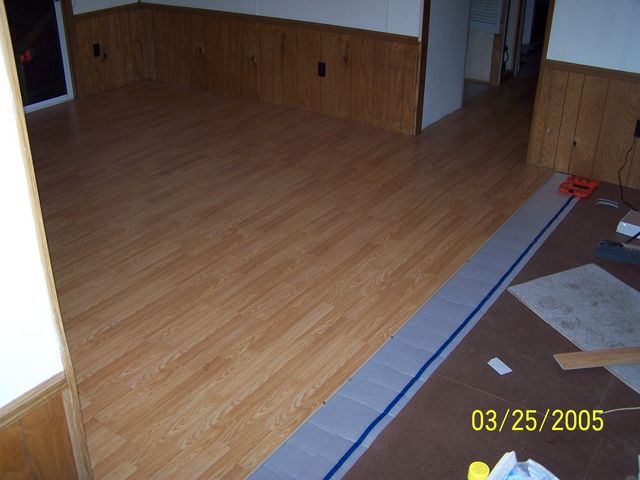

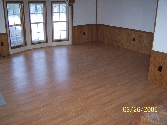

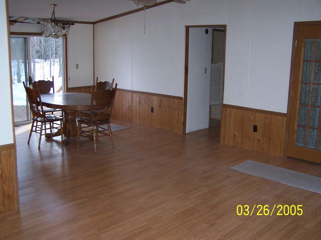

I installed Pergo flooring in my own house several years ago. It was a tongue and groove type that you ran a bead of glue in. I did install a new 1/2" sub floor in mine. 4 years ago I installed snap and lock flooring in a second home I own that one of my sons rents from us. Attached are a few pics of that install. We installed a 1/4" sub floor on top of the existing floor then lay down foam padding then the floor. The laminate floor is a floating floor that moves. Installation instructions say to leave a gap all the way around for expansion. It went down fairly easy. We did the living rm, dining rm, and hallway in one weekend.

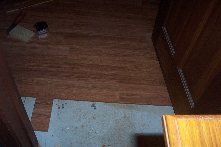

i have been putting down the cheepest stuff i could find at lowes in my trailer.
A lamiment snap together floor for $0.80 sqft. its a nice light color, oak look, lays up tight with no micro bevel which i cant stand.
Its thin only about 3/8" with a MDF backing. I did opt for the foam-plastic underlayment to help level out and cushion my uneven floors (reduces the "taping" sound the floor can make if you dont use a cushion)
my first section (in the bathroom) has been down for about a month and holding up fine. We'll see how it does long term.

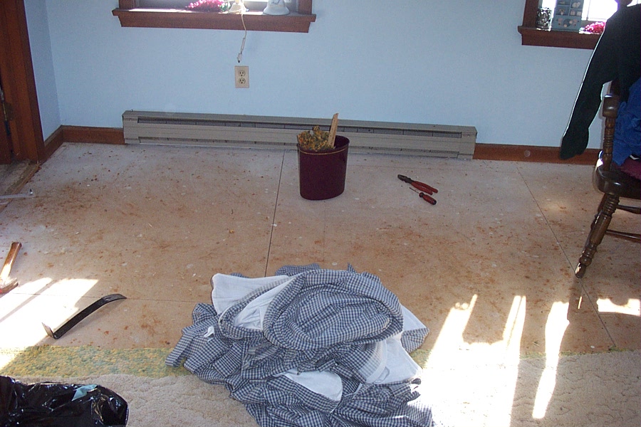

Are you cutting the carpet into strips and rolling them up? For some reason, some people like to take up the entire carpet and then destroy the house trying got get it out without breaking your back. Cut it into strips about three feet wide and roll up each strip. Then it's easy to carry and you won't break anything while going through your house.
Good Luck,
Eddie
Good Evenin Eddie,
Yes I am, I started by cutting 6 ft strips to make it easy to get it out of the bedroom and down to the first floor and out into the garage ! They fit into the pickup easy enough and then to the dump ! :)
