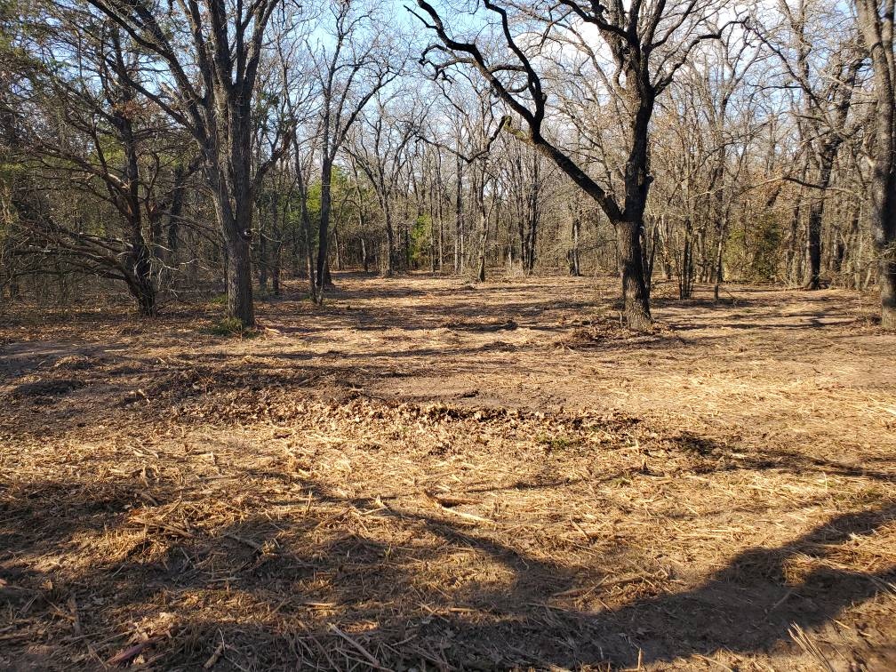

I purchased a 27 acre property here in Texas about four years ago. It is flat terrain and heavily wooded with mainly Mesquite, Elm, Oaks and Cedar trees. Extremely heavy brush composed of Cat Claw and assorted 4" thick vines are everywhere. Using my tractor, chainsaw, stump grinder and chipper, I have selectively cleared 9 acres in 2 years of partime effort.
Last week I hired a land clearing specialist, who uses a 90hp tracked skidsteer with a forestry mulching head, and they basically accomplished the same Selective clearing on 18 acres in just 4 days. That's 4.5 acres cleared per day. Any trees removed were ground down by the mulching head. I was always present with my tractor to pick up any barb wire rolls, which can create problems for the mulching head.
I am completely surprised at the speed and capabilities of these land clearing skidsteers. Anyone else have similar experience with these specialized land equipment.
   / Land Clearing Project #2
Don't know what it looked like before. Certainly looks nice now. Amazing what specialized equipment can do.
