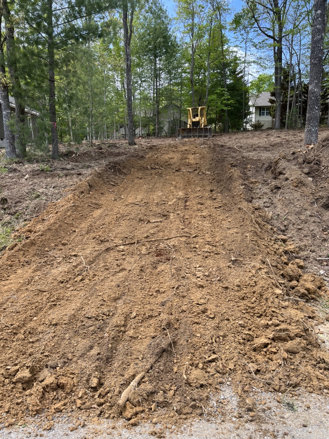

A dozer or a loader dozer would be best. I do a lot of clearing for deer plots and have a few repeat customers. I have a D4G which has 6 way blade and hydro on the stick. On 1 to 2 inch trees I would grub them out and as I go also be running over what ever the blade does nor get. I then approach at like 90 degrees and gather it all up. Another choice is a heavy bush hog to cut them down or a skid steer with a grinder. Either way there you will have the trees trying to sprout out again. Also after cutting a chisel plow could pull out the clumps. No matter how you look at it requires a lot of time on that type growth and 300 acres is a large area. From origional post I presume the property is not in the USA? I attached pictures of an area I recently did. Lots of stuff 1 to 2 inch with larger trees and remains from logging a few years back, but it really looked good and property owner loved it. With the hydro the d4 can maneuver like a skid steer. Of the clearing I have done for people this seems to work the best. One guy had me with the dozer and one guy also grinding. I loaded up after I did the bigger trees as he said he would have the grinder do the rest.. I had asked at the time, "If you are done with work for the D4 I'll load up while it is handy?" When you are all hooked to the trailer and ramps are down etc. it's easy to load back up. He said I'll have them grind the rest. Next day he texted me and said he wished I still had the dozer there. Either way 300 acres of that type of growth is a lot of work
