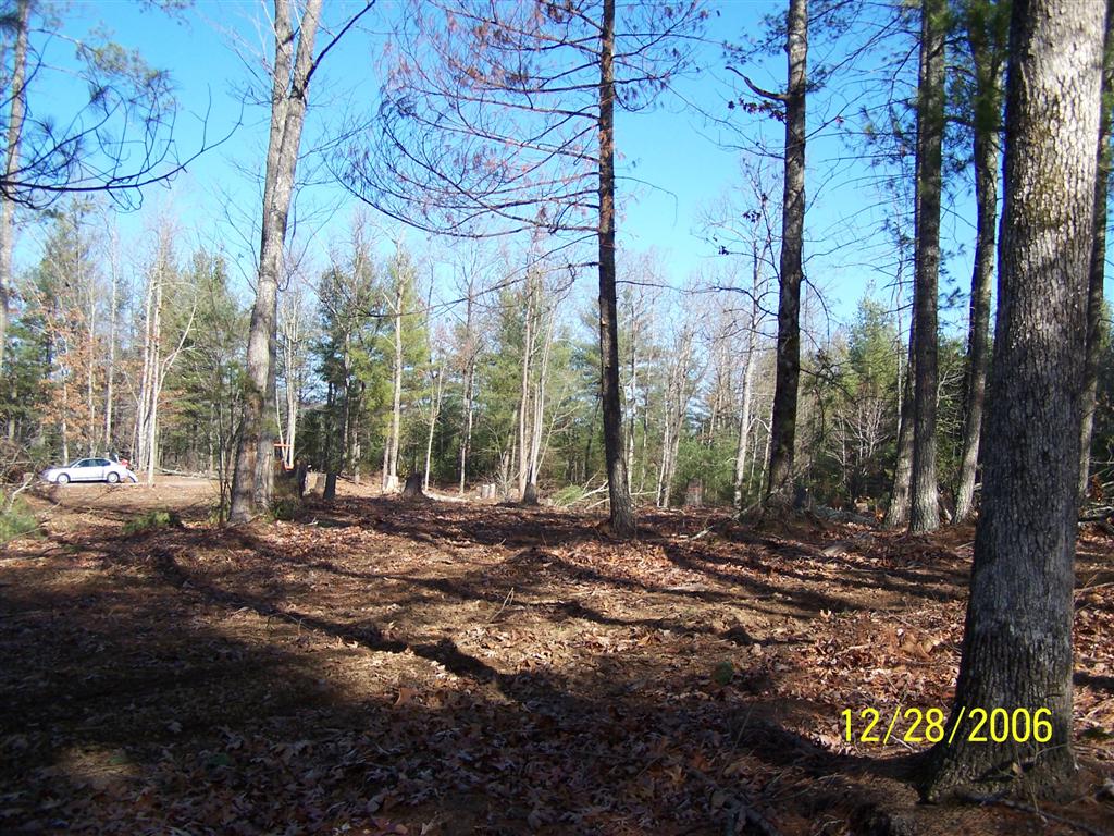

This is a view from my front porch (when I get one).
The second picture is not a view form my front porch, attached the wrong pic:eek:

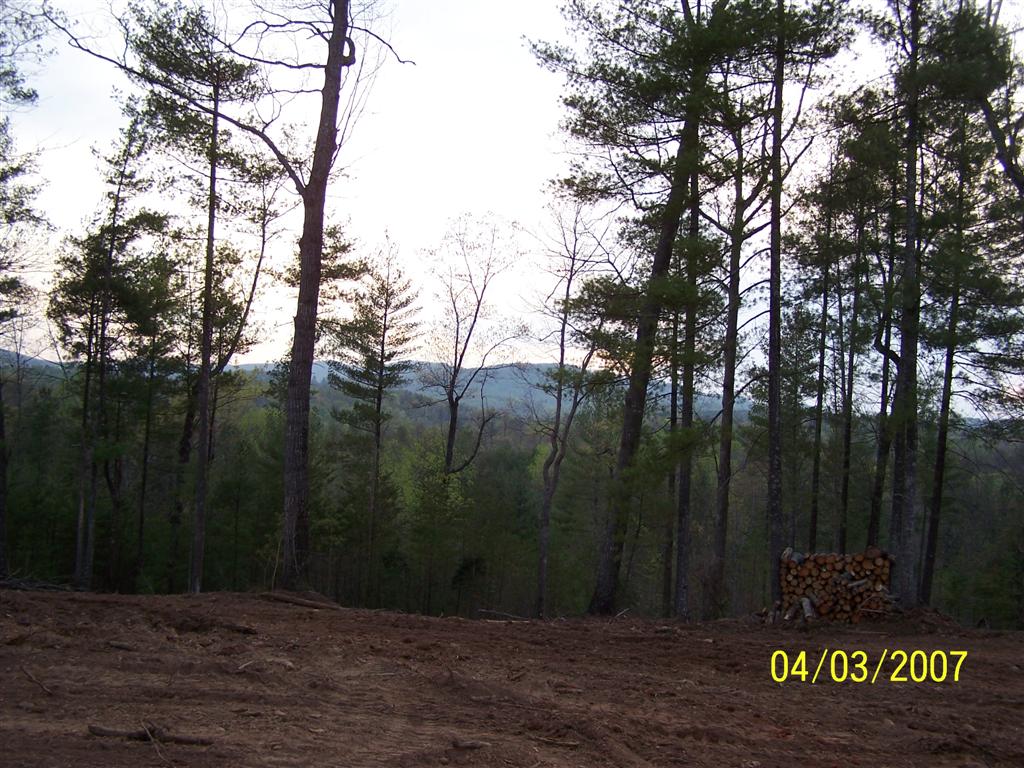

Here is another view from the front porch.

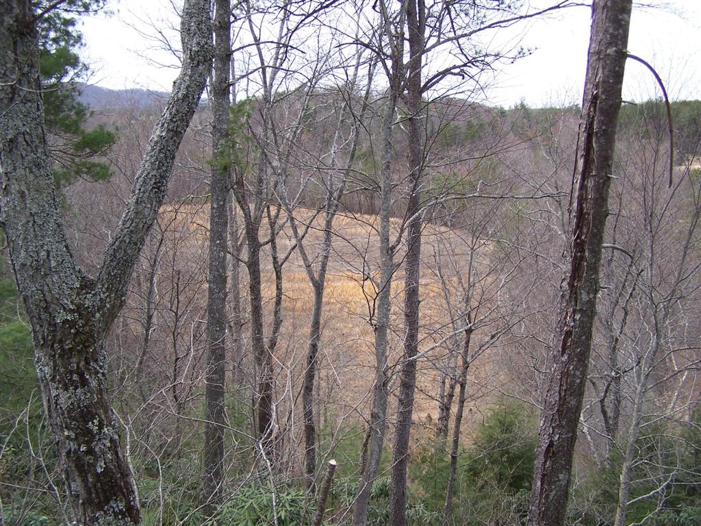

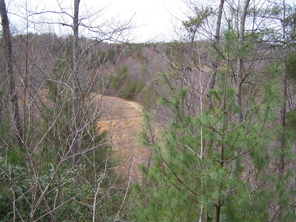

This is a view from the back side of the house looking off the ridge to the river and the river bottom.

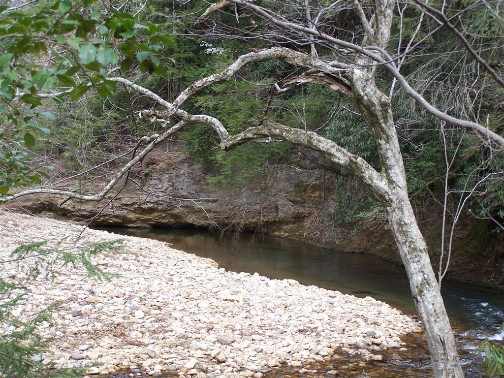

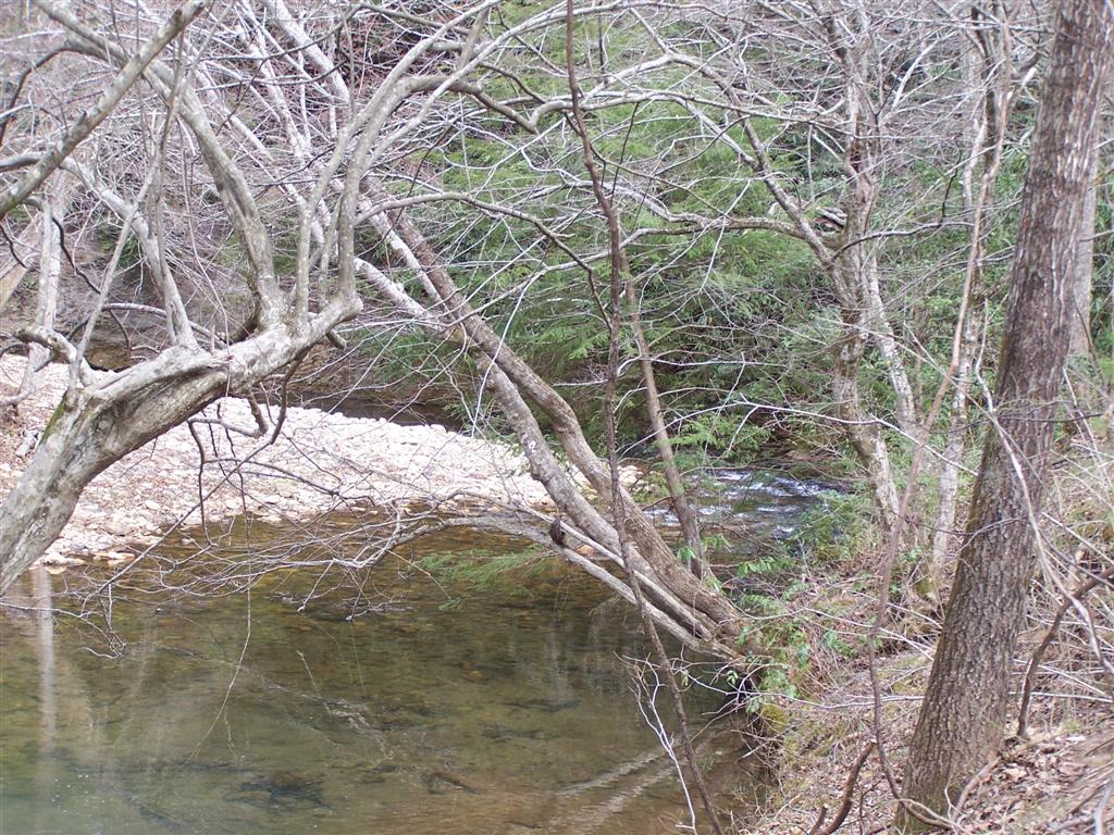

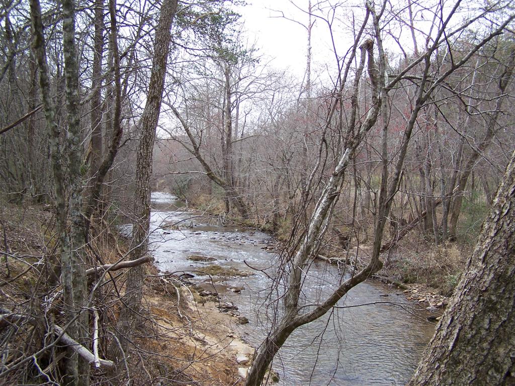

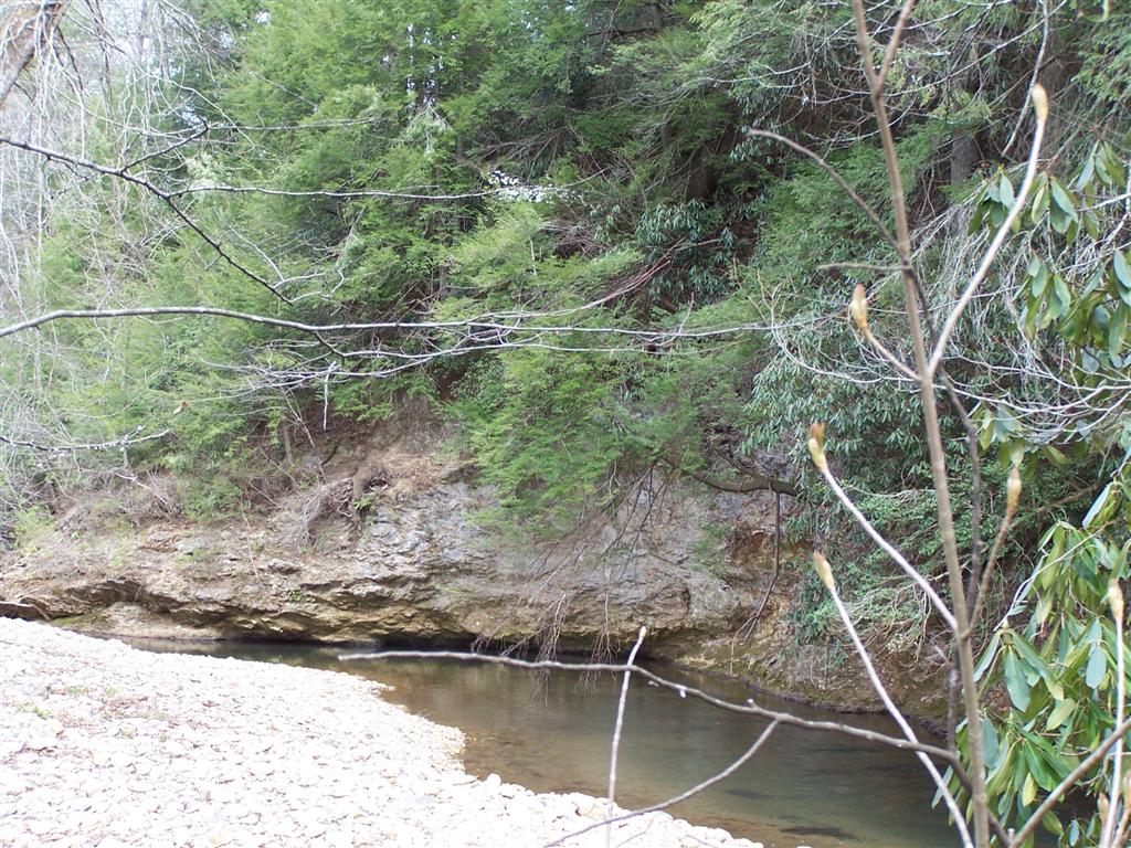

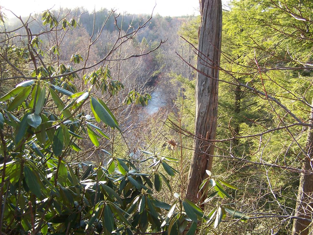

These are picture of the river that borders 1/3 to 1/2 of my property. The picture that shows the rock face and turn in the river is where my property line is, it goes straight up the middle of the rock face.
Property line runs the middle of the river, so half that water is mine:D .
