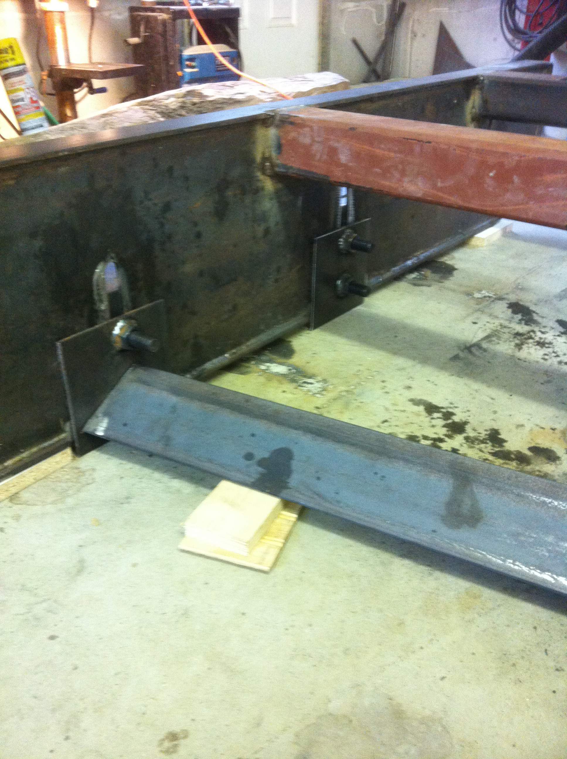

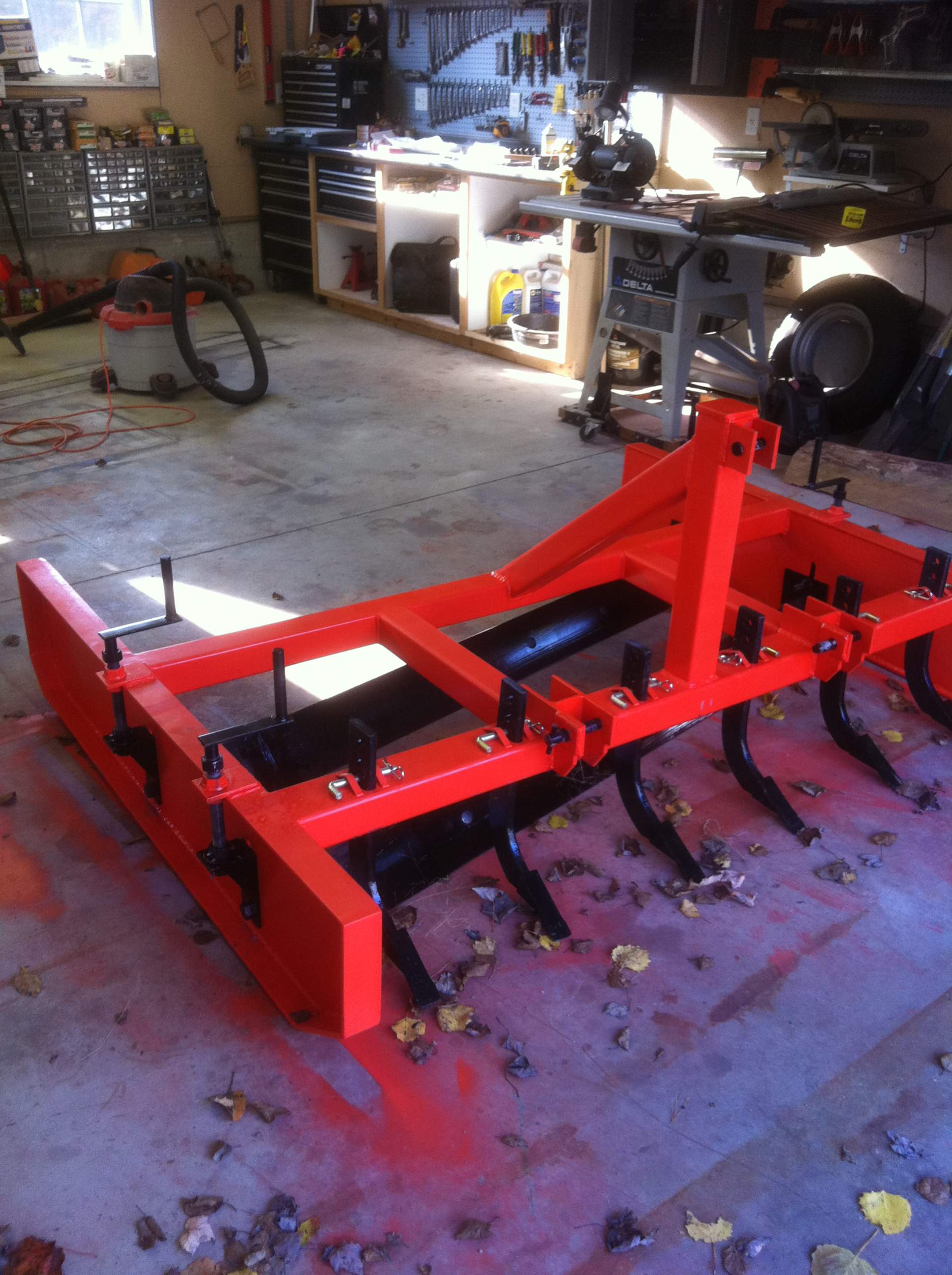

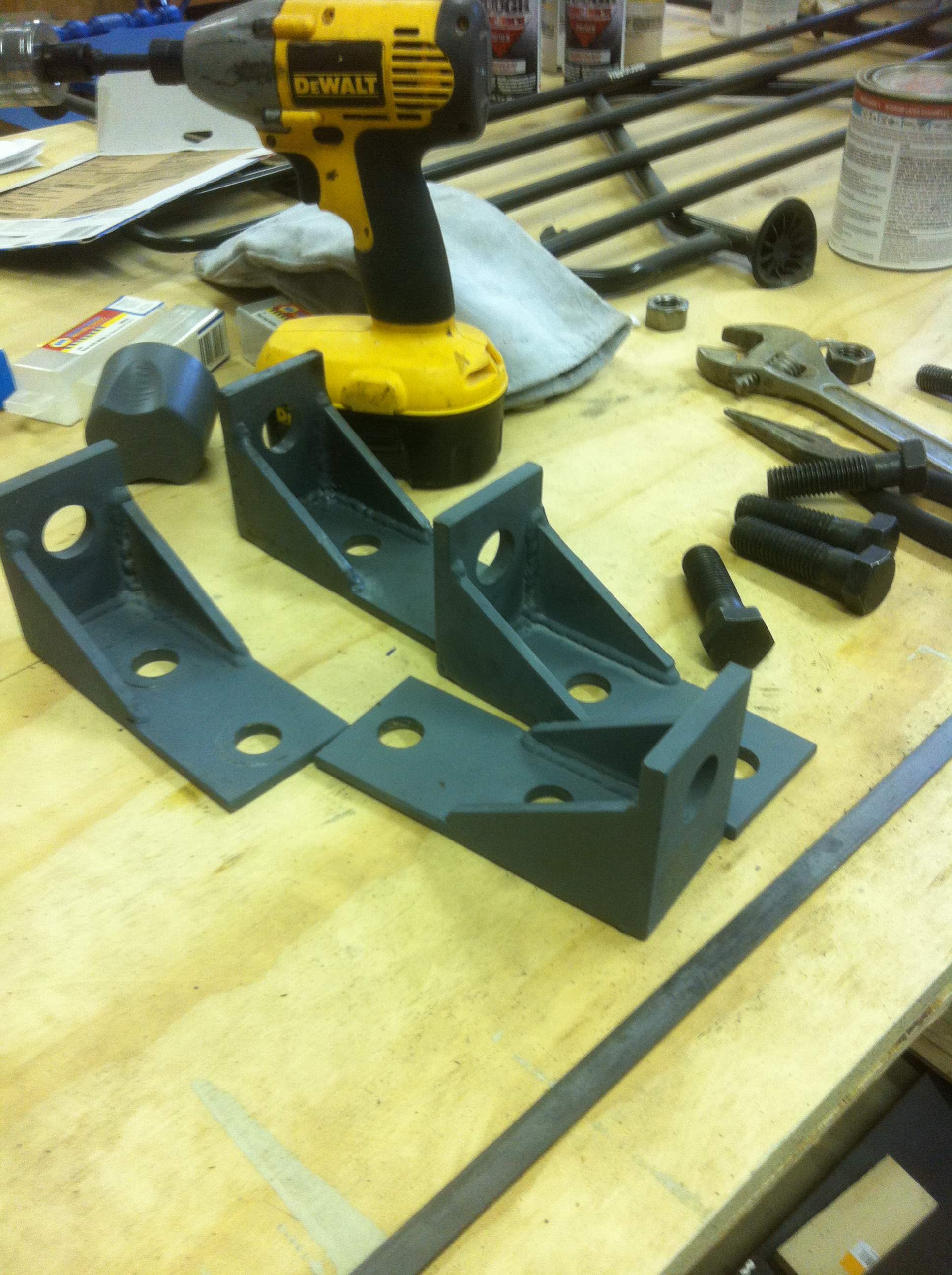

Very good! I agree that the angled blades cut aka slice material instead of bluntly running into it. Like an exacto blade: Hold it vertical & try to cut & it just tears the paper & bunches it up, but the further you angle the exacto downward, the smoother it cuts.
I've thought about the possibility of adding a gauge wheel to my grading scraper. I know it would be longer, which is the idea for a better grade result, but it could removable, too, for times when just the scraper itself is needed :thumbsup:
/ Land Leveler Completed #22
Very nicely done :thumbsup: Your adjustable blades look great.
gg
/ Land Leveler Completed #23

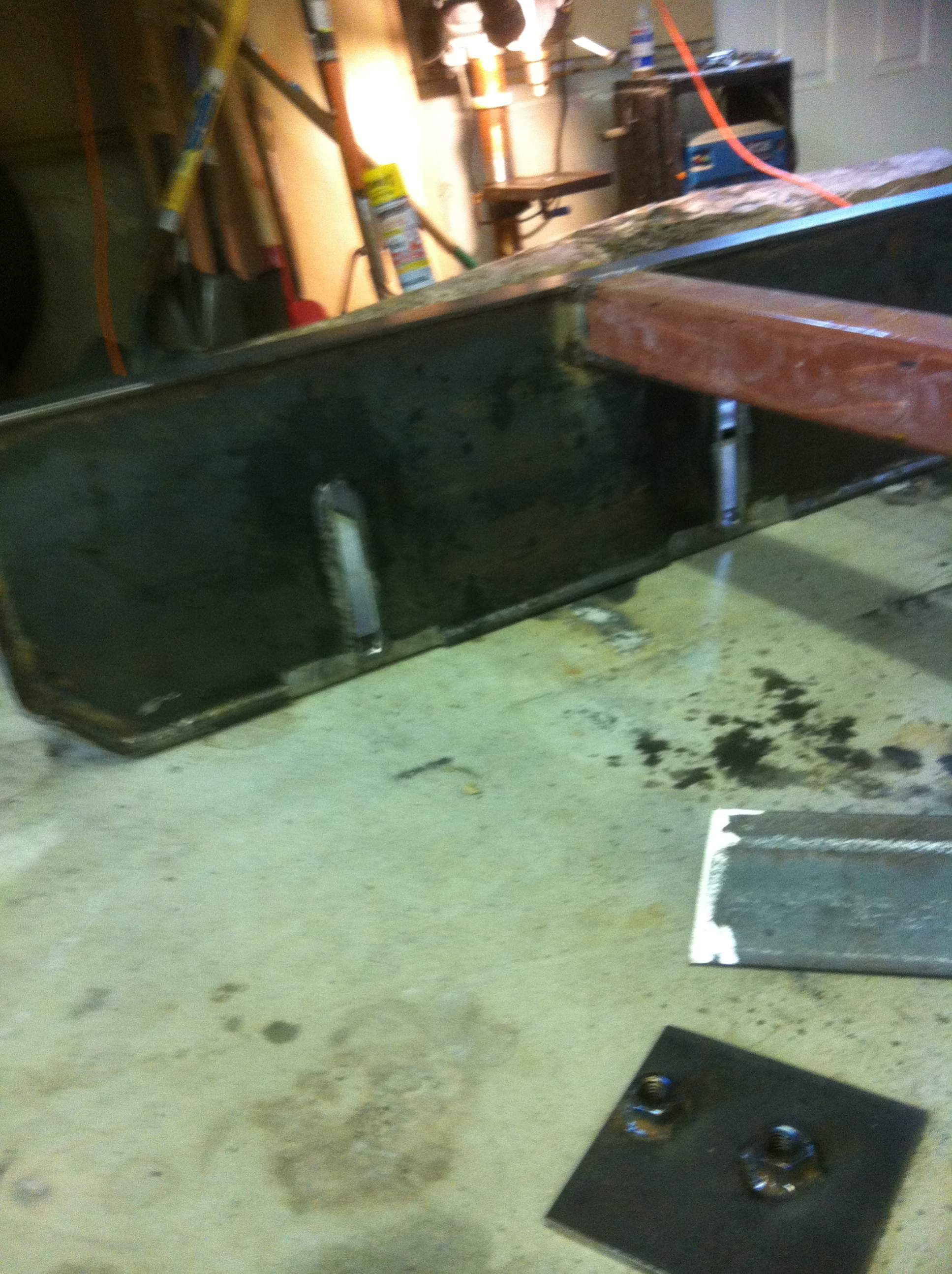

The main thing it will need is skids.
Two other differences are that the land planes have a 2nd blade parallel to the first, & the blades are slightly angled to direct material toward the left for road crowning. I think you could make a pretty darn good land plane just by adding side skids, though.
When I said converting I meant cutting it apart to use parts from.I could use the hitch. The rippers and mine has 2 cutting edges. I would just meed the side plates with skids.

Are you still planning to provide a sketch and more details about the build.
Bobby
/ Land Leveler Completed #34
I love to see some large format pics of each main part up fairly close
Great job!
/ Land Leveler Completed #35
I have been looking into buying/building one of these. Can you give an estimated cost and would you consider sharing the design?
