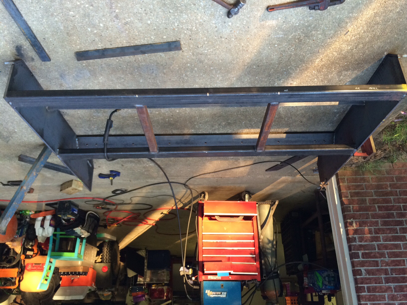

Gordon, I was just wondering where you cut the 4 bottom edges of the side plates how much did you cut off for the lead angle? it looks like you just cut a triangle off the corner.
I did. I cut a 3"X 3" triangle off
   / Land leveler
#34
Thanks Gordon, my steel is supposed to be delivered today and my my wife is going out of town so I'll try and get started this weekend
   / Land leveler
#35
all the steel came in this morning, went ahead and cut everything at work while I had the benefit of having a fork lift to move and level everything up on the saw. hopefully it will move along fairly quickly but I think drilling all the 11/16 holes for the blade will take a little while.
   / Land leveler
#36
Well I've made a little progress so far. I used the plasma to cut the corners off the plate and got the skids bent to fit. Drilled the holes in the angle for the blades. Now time to start welding it all together. I'll try to post a few pictures as I'm back inside, it's already 90 here supposed to hit 99 today!
   / Land leveler #37
Looking forward to the pictures, good luck with the project.
   / Land leveler
#38
Here's where I ended up tonight.
So tomorrow I will build the 3pt hitch and I need to flip it up side down and weld the bottoms up.

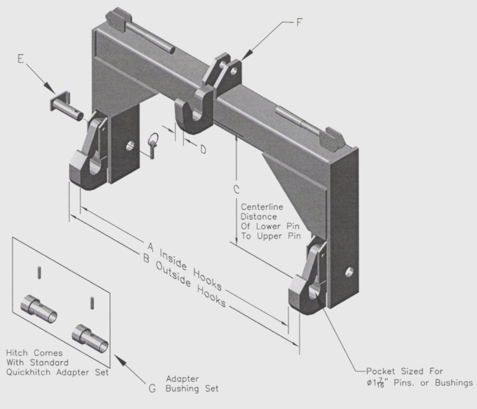

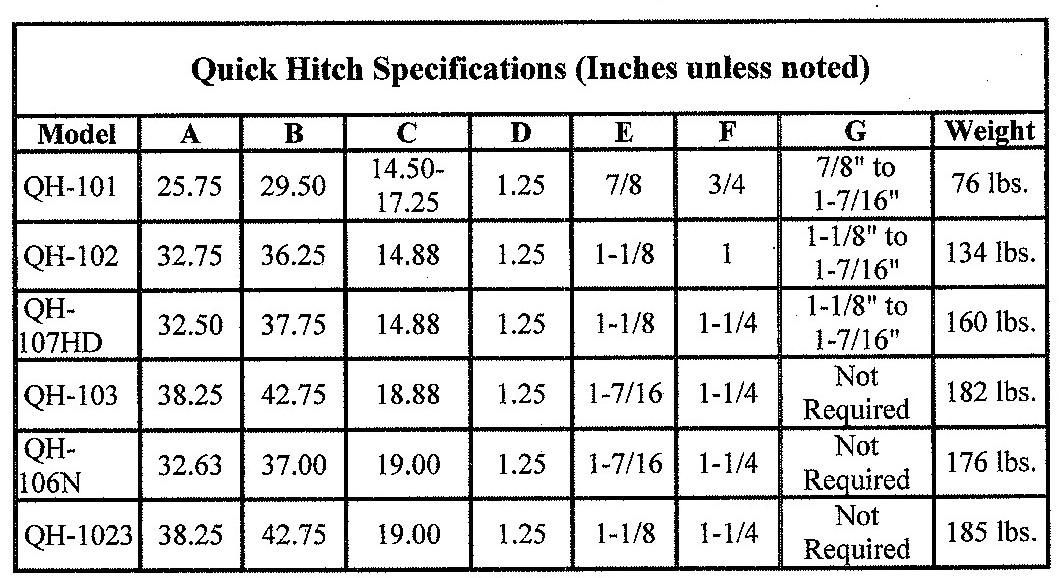

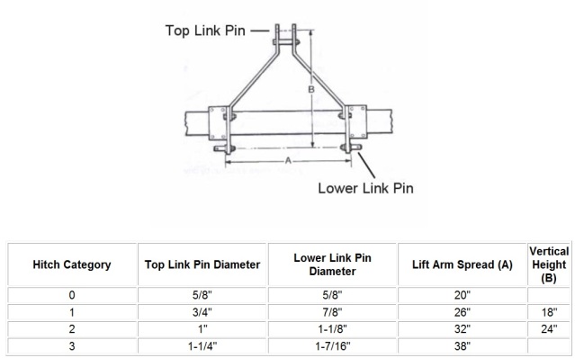

Iirc the lower pins are on 30" center to center. Does any body know off the top of their head the correct height for the top pin? Thanks for all the help. I hope to finish it up tomorrow then clean it all up and paint some time next week
   / Land leveler #39
Looks pretty good so far but you are going to need a lot of help getting the entire shop turned up right:D. Much easier to just turn your work over.
