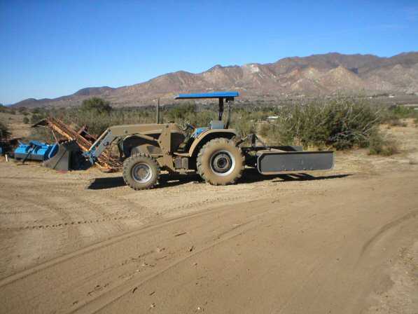

I have an EverythingAttachments 6' er... The reason I went with the narrower one was that I could take it out on my trails in the woods. Also, I only have 400' of drive, not 7 miles. I have not found the need for scarifiers, but I also do not try to do everything in one pass. First pass loosens it up some, and the following passes add more loose stone weight to make the blades dig down even deeper. Adjust the top link to keep a little down pressure on the rear of the plane [ tends to just ride on the front blade if you do not ] and adjust the side-to-side to hill it up some. The blades are slanted to help them cut into the hardpack, not to move material from side to side. If you make one, longer is better. And taller if you have lots of loose material on your road. But, as with width, trying to drag too much material behind you and you will run out of traction/hp...

Welcome to TBN. It is a trade off I guess but the heavier unit will do a much better job and not just rake the loose surface material into the low spots only to be scuffed out by the next storm or vehicle. I built this land plane. Notice it has hardened 3/8" thick cutting edges. I wore these down grading gravel roads in 3 or 4 years so I would think steel angle would wear quickly.
Two years ago I replaced the cutting edges with standard reversible 1/2 X 6 box blade edges and cannot see any wear yet. The old blades are upright on the right. The front wore more than the rear.
The heavier land plane grading scraper will cut the top layer of gravel and remix it before it deposits it back on the road in an even layer. It is easy to do and will hold up a long time especially if you pack it when you are done. It is so easy you can do the road more often if needed. The better you keep it the less damage you get with traffic and storms. I use my truck to pack with.
I get a much better job than just filling in with loose material. But it is a hard decision when money is involved. If you are looking long range I would go with the LPGS type unit.

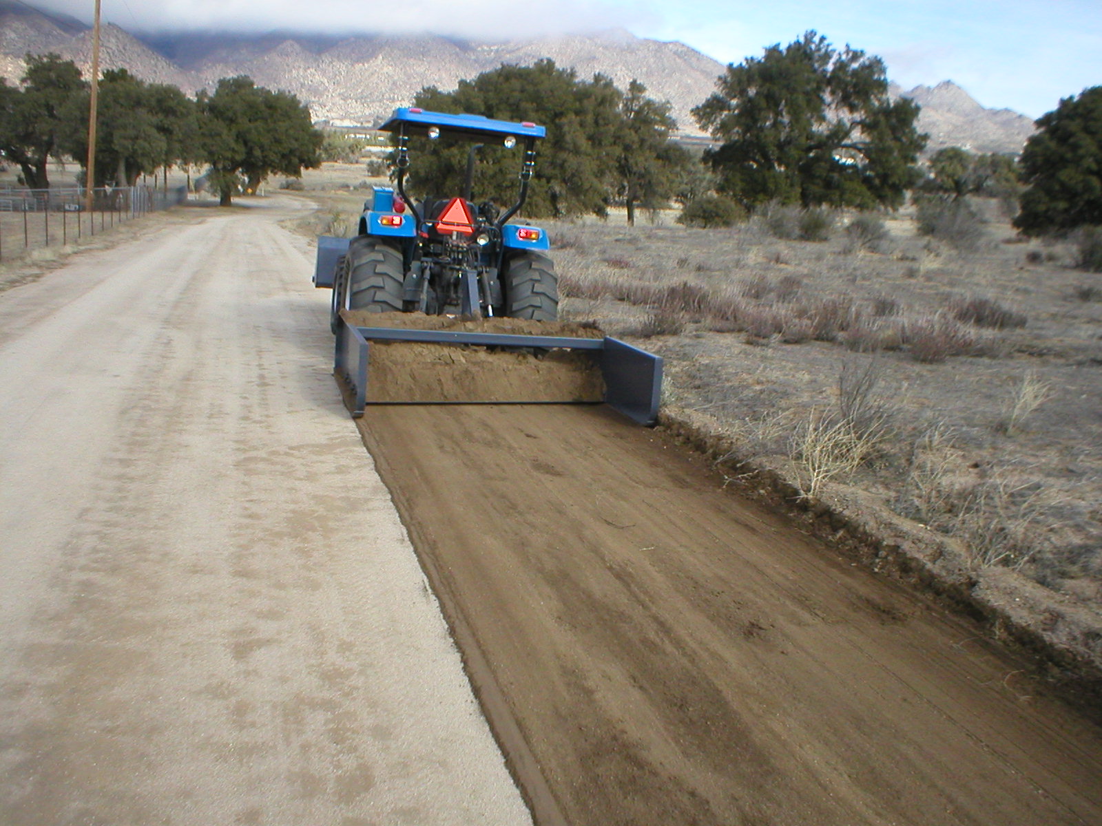

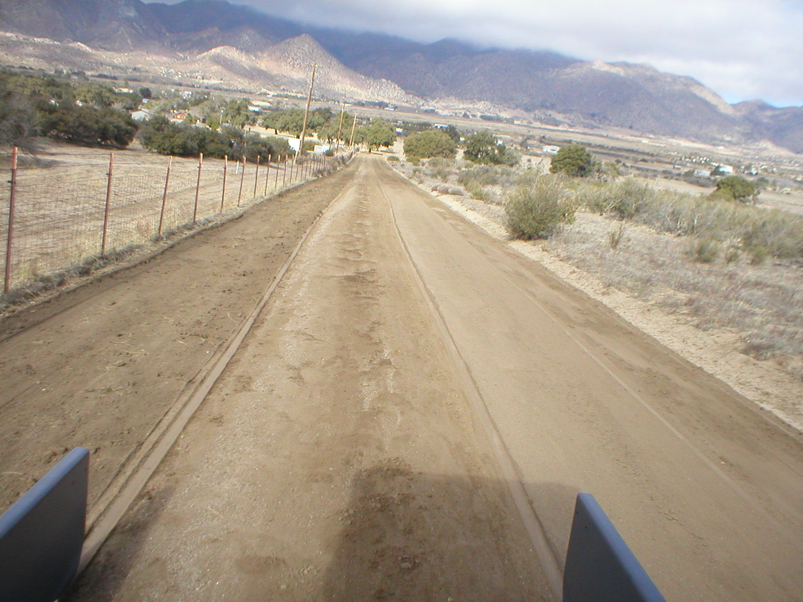

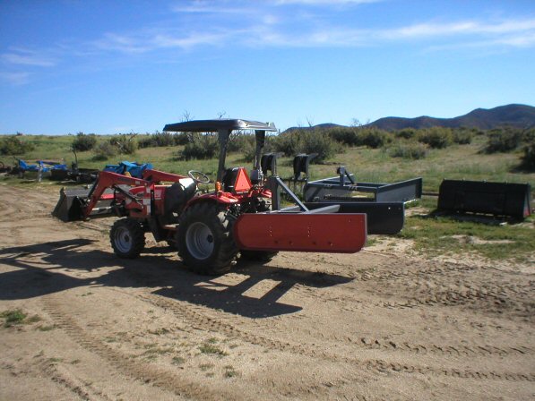

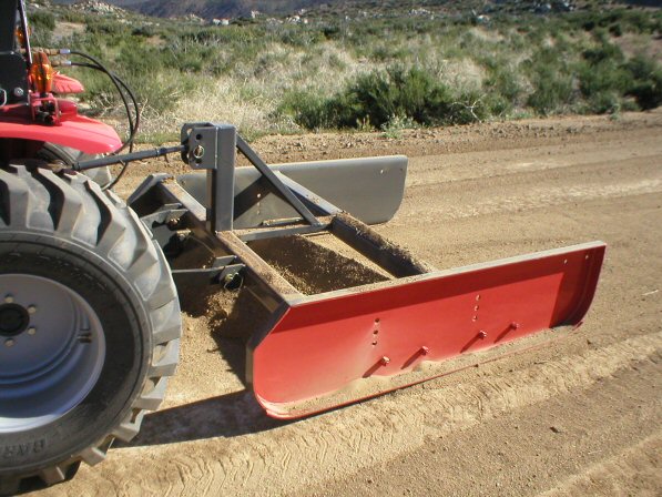

With the amount of roads you have to do and with what you have to pull the LPGS with, you need to get as heavy of a unit as you can afford or build. At a minimum of 1000lbs and heavier would be better. Forget about the 3 angle blade grader. You need something with taller sides and replaceable cutting edges. I would be looking at 7 footers here and here if it were me. There are others out there, but forget about anything that is economical, won't work as well or last as long.
My 5 footer is 800lbs and my 7 is 1400lbs. I can't imagine using anything much lighter myself and I only do 2 1/2 miles of road and fence lines.
One other thing, and is only my opinion based on my experience with my 12,000lb 75hp tractor, but to get the most out of a heavy LPGS, neither of your tractors is going to handle an 8 foot wide unit very well. I know that I would not want one for my tractor.
There are other people that have them and they work well for them, probably a lot to do with circumstances.

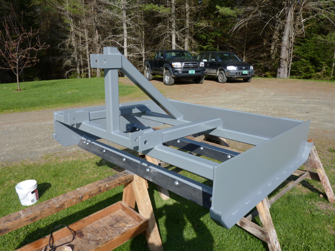

It is 3/8" X 12" plate and 1/4" X 2 1/2" sq tube. Cutting edge mounts are 3/8" X 4" X 4" angle.
2. how wide and thick are the skids
Skid are 3/8" bar 2" wide
3. if you had to do it again would you leave the blades going straight across or would you sweep one side back?
I think straight across like I have them. I do a lot of adjusting with the top link. I am thinking that having the blades straight across makes it easier to control the cut on a leveling operation. If the blades are angled back then as you adjust the top link the forward part of the blade, or one side of the scraper, will have a different cutting pressure or height than the rear part of the blade, or the other side of the scraper. I have never ran a unit with angled blades so my thoughts may not be valid
4. did you make the cutting edge height adjustable?
No, but that would be a very nice feature but to complicated for me. My blades are fixed 3/4" below the skids. I use the 3pth height and top link to make any adjustments in cutting aggressiveness
If you build one that is only 12" high or so like mine make sure you don't put a cross member over or close to being over a blade. There is a lot of material that has to flow over the top of the blade. You don't want to create an obstruction or pinch point that will hinder the flow. I have 1 foot clearance front and back between a blade and an overhead cross member. My unit is 4'6" long and 5' wide. Weighs 600 lbs

I don't know if this is an issue or not, because I have never heard of anyone else's blade angle being so thick, but my angle is 4"x 6" and 5/8" thick with the cutting edge going onto the 4" edge and the angle is like this ^ of course. But laying the non equal leg angle down like that seems to get the perfect cutting edge slope.
As far as the blades being angled, I think that in theory they are suppose to work better when angled. I can't think of a single professional-mass produced unit that does not have the blades angled. Pretty sure that every privately built unit has straight blades. Lots of supposed reasons, but let's be real, it's way easier to build these with the blades straight.
People talk about adjustable blades, why go to the trouble? As long as you have a hydraulic top link and a 3pt hitch, you have ALL the height adjustment you need. You can make extremely fine adjustments with a top link and those adjustments take a few seconds , can be done with the tractor in motion and are at your finger tips. I do not understand why anyone wants all the adjustment headaches that would come with manually adjustable cutting edges.
I understand having the cutting edges being adjustable to account for wear, but to adjust because you want a deeper or shallower cut, make that adjustment with the hitch or top link.
As far as making fine adjustments and the angled blades being uneven, again in theory it should make a big difference. In the real world, I have not noticed that it makes a difference. Maybe I compensate for it with my hydraulic side link and don't even realize it, honestly can't say. I just know that for me it hasn't made any difference at all.
Something else that people talk about, the material migrating over to the side because of the angled blades. Good, bad or other wise, on my LPGSers, it migrates over less than 1", so that is not really a concern either in my opinion.

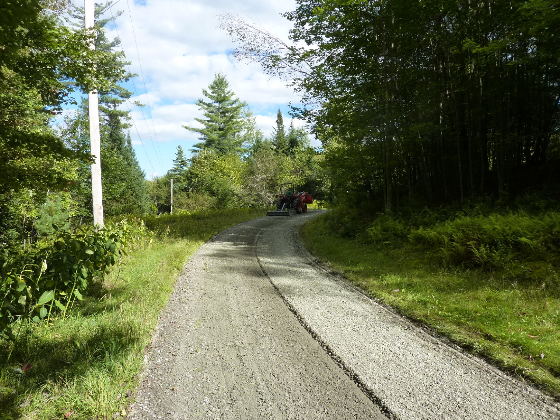

I find it quite useful. It was my attempt to make my land plane act a little like a box blade since I don't have one. If I am grading a clean gravel road the tail gate does almost nothing. The gravel comes off over the rear blade as smooth as it is going to get. But if you have sod or leaves or other debris in the road the gate will hold it and allow the heavier gravel to pass thru under the debris. I have a set off pin stops that the bottom of the tail gate will hit or rest against. I can hang the gate behind the stops like this to collect sod
I can get a lot of sod dressing the edges of my rough country road. I let it accumulate in the box then take the pressure off the blades and let the gravel run out. Then I just lift the LPGS and have a pile of mostly sod in the road. Then I use the tail gate as a crude blade to push the sod off the road . The gate hits against the stops when backing into the pile.
If I swing the tail gate up and over forward so it hangs in front of the stops the box will accumulate dirt and gravel just like a box blade. With the long box it is easy to evenly level and spread new material on a road when you have applied it a bucketful at a time and have a series of flatish piles. Even after I have tailgated new gravel onto a road with my little dump truck, which comes out pretty even, I go over it with the LPGS in the box blade mode to get it just about perfect before I pack it.

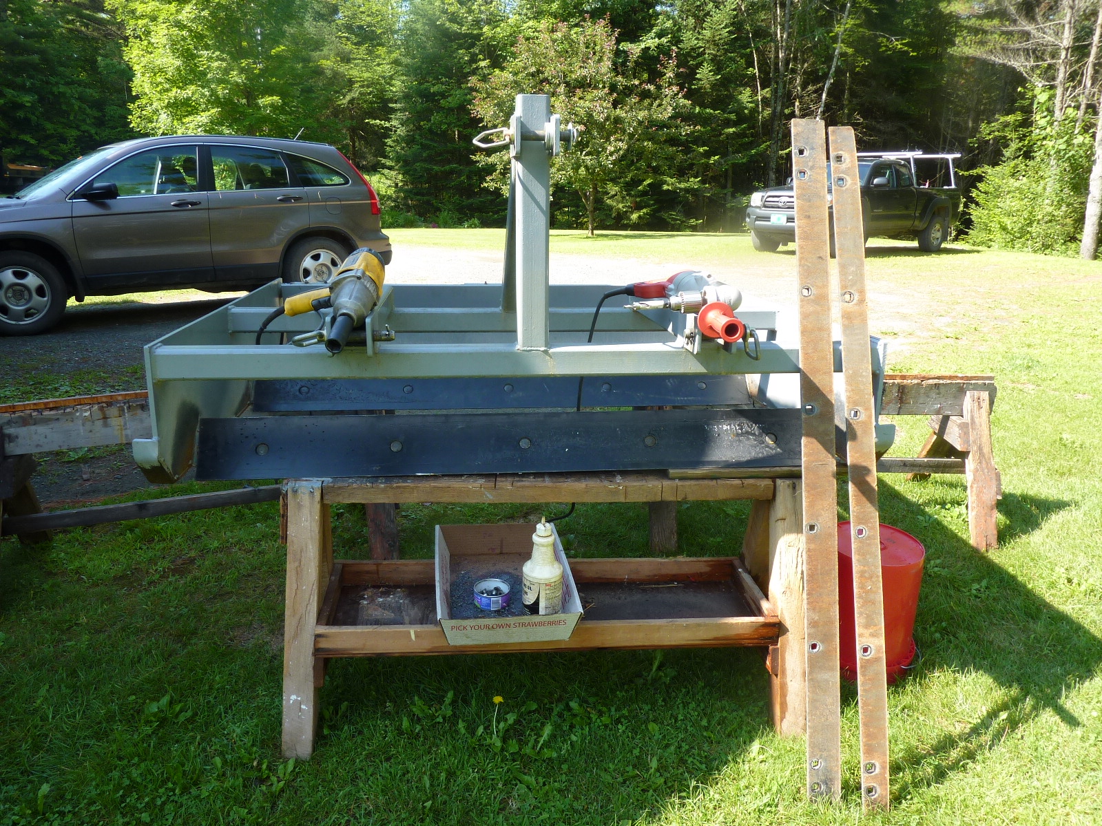

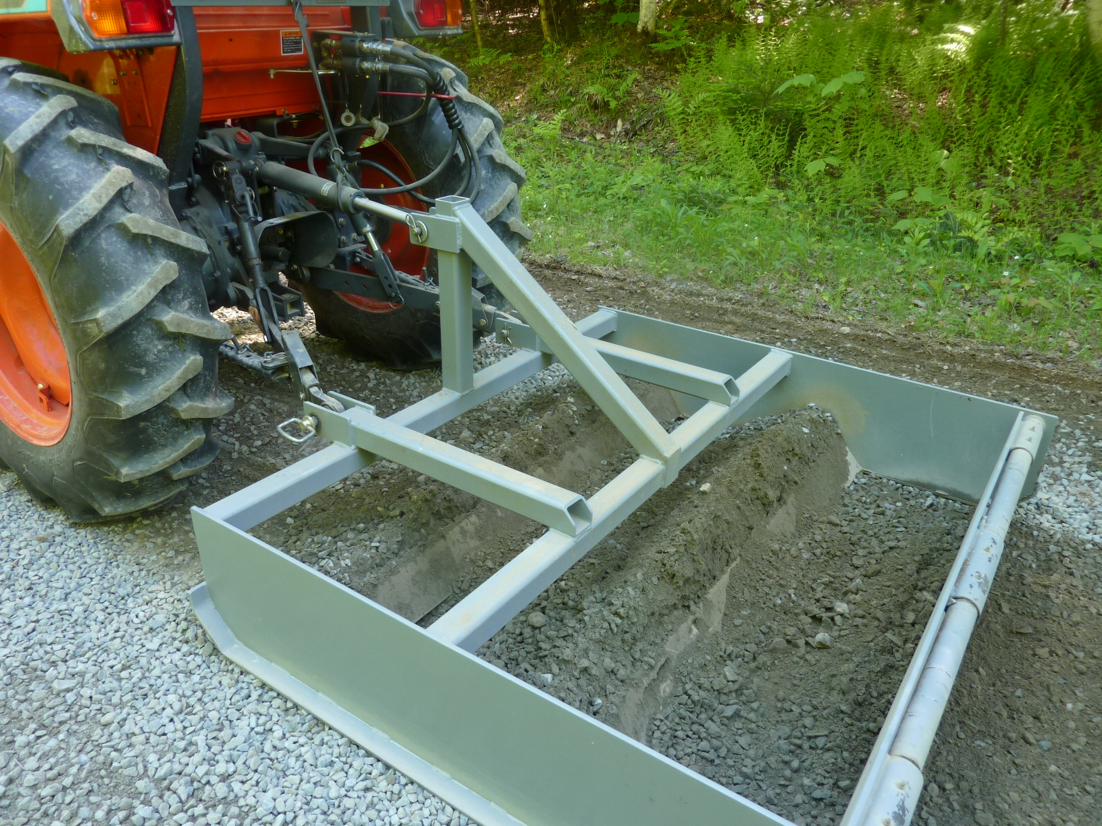

Here are pictures of two that I have made. Notice the smaller blade has box tubing skids which don't hold the rocks to drop on the grass. The next large lpgs I build will use much taller rectangular tubing for more clearance as Gordon mentions causing clogging. Both of these work well in clean dirt but I do have to watch for grass build up in field work. My blades are straight and set flush with the skids.
